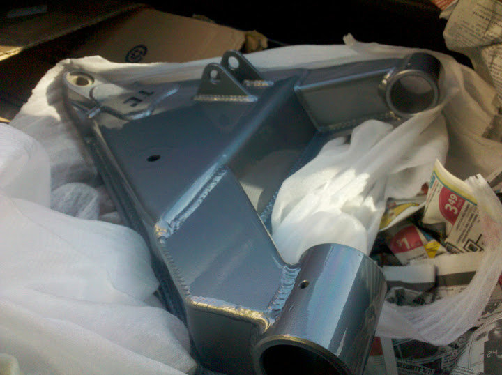

ENGAGE offroad lower arm broke i need your guys opinion on this

    Seems like really thin walled tubing. It's obviously a major stress point on our trucks and everyone making aftermatket products needs to address it in some way. If not, why buy aftermatket if they're just gonna break the same as stock?

    engage's lca material looks the same as the stock lowers?? those tc lowers are at least 2-3 times as thick...

    Geez, you're right. I would never, ever use such thin-walled tubing for the pivots. But that's me.
    Could be a bad weld due to a lack of penetration. Could be that they didn't use DOM tubing. Could actually be DOM, just not thick enough. Could have been excessive wear and tear. COuld be a lot of things. I wonder if Engage will comment on this.
    For others who have the same LCA's, I would look into reinforcing those sections. Like all the way around the tubing, not just a diamond gusset over the joint.

    If they going to be using thinner tubing I would put a piece that wraps around from the top plate around the back of the tubing to the bottom, this should be plenty of strength.
    Also, weld the inside of the lower mounts on the frame (Since they're only welded on the outside).
