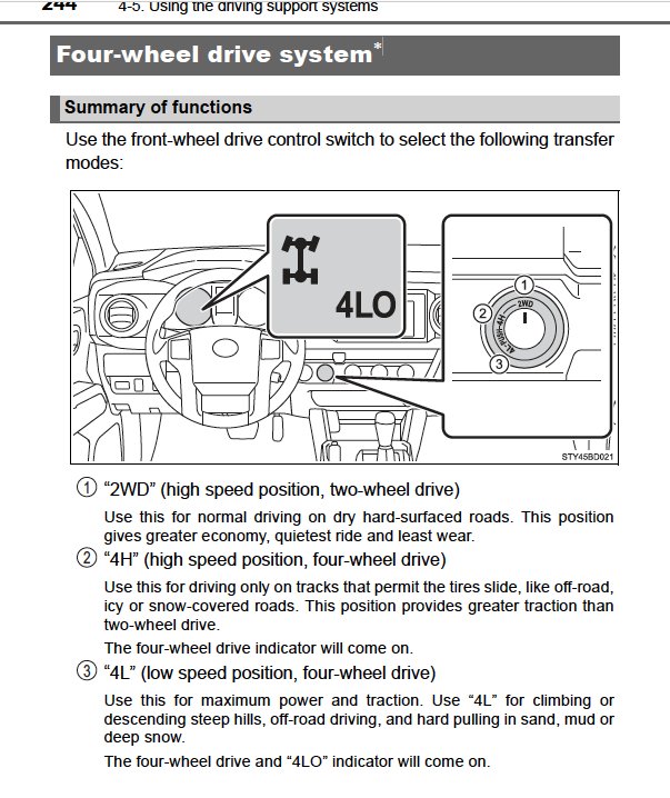

    So the TOYOTA engineers got it wrong, or we got the wrong OM! Huh!
