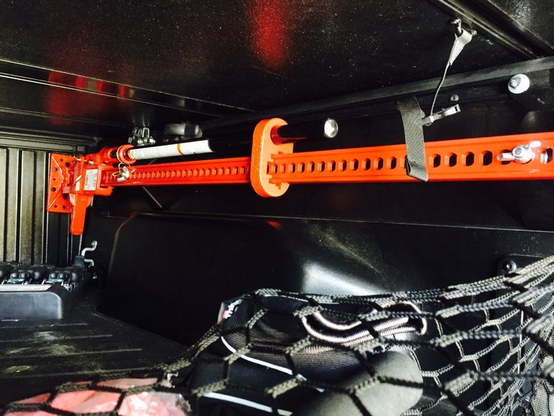

    image.jpg Thanks guys lol little elbow grease solved the problem :thumbsup:

    Hopefully I won't have to use it too often but it's good to know I can change a tire if I need to.
