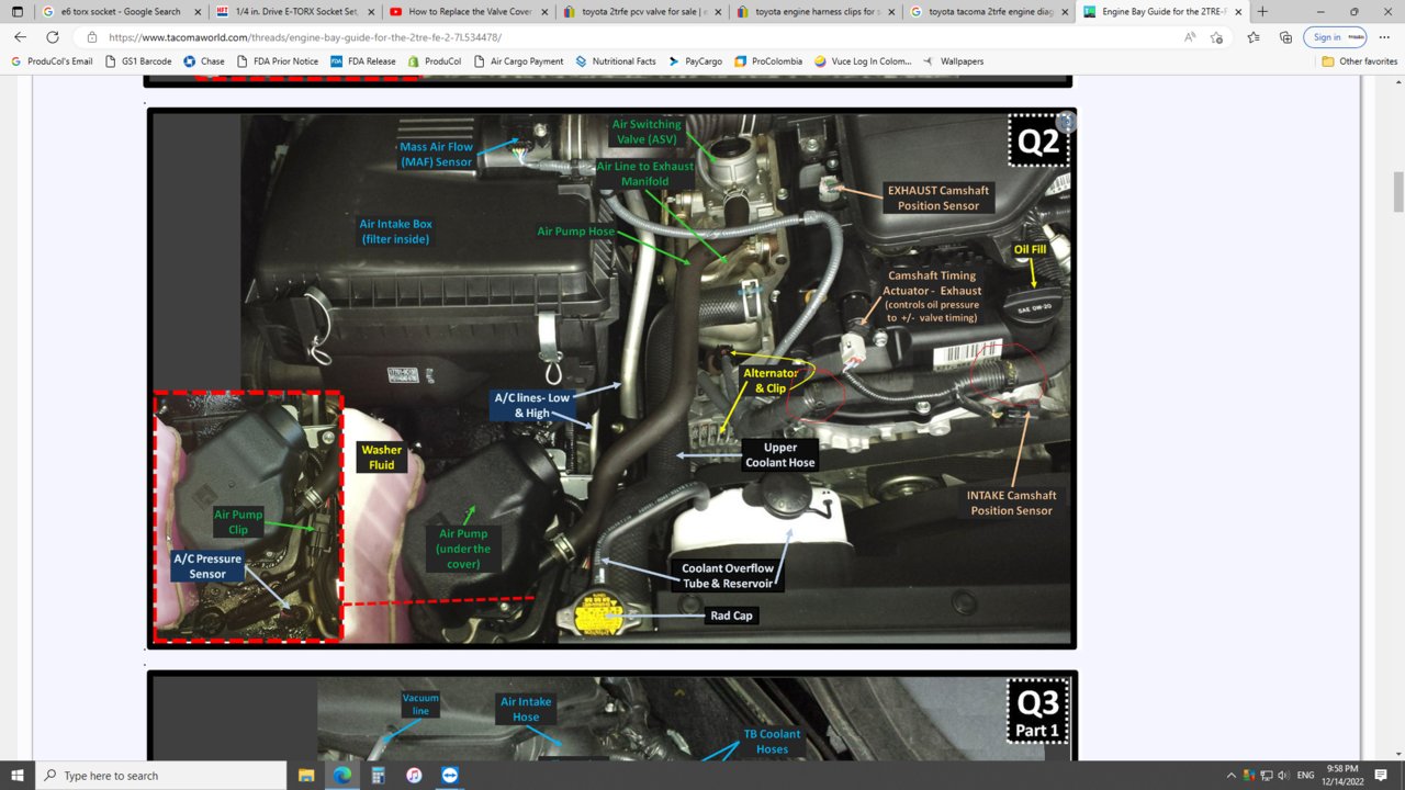

    good evening my fellow taco owners. i am looking for the part number for the clips that hold the engine harness all around the valve cover. Untitled.jpg
    i have circle the part on red... if anyone could help me, id appreciate it

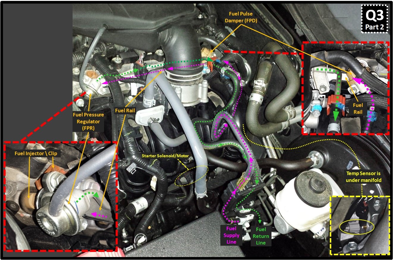

    Excellent diagram. I must, however, agree with the gentleman who said the fuel lines are marked in reverse. There's no way a high pressure line would be secured with simple hose clamps.

    There is no part number for those, they come with the harness as one unit.
    There are most likely some generic fastening clips available online or at auto parts stores that can be substituted tho..or good old one zip ties

    The fuel direction pic has been corrected. Thanks for mentioning.

    Hey OP!
    Did you ever find any replacement clips for your harness? I too have some broken ones after some recent work in the engine bay. IDK what is is about trying to find clips / wiring connectors, but it boggles my mind how difficult I find it..

    Clips for the harness? In an older post, I was looking for clips that went into the frame, but I havent' needed anything for the harness.
