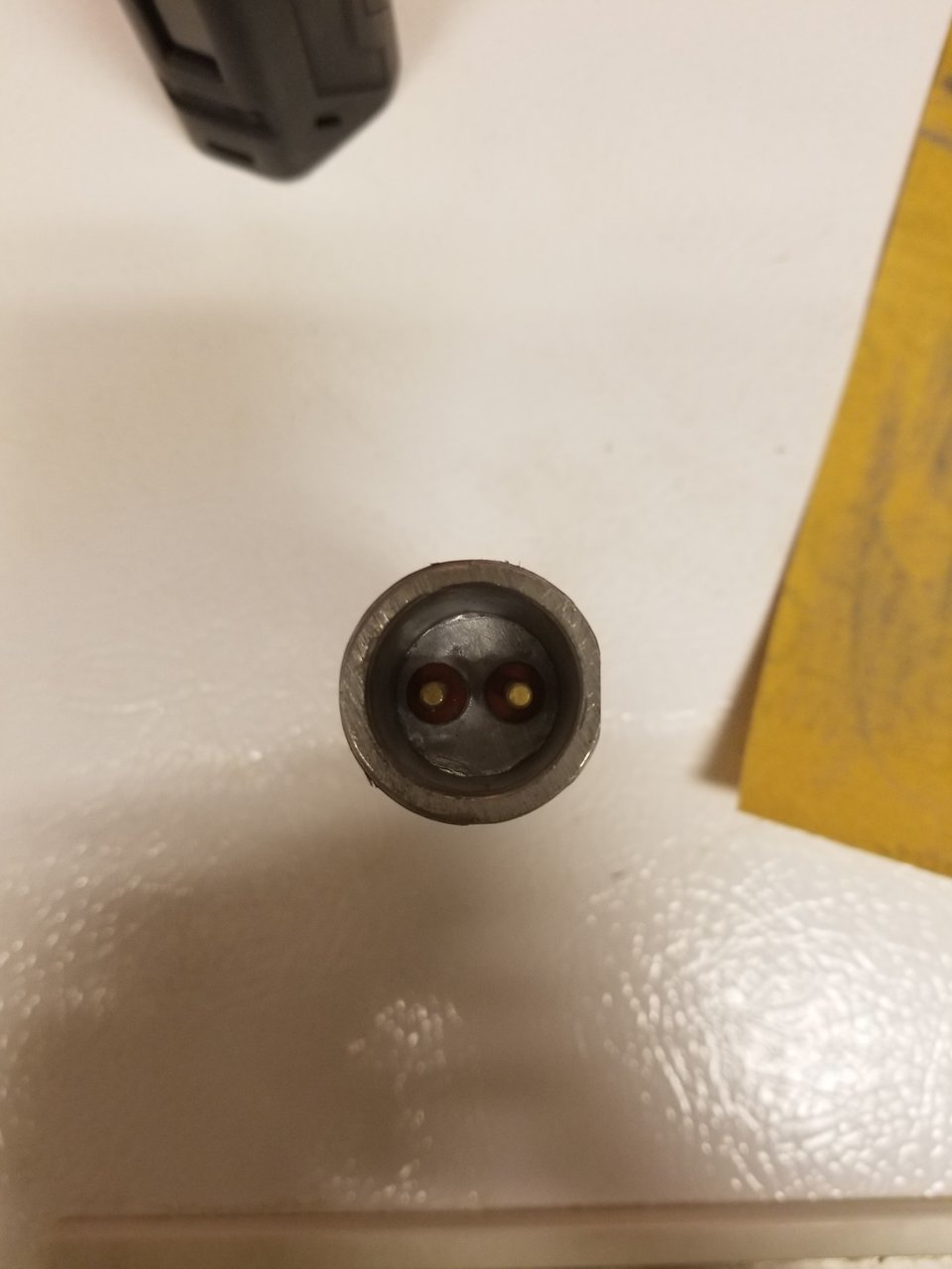

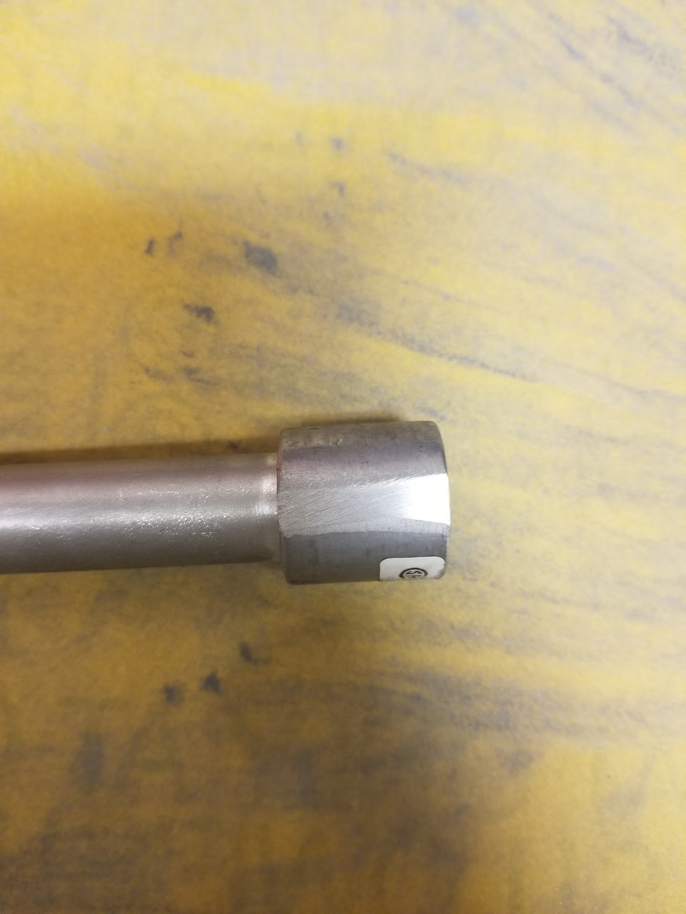

    So, I figured it out. I sanded one side of the wide part of the heater and it slides right in.
