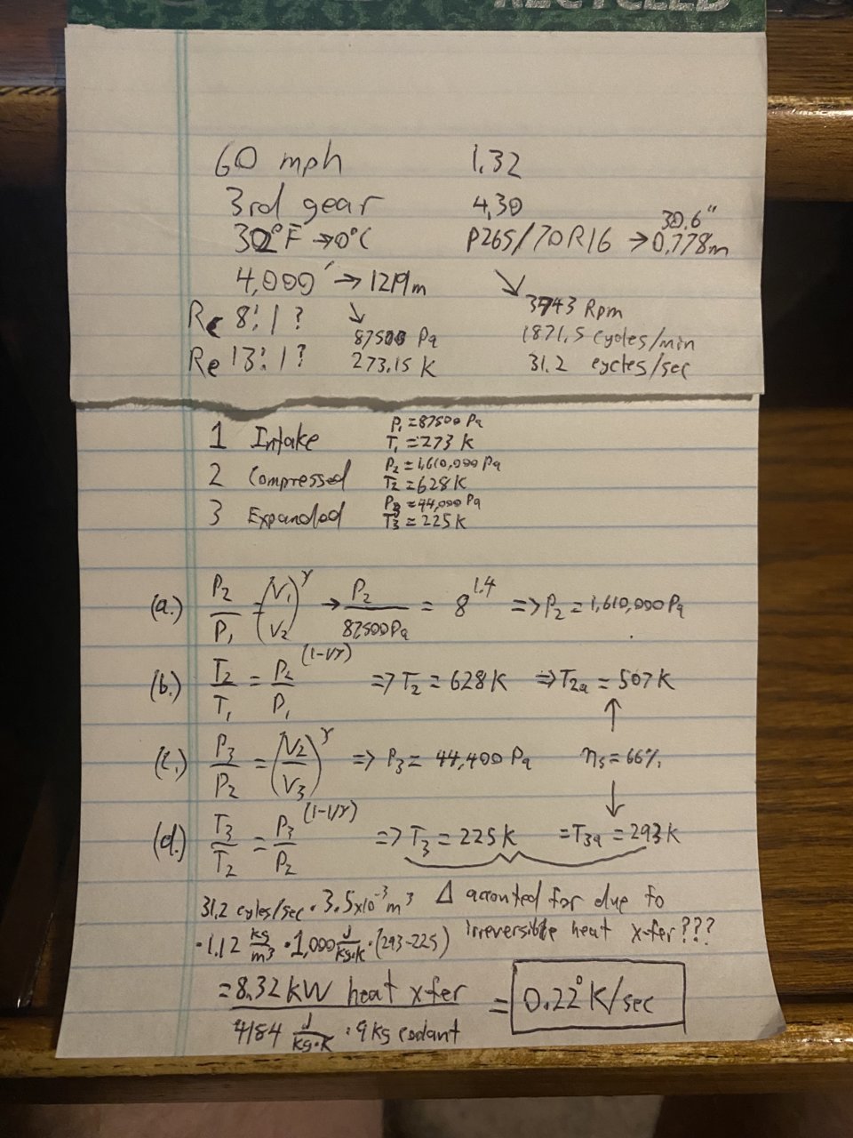

  15. Mar 16, 2023 at 10:53 PM
    #35
    arthur106
    arthur106 Well-Known Member
    Dec 22, 2020
    #350416
    294
    Jacob
    Houston
    Black '10 SR5 4WD 5MT
    Ok, so I nerded the shit out of this one. I can't claim anything I say here is true or accurate, I'm wrong more often than right, but I thought I'd do this for fun anyway. I wanted to a few days ago but was busy with a business trip and now I'm sitting at home and can't sleep so...
    I just ran back of the envelope calcs on three thermodynamic states of air: 1-ambient, 2-compressed, 3-expanded. I missed the OP's second post giving specific conditions such as elevation, temp, and speed, so I made assumptions. Also, I couldn't quickly find the compression/expansion ratio's of the Tacoma's Atkinson cycle, so I just took the 8:1 and 13:1 from the Prius. Again, it's back of the envelope stuff here.. I came to the conclusion that dropping coolant temperature of somewhere in the range of 0.2 degrees C per second is REASONABLE. It's probably less, but I'd venture to say this guess is in the ballpark. A 2,500' descent with a 7% grade at 40mph takes 10 minutes, so this equates to 120C temperature drop. Again, the real value is almost certainly LESS than this. I did not account for the heat transfer to the engine block or the oil. Why? Because I'm lazy and it's late. Assuming heat is transferred through the oil cooler to maintain coolant/oil temp equilibrium, you can reduce this by about 30%. The real question is how much heat is transferred to the engine block, as this is a HUGE heat sink? There's also other sources of cooling that effect the temp of the motor block, so I'm just ignoring this altogether. If you don't like my answer ... I dont know, divide it by 5 or something.. the you get a temp drop of 24C (43F) over 10 minutes. I can't pin with certainty how much the Atkinson cycle cools the engine during engine braking, if it even does, I'm just trying to show it's plausible anyways.
    My assumption was that the isentropic efficiencies of compression and expansion were both 66%; this is on par with typical reciprocating compressor efficiencies as per Google. I then compared the difference in final temperatures of the air (isentropic vs assumed actual cases) and ASSUMED that the loss of efficiency was due ENTIRELY due to irreversible heat transfer between the air and cylinder walls. This is how I came up with 8.32 kW of heat transfer. The 0.2 K/s was based the heat capacity of water and approximately 9kg of coolant. Again, I'm ignoring heat xfer to the oil and block itself, this assumption is an upper bound.
    EDIT: I realize there's a bit of an energy imbalance here. Some of you may point out that gravitational potential energy of the truck is being turned into heat in the engine instead of the brakes, so how can the engine be getting colder? Well... for one, I'm not sure that's the case, I'm just saying its plausible... I think. Also, most of engine braking does not happen due to compression, it is a result of pumping losses as the engine desperate tries to suck air past the closed throttle body. A lot of that heat gets expelled through the exhaust.
    EDIT 2: This was fun, but I'd place my bets on your thermostat!
    joba27n likes this.

    I didn't fully study your analysis, but as I said previously, I think a better approach to the problem is to use energy conservation to estimate the heat generation required to maintain a terminal velocity. That way we can ignore the complexities of thermodynamics and other forms of friction in the engine. Here's a napkin estimate using that approach.
    Givens:
    terminal velocity = 60 mph ~= 27 m/s
    vehicle mass = 4500 lb ~= 2000 kg
    incline = 5%
    The force of gravity on the truck is:
    F = mass * acceleration-of-gravity * incline = 2000 kg * 9.8 m/s^2 * 0.05 = 980 N
    Countering this force requires a power of:
    P = force * velocity = 980 N * 27 m/s = 26,460 W ~= 26 kW
    This gives us an upper bound of the amount of heat generation required to maintain a speed of 60 mph down a 5% incline.
    To get a better estimate we could take into account aerodynamic and rolling resistance. I did an estimate for aerodynamic drag force and came up with 190 N. I'll summarize it here.
    Givens:
    coefficient of drag = 0.4
    air density = 1.3 kg / m^3
    drag area = 1 m^2
    F = 0.5 * air-density * coefficient-of-drag * drag-area * velocity^2 = 0.5 * 1.3 kg/m^3 * 0.4 * 1 m^2 * (27 m/s) ^ 2 = 190 N
    Rolling resistance is likely too small to worry about in this napkin estimate, so the adjusted power is:
    P = force * velocity = (980 N - 190 N) * 27 m/s = 21,330 W ~= 21 kW
    This number is much bigger than yours and I'm not sure why.
    Is 21 kW enough to maintain constant engine water temp at 60 mph and 30F? I have no idea. This has been a purely academic exercise.
    CAVEAT: I blew through pretty fast and there are likely mistakes.
    BTW, I don't see how the Atkinson Cycle has any effect on the answer because 1) we are assuming no fuel is being burned and 2) it's not a given that the Atkinson Cycle mode is enabled during engine braking.

    @arthur106, I re-read your post and realized I completely misunderstood you. I thought you are trying to estimate the heating effects of engine braking using thermodynamics, but I now realize you are trying to estimate the COOLING effects. I had the wrong assumption when I started to read your post. Sorry, for the misread.
    That said, I think you are ignoring the heating effects of engine braking. The truck is losing gravitational potential energy but kinetic energy remains constant (otherwise it would continue to accelerate down the incline), thus the truck is losing total energy. That energy loss likely comes in 3 major forms, aerodynamic losses, rolling resistance losses, and engine braking losses. All of these produce waste heat. My calculations suggest that engine braking losses are the biggest of the three.
