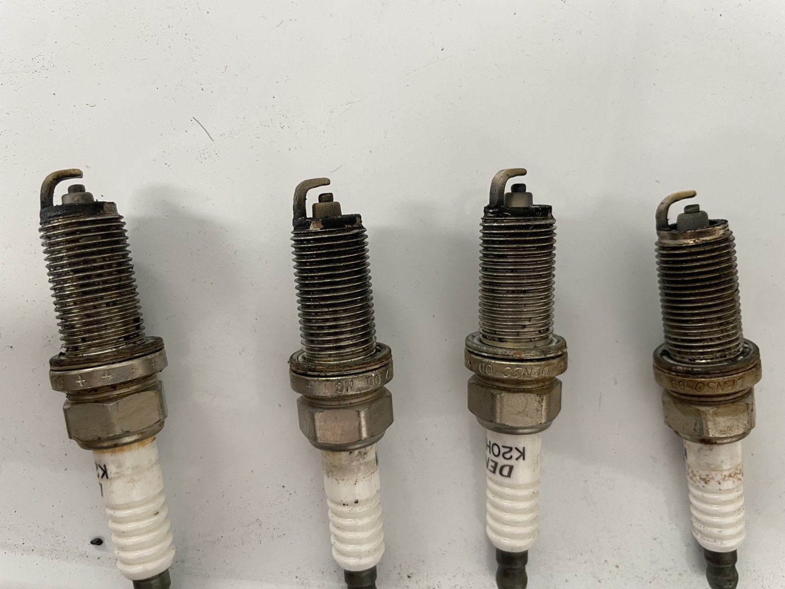

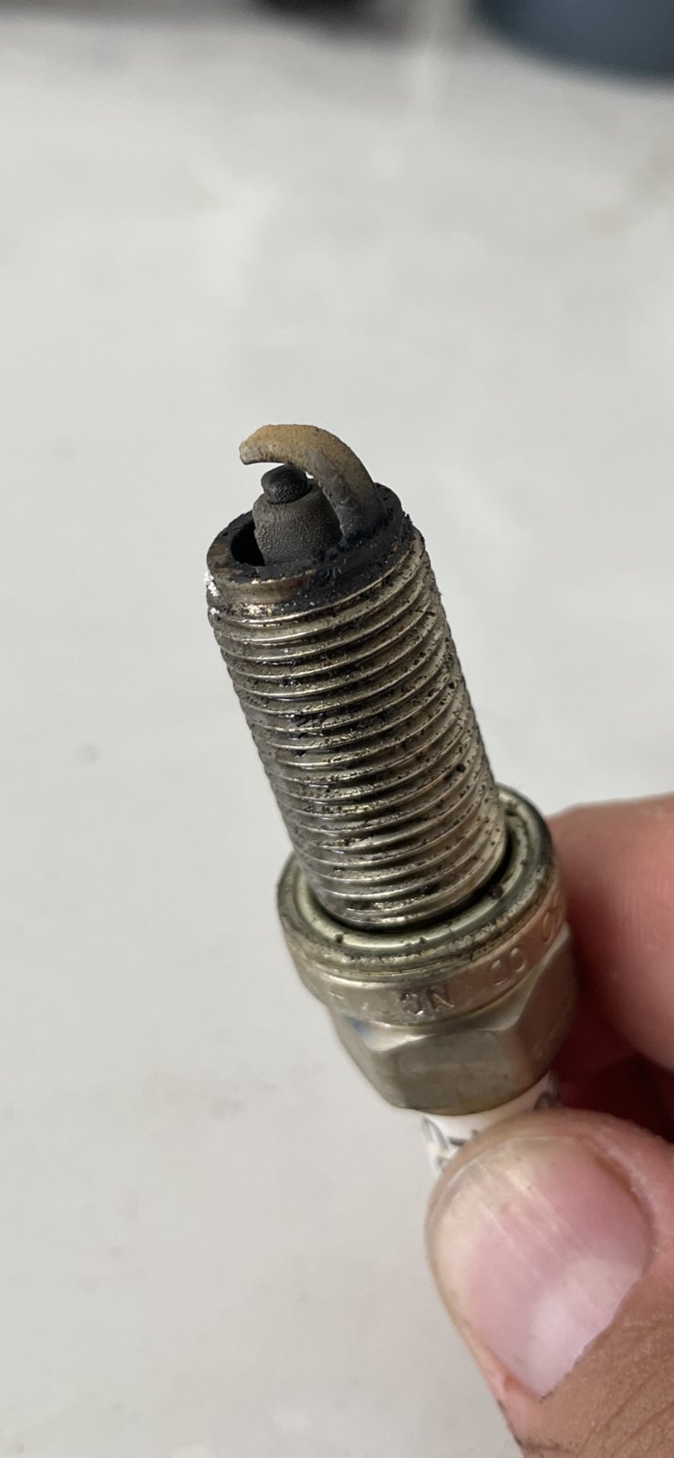

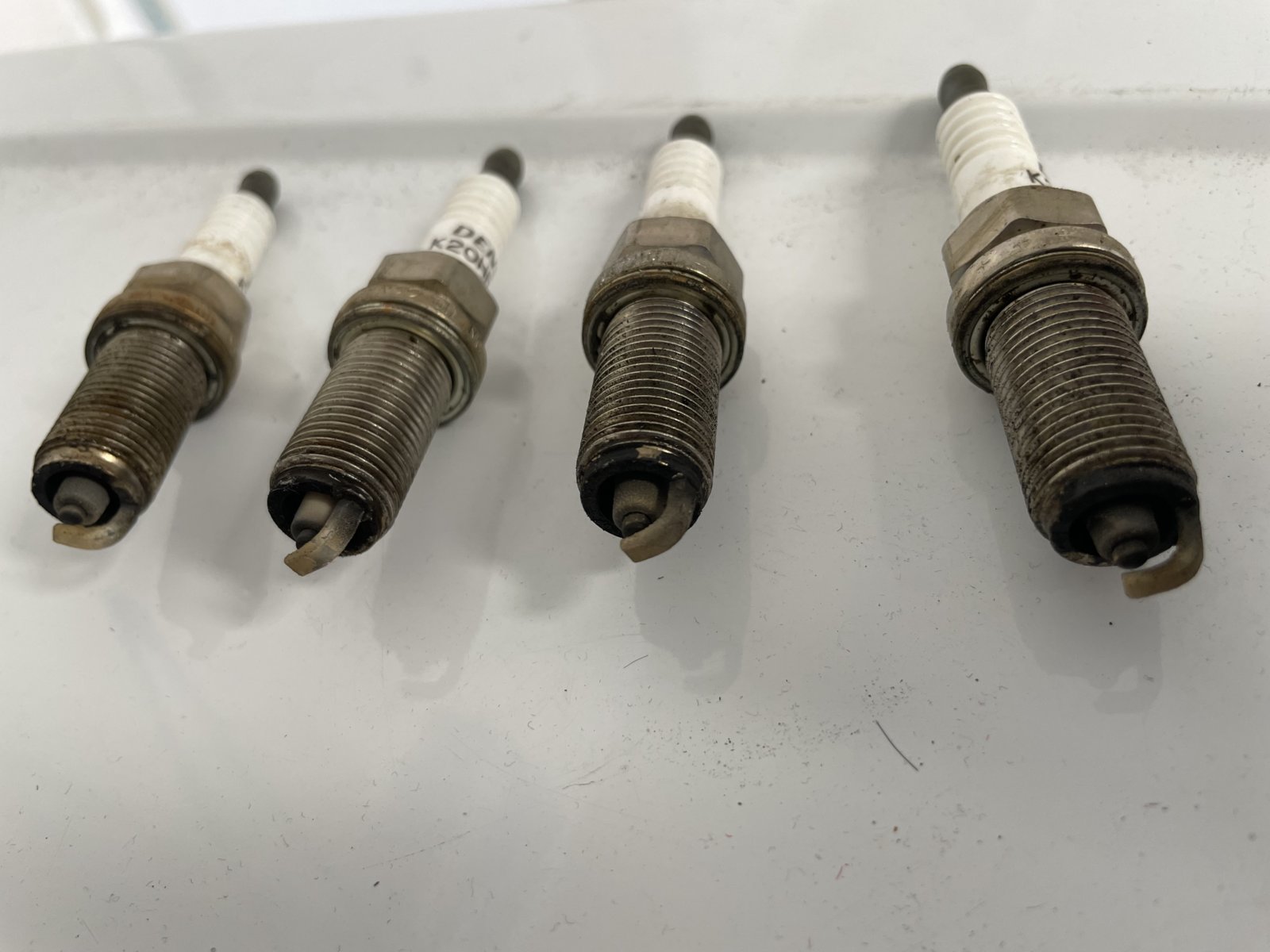

    In your pics I notice:
    - Moderate-to-heavy fouling, particularly noticeable on the ceramic insulators, which are supposed to be whitish & pretty clean. Probably oil burning.

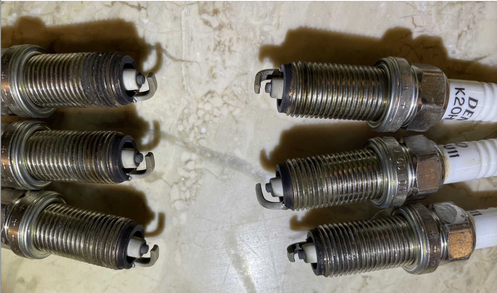

    For comparison, here were plugs with about 60K miles on them from my 2014 4.0L V6 Tacoma, which has never burned any oil between 3.5K-5K oil changes:

    Looks like some oil deposits on them but I've definitely seen worse.

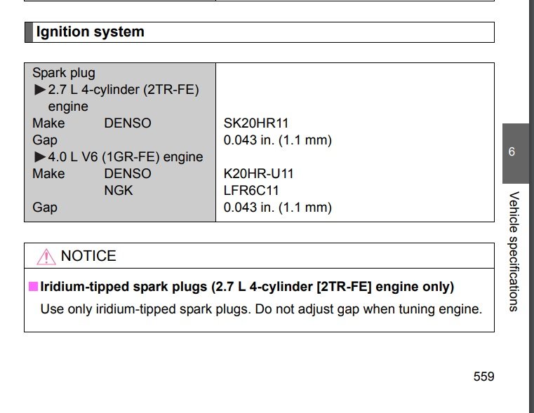

    By the way those aren't the correct plugs for the 2.7L, those are for the 4.0L.
    The 2.7L takes SK20HR11 plugs.

    Although Toyota specs iridium, if he went to Denso's site and drilled down for a 2006 Tacoma 2.7L, it will give back the 3381 / K20HR11 as an appropriate plug from their "resistor plug with U-Groove design"
    It happens when looking up Prius plugs on Denso's site directly too (I don't remember which "regular" plug comes up) even though MANY people report problems when they try to use "standard" style plugs (usually to save money). Toyota also specs iridium for the Prius as well (because the change interval is 100,000 miles. 100,000 miles is an insane interval to me, because even if the plug is still good, there is a higher likelihood of the plug ending up seized to the head.
