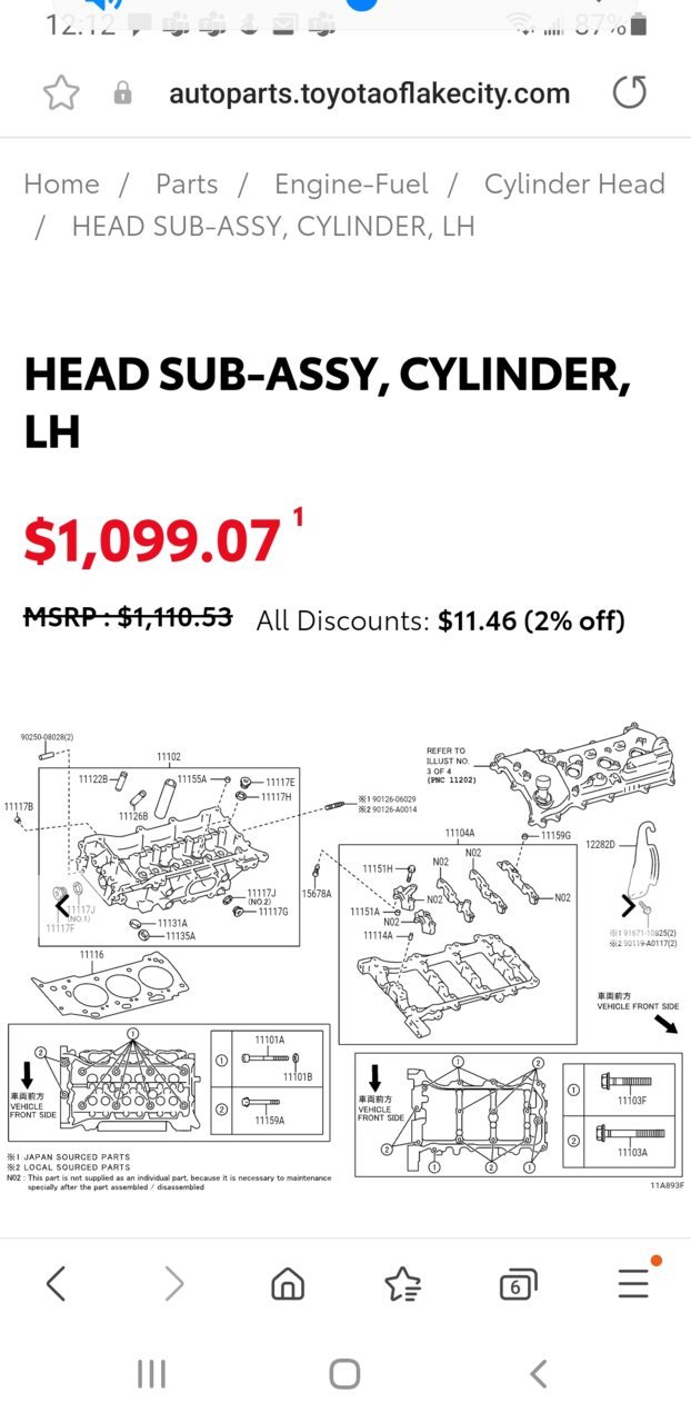

    Ask 3rd gen prius owners..We had to replace head gasket.
    I would not personally pay 10K . The job does not cost that much. All you need is a place, time, Costco, HF tools and be mechanically inclined.
    Parts and head service will be under 1K
    Or you can by a new head and valves around 1300-1400 + cost of valve installation.

    From my local dealer with local pickup before taxes. Valves are around $20/pc.
    I was in the same shoes with 2zr-fe head gasket replacement. Could not stomach 5k+ for the labor. Total job cost me $600 (including head service) and a few days to disassemble/reassemble.
