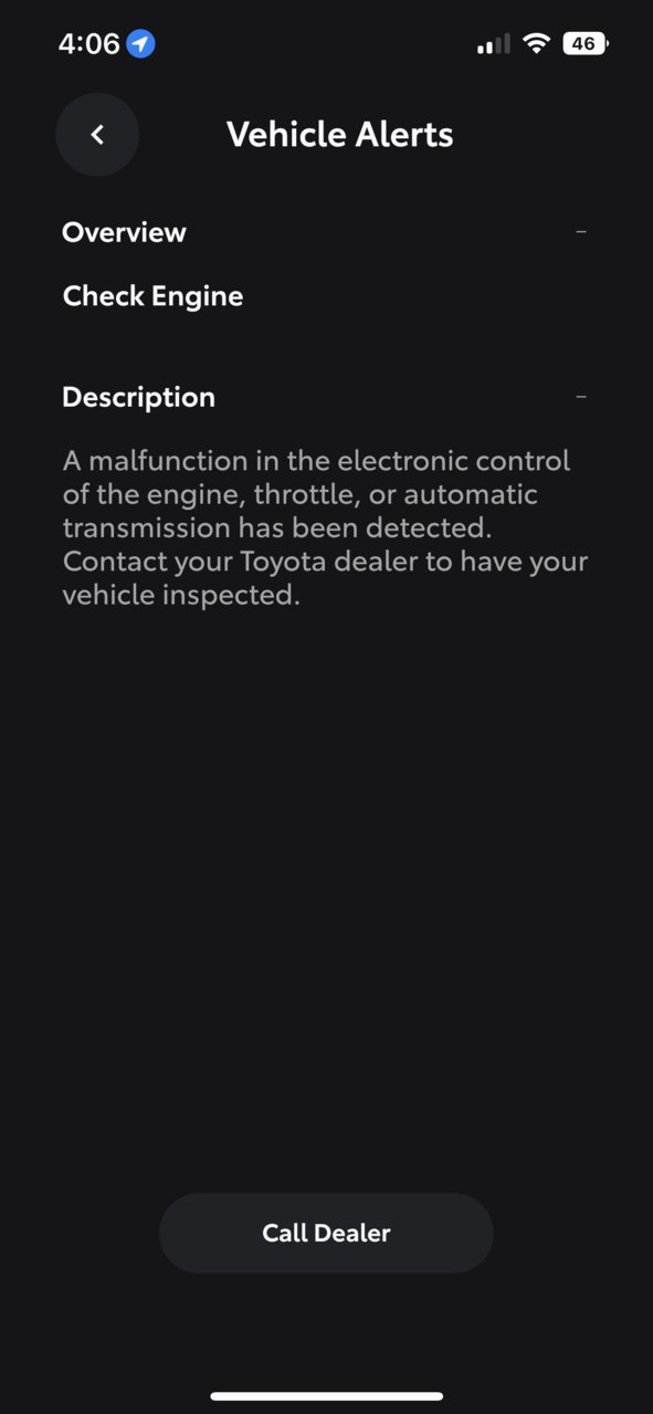

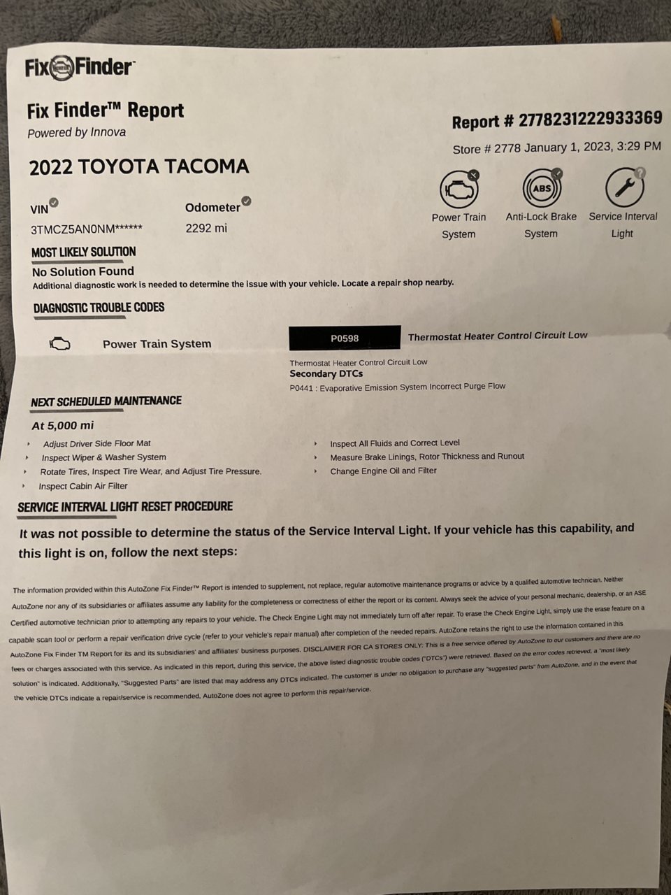

    Hey guys I just bought a 2022 trd off road. I purchased a few things already such as a new grille and raptor lights. I just did the raptor lights and after I threw a check engine light went and got it checked can anyone tell me what this means. I’m about to head back to fort carson tomorrow and I don’t wanna drive all the way there if something major is going on. And also my cruise control isn’t working since I did it.

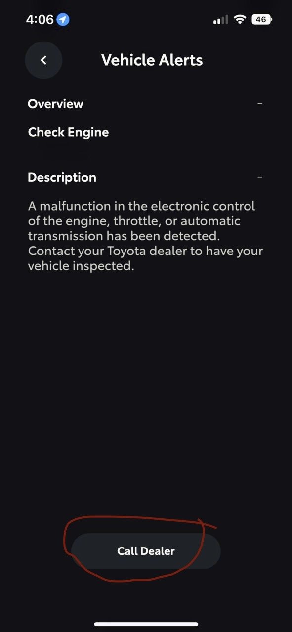

    ALSO THE APP SAYS THIS

    I misread, its a thermostat electrical failure, they are common, as long as the truck's coolant level is good and temp is in the good range its safe to drive.
    We've changed a few. Nothing to worry about. Just watch temps from time to time.
    Don't clear the code.
