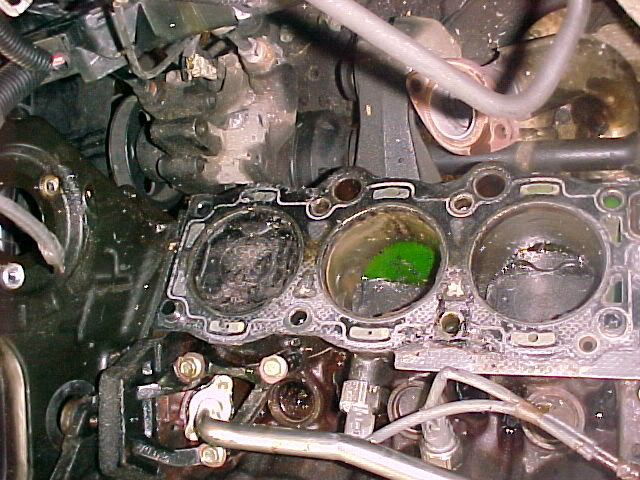

    The knock sensors are under the intake. They are the two sensors at the bottom of this pic
