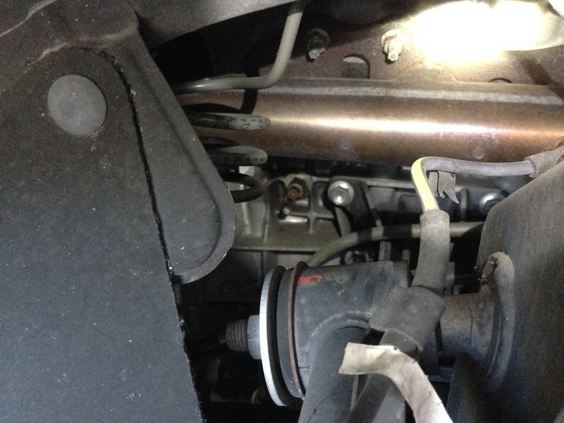

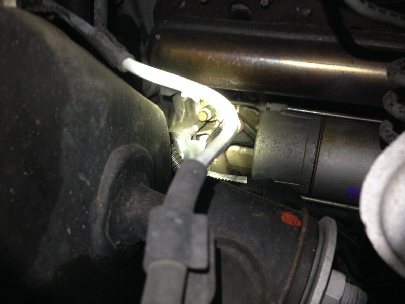

    the drain location on the driver side is right below the header; it is closer to the left (forward most exhaust outlet )
    the passenger side is easier to access; remove the black drape held by clips and it is a straight shot
    theres a 10 mm hex nut and below the nut theres a spout where you can fit 7/16" clear vinyl tubing so its not a big mess to drain the coolant

    Drivers Side
    720006fd-512c-4ce2-93a1-5c717f964653_zps_8c267f77ba78e70ee414547e69c67e46bc58e304.jpg
    Passenger Side
    1dbc2928-d698-4649-bddd-4e3716d7eb51_zps_5aa81924b609a791d98b46bb7bc18a2da3b2d284.jpg

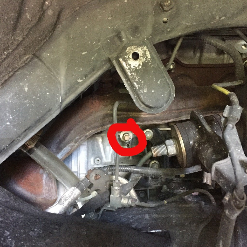

    I access both through the wheel well without removing anything (non-lifted truck). The drivers side requires a socket universal joint. I use two 6" 3/8" extensions but as mentioned a longer extension would be better.
    driver's side left pic, passenger side right pic

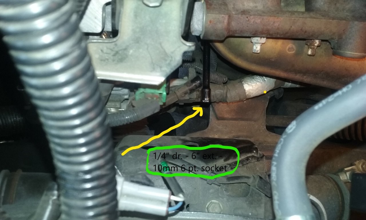

    The 4.0L V6 drivers side engine coolant drain plug is also accessible from the top. Photo below of how this looks + pic of a bracket that needs to come off in order to help getting to the drivers side drain plug from above w/o scratching up your arm.
    You can first reach in with your hand to connect a drain hose; then connect the 1/4" extension/socket.
