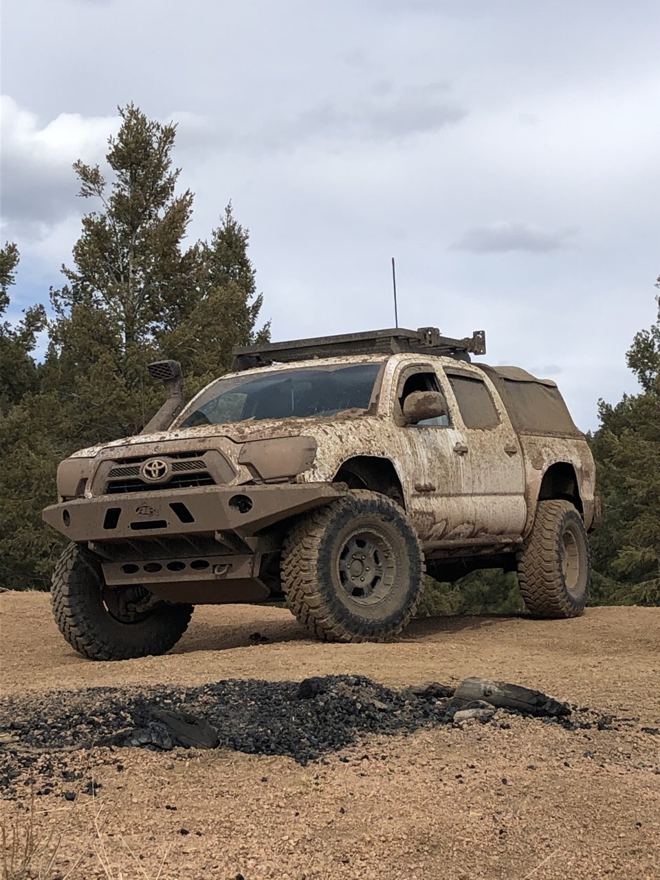

    got to this point with the build and right after the head gasket blew, motor mount and ripped the frame and fell into the frame
