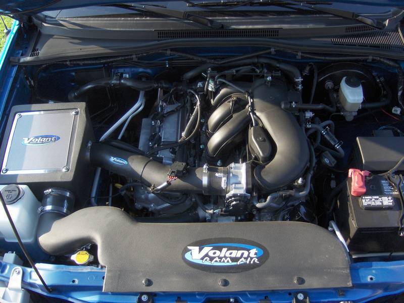

    The engine cover is there pretty much for looks other then keeping dust off of the valve cover, throttle body, and intake manifold. As for opening up the plastic insertion to enable air flow through the scoop, i would recommend not to. The body design was made for air to flow from the grill to the sides of your fenders. Wouldnt benefit from it much because our fender well is supposedly the best place that receives cold air, keeping in mind our stock intake, TRD intake, and AFE intake is enclosed and still using the fender to suck in cold air. Others say opening the scoop causes turbulence as well, not too sure on that case. If you would like to have more cold air i would recommend doing the AFE/TRD intake with the air ram mod, or just purchasing the Volant CAI.
    here are some examples. i am in the process of modding my AFE stage 2 intake with the Volant air ram, similar to the second link>
    http://s121.photobucket.com/user/34coupe/media/sept01008-3.jpg.html
    https://www.tacomaworld.com/gallery/data/500/Picture_0251.jpg
