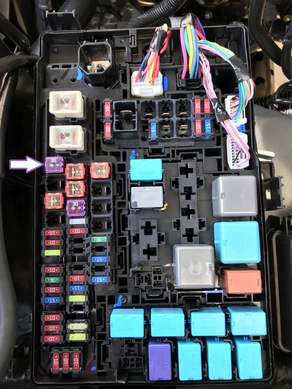

    Installing a transceiver and inadvertently caused an arc directly behind the interior fuse box, blew the 30 amp fuse. Truck cranks, no dash lights no start. Have verified all fuses and tested relays, reset control module. OBDII will not communicate with truck. Will check OBDII connector in the morning ( make sure it is getting contact) but am stumped. Any suggestions?
    Have 2018 Toy Tacoma, was installing a transceiver and inadvertently caused an arc under dash next to the interior fuse box, was grabbing power off the red 18 gauge wire behind fuse box blew 30amp fuse under hood box, checked all other fuses, checked and tested relays. Engine cranks but does not start, no dash lights. Hooked OBDII sensor and it will not communicate with vehicle. Reset control module, "no joy" Will check connector in the morning, but am stumped to what is wrong. Any suggestions?

    This be that one you burnt?
    Yes, that looks like the fuse.
