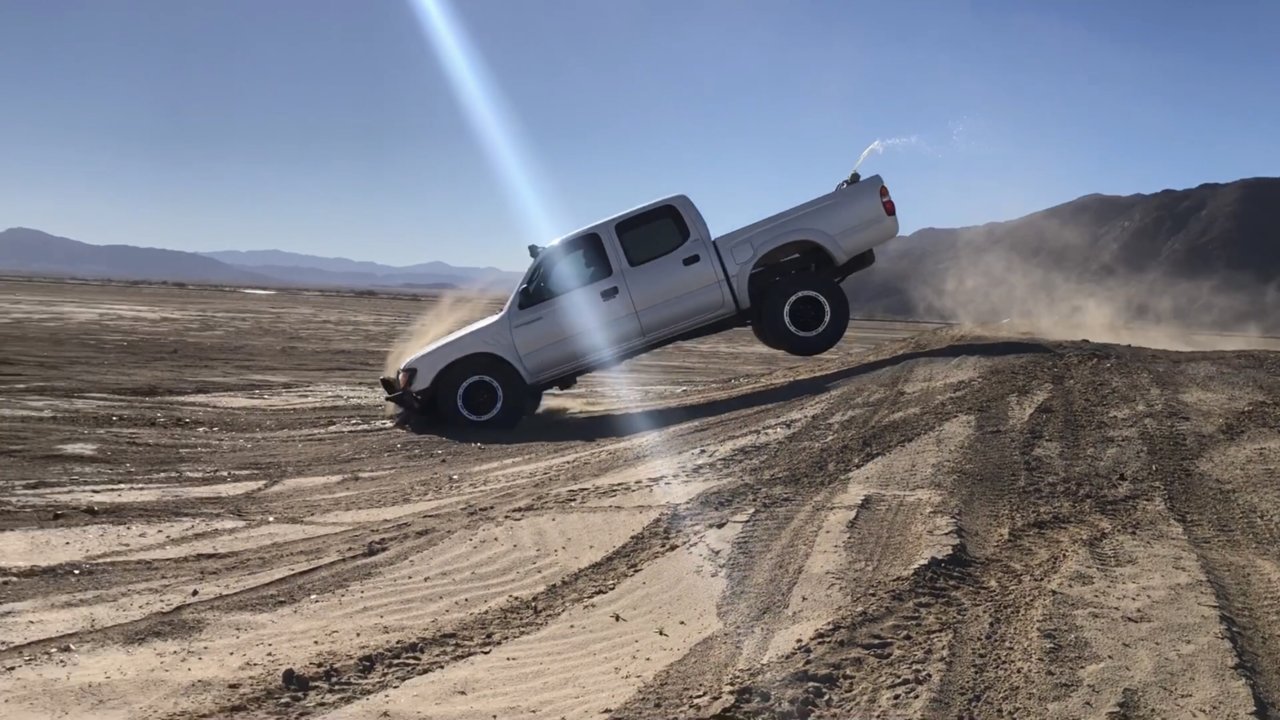

    13 months ago my transmission went out and I bought a new one that claimed to have 50k on it. Installed it and never had any issues with it. January we did a trip and I got a little carried away and essentially lawn darted my truck off a mound at plaster city. Took it all to the bumper. Broke a light off the bumper and blew my alignment to shit. Engine died at an idle shortly after when we came to a stop but otherwise the truck ran fine the rest of the day aside from my rubbing issue from the new “adjustment” to the alignment.
    Pic of said lawn dart for reference

    I remember you from that thread a few months (or more) back asking about your alignment after doing ^ that to your truck
    Never noticed the winkle in the front fender until now :eek:

    Any dents in the pans or leaks?
    How fast were you going and what gear was the trans in when the rear end set down?

    No dents. No leaks.
    Looks like 2nd gear

    Was overdrive locked out? You lifted really early so it could have up shifted, and the last second throttle romp didn't look like it picked the nose up at all.
    Your symptoms sound like you blew an O-ring on one of your Overdrive solenoids... which is a super unlikely thing to happen, it also won't throw a code, I've only seen it happen on a massive over-spin at glamis when the diff somehow didn't break... and after watching the vid, I would doubt that to be the case.
    It could also be a sticky Solenoid... but the ECU will eventually throw a code for this.

    Question, maybe to point the OP in a different direction to look at other things;
    your wheels spun freely while in the air, even if for a moment, and the engine wasn't under any real load. You land, and a shock went throughout the entire drive line since the wheels landed and were met with real 'resistance'.
    The transmission shifting into overdrive is a theory, but a good one.
    What else would give out and break first in this kind of situation?
    While you have it up on a lift, check out the drive shaft, joints, etc. for anything else that may have been damaged.

    You made the General Lee look like a Ford Escort. :bowdown: Like to see a Dodge try that.. lol well done
