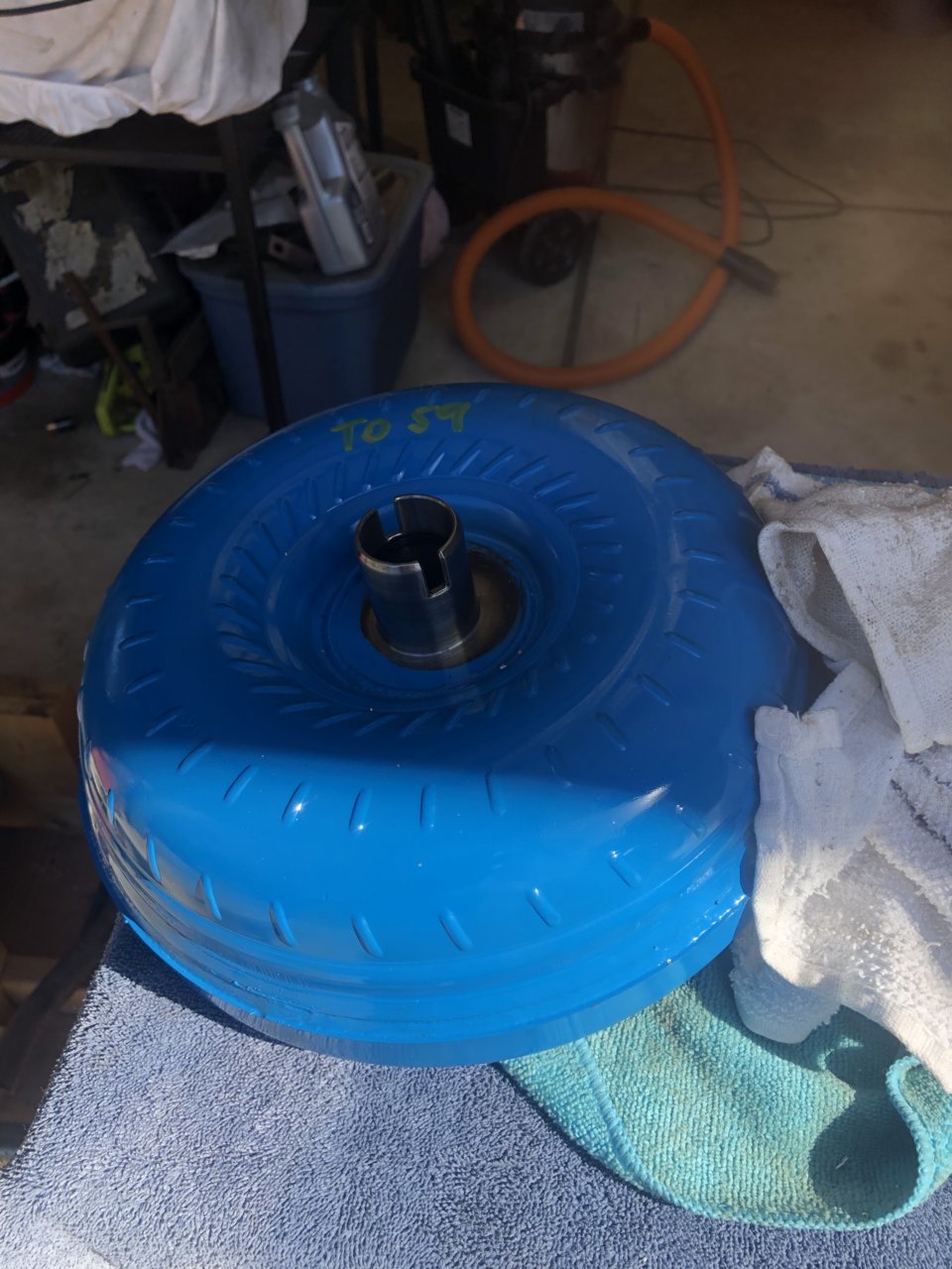

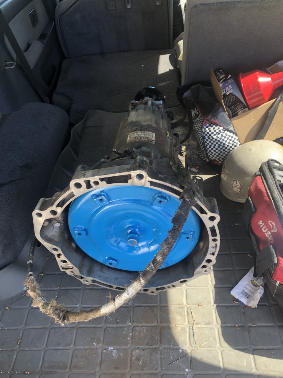

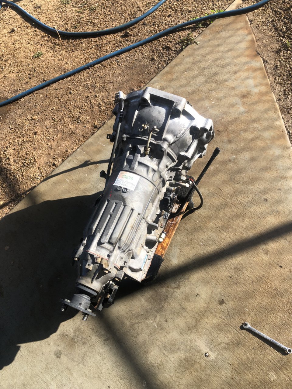

    Picked up the transmission today after work.
    New solenoids and torque converter.
    9ED48E85-6581-431A-9DA7-BE6C54733E63.jpg C39E6DCF-CAD6-43BB-B1F6-27DF64872824.jpg 03E604A8-99A0-449D-ACF9-FE1DA216FDCB.jpg
    Replaced the rear main seal while trans is out.
    Power washed and ready for install tomorrow.
    Hopefully it fixes it. If not I’ll keep on the hunt. Probably mess with the battery first and go from there.

    Installed the transmission with new solenoids and a new torque converter. Still not right. Gunna check battery and fuel pressure next.
    Battery is pretty old. 7/14.
    I’ve got one that’s from 15 that I’m going to drive around with tomorrow and see if it makes a difference.

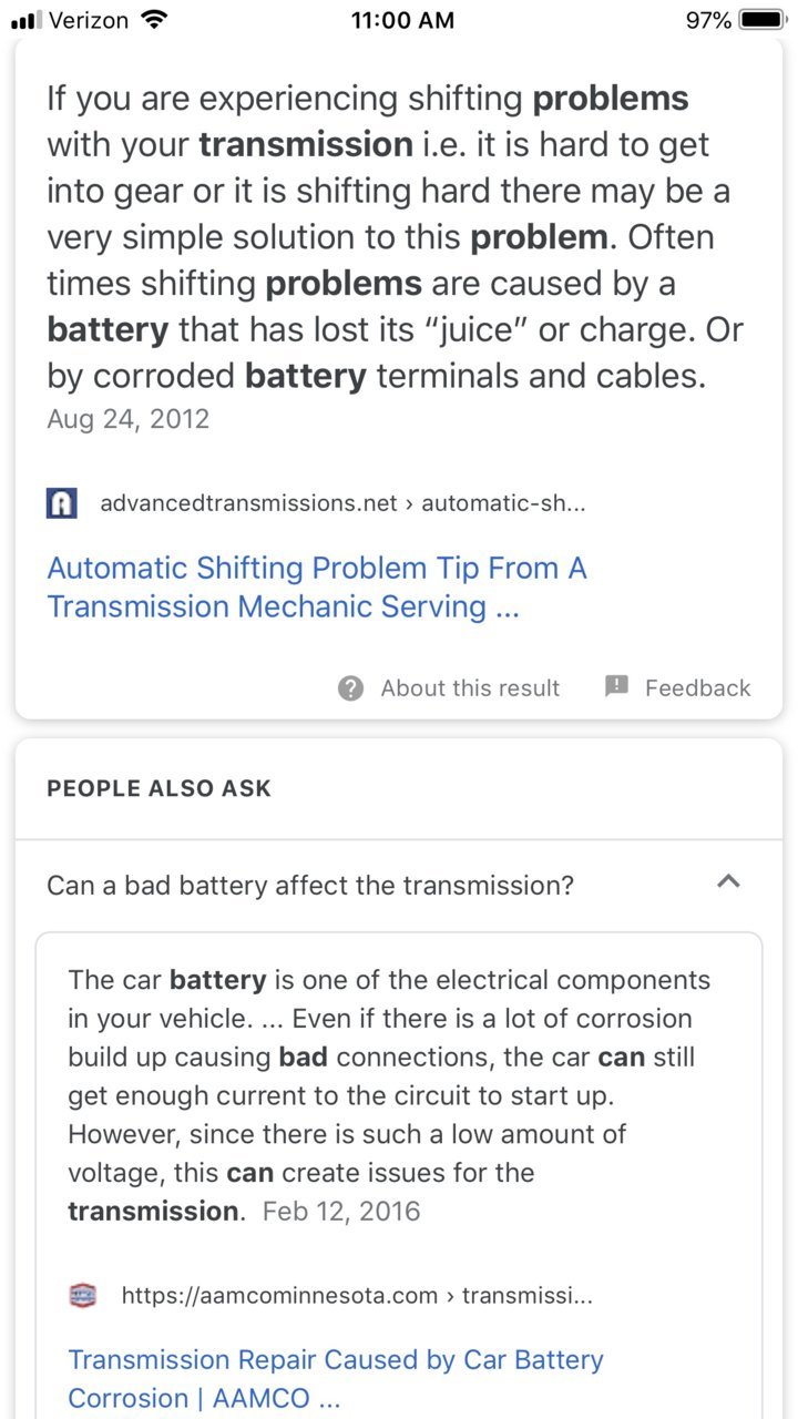

    This is where I’m going to start next. Probably drop a different “newer” battery in. (My current one is 7/14) and see if it has any effect on the shifting. Feel like it’s a long shot but it’s a inexpensive thing to try and I’m open to all ideas.

    I'm not sure i follow this- if the battery can start the engine, that means you have plenty of current and voltage, much more than any computer will ever need. Think about it- if you have 12 volts DC, and says 250 cold cranking amps (usually these numbers are higher but lets use that for a ballpark), then you are talking 3000 Watts of available power- its hard to see a scenario where a vehicle computer ever approaches that kind of draw. If the charging system is a problem that battery will lose charge and not start the truck over time. I don't see where you have that going on.
    Usually if a computer is getting low voltage you get random shit happening or it keeps rebooting, but your issue is consistent, to the point where you can predict when its going to happen. That tells me it is not supply power. "Perhaps" the computer itself is an issue, but again, the fact you see it happen at a certain time and condition means it should be traceable to a condition or state, so you need to approach from that side. Ask what is happening once the truck warms up compared to a cold condition where you don't see it, and go from there.
    Seems mechanical to me- I'd be surprised if this is electrical.

    I thought the same thing but did some digging and apparently it’s a thing.
    Again, it’s probably a long shot but it’s a possibility and a cost effective thing to check out before I look into fuel related problems that would cause the symptoms I’m experiencing.

    I had a first gen Tacoma that was misfiring randomly after it warmed up. I messed with that thing until I finally gave up and decided just to live with it. Later on, the battery died and had to be replaced. After installing a new battery, the misfire went away and stayed away the following few years until I sold it. So, the battery will cause this kind of stuff.
