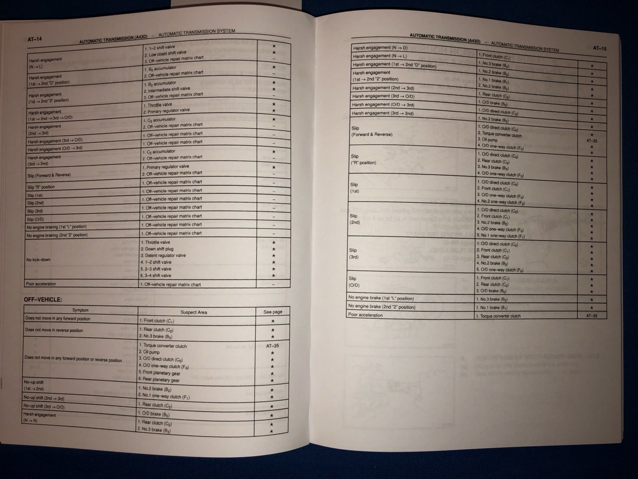

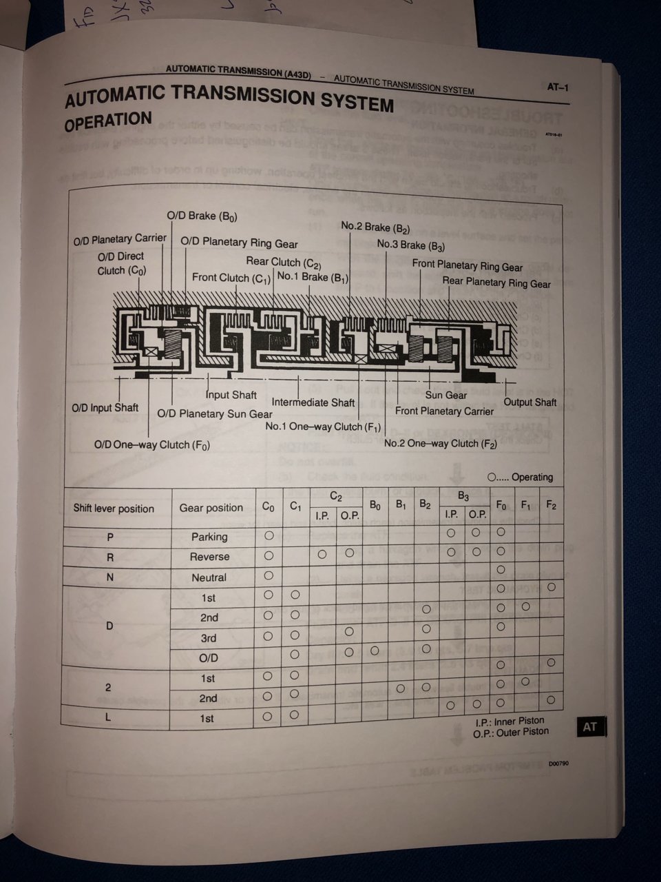

  6. Jun 28, 2019 at 9:22 PM

  7. Jun 28, 2019 at 9:23 PM
    #107
    LukeCC
    LukeCC [OP] Well-Known Member
    Mar 13, 2017
    #213229
    2,445
    Luke
    Southern California (East County)
    2002 LT DCSB
    Interesting. I’m saving this. Thanks
