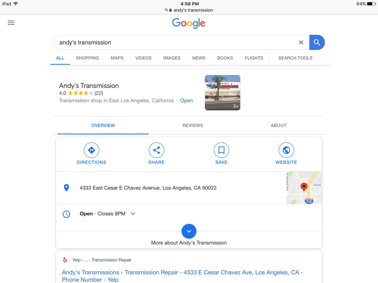

    Parkvisitor
    Parkvisitor Do you know midnight?
    May 27, 2019
    #294502
    2,353
    Juan
    So Cal
    It’s a truck
    stuff
    Go see Andy!!

    LA is a little far from me.
    I’m sorta locked in where the trucks at anyways. Thanks for the recommendation though. I appreciate that.
