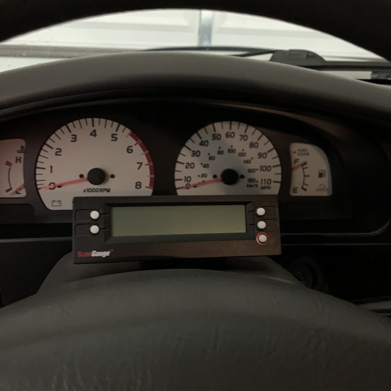

    Hey Luke, Have you tried checking your transmission temps? I used to set up EngineLink on my iPhone and bought a cheap OBD2 WiFi unit off of Amazon. Watching the trans temps helped me to troubleshoot. One difference with my truck, I did get an error code for TC lockup when my issues first started.
    Like you, I rebuilt the valve body and replaced the torque converter on my 2000 a few years ago. It has been running good since. Good Luck!

    I use a SC2 to monitor my ATF, coolant, intake temps etc. I have it continuously plugged in to give me instant real time data.

    That’s badass. I was considering just get a 52mm temp gauge but that might be a way to go. Was it a PITA to set up?
