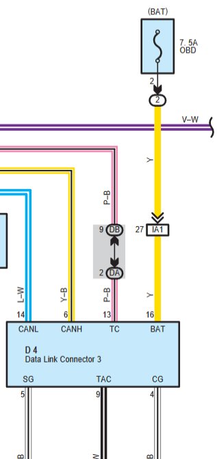

    you've got an intermittent short on that circuit, something is drawing too much current and blowing the fuse. I'd start there
    Are you driving around with something plugged into the DLC?

    The only place I see the OBD Fuse going is to the Data Link Connector for the OBD Reader power.
    I don't think that is the problem as it doesn't do anything else, unless you have something plugged into the Data Link Connector for OBD2. And if you do unplug it and replace the fuse again. If it still blows you have a shorted wire.

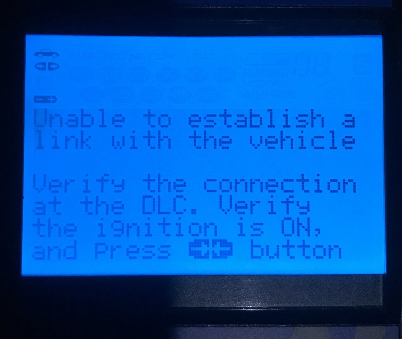

    5C5D9212-D111-47F0-91F3-82CE720A0256.jpgSo I plugged in the Scan Gauge tonight and it kept saying “connecting.......”.
    So my neighbor brought over his scanner and thisnis what it said. I tried to reaet the computer by unhooking the negative cable on the battery for a few hours, but I got the same message.
    Any ideas???
    I haven’t gotten to the fuel or spark checks yet.
  13. Mar 29, 2021 at 8:16 PM

    No communication, I would seriously check ECM powers, grounds, and 5V ref circuit.

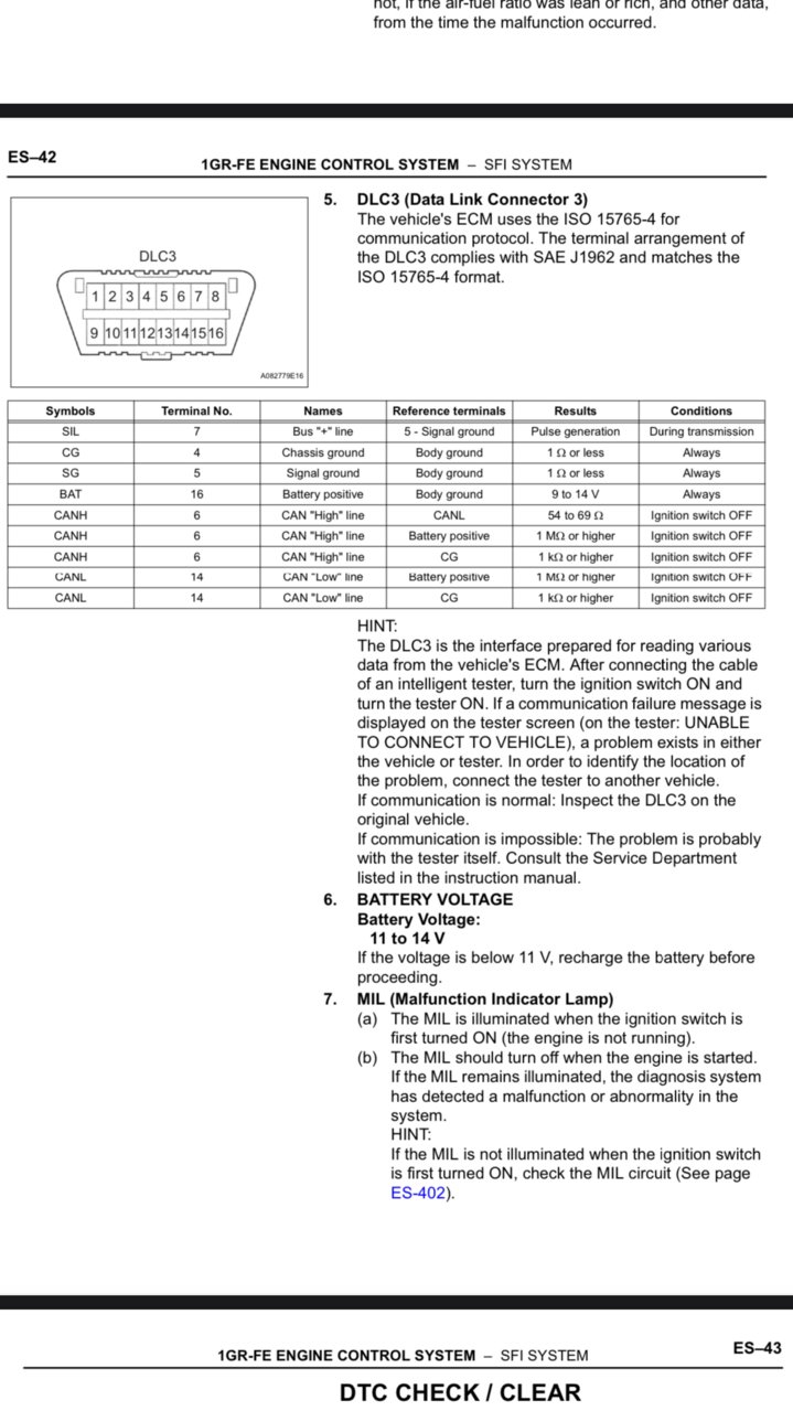

    In the ECM file on page ES-42 it says to refer to page ES-402.
    On the ECM file on the bottom of page ES-42 it says to refer to page ES-402. I searched for it and could not find it.
    Would you happen to have access to ES-402?AD19F99C-EA7B-48F6-8CEF-00B2AA777C26.jpg

    These may help. ES-402 doesn't seem to have much info.

    This should be everything you need.
