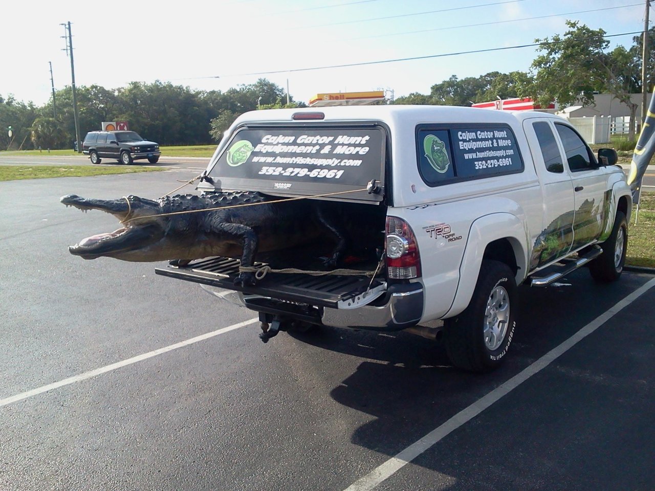

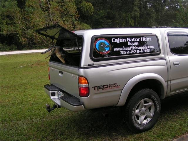

    Couple of past gator trucks. Talk about people gawking on the interstate, LOL. I was heade to a convention to meet up with Willie and Junior and family. They put my large gator on stage and took pics with kids.
