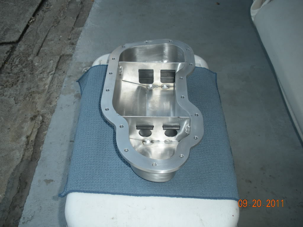

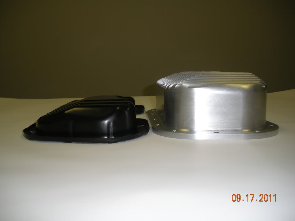

    The 4WD oil pan is a good mod. You have to replace both the upper and lower oil pan.
    For my truck I made a baffled oil pan.
    This is a side by side of the stock oil pan on an X-Runner and the billet aluminum one.

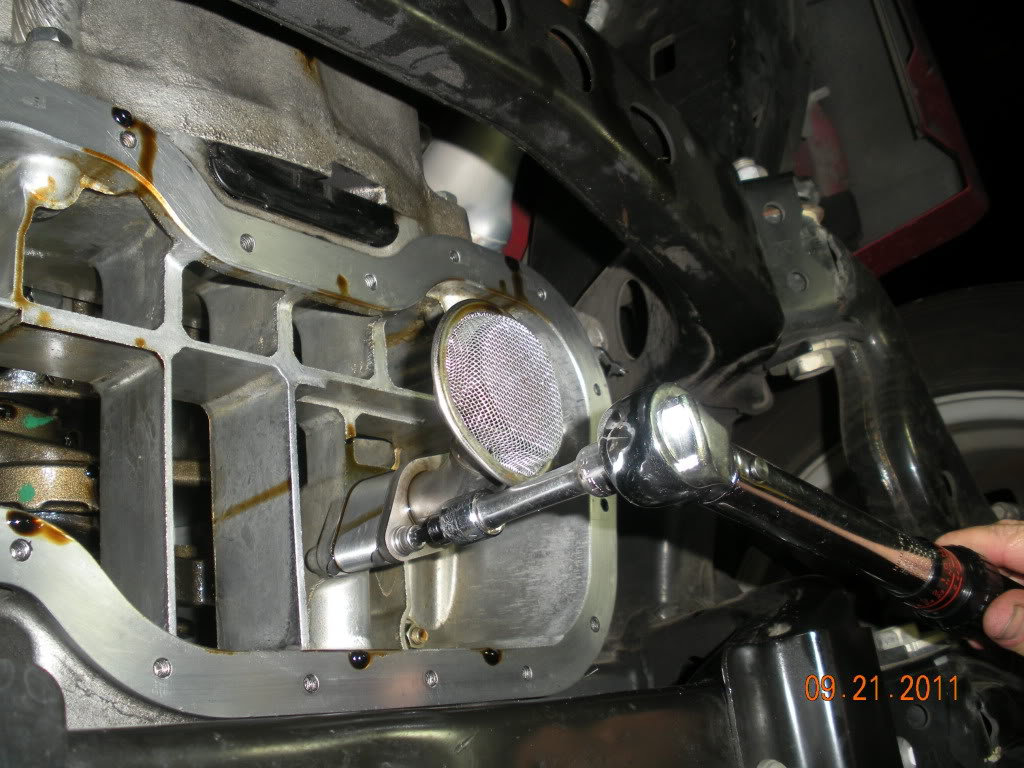

    No. I made a spacer to move my pick up lower in the pan.
    You can see the spacer in this pic.

    I looked and couldn’t find a different oil pick up for the the 4WD or X/R.
    I did find pictures of the upper oil pan, and to me it looks as if the upper oil pan has a drop in incline built in to lower the oil pick up tube?
    But that’s just my opinion based on visual observation.
    I guess what I’m saying is, the upper oil pan seems to be the drop for the pick up?
    AKA, Upper oil pan does the dropping?

    Looking at the pics, you might be right.

    Might be right?
    o_O
    Looks like there is no doubt he is correct.
