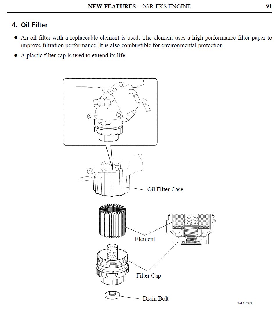

    how do the particles get by the Oil filter? I thought this was the filters main job is to prevent unwanted particles from running thru the engine and cause damage, a lot of oil filter manufacturers brag about 99.9% filtering capabilities of their products

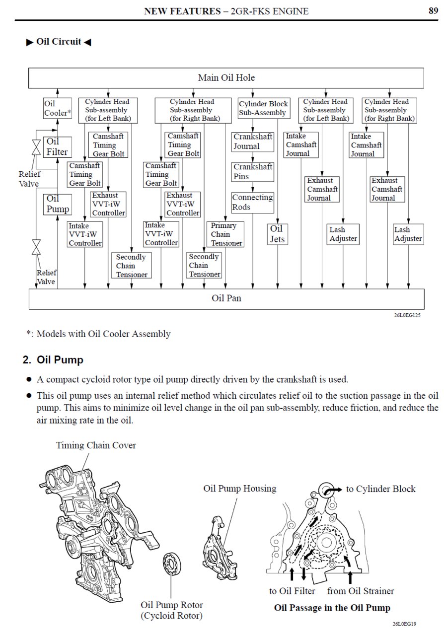

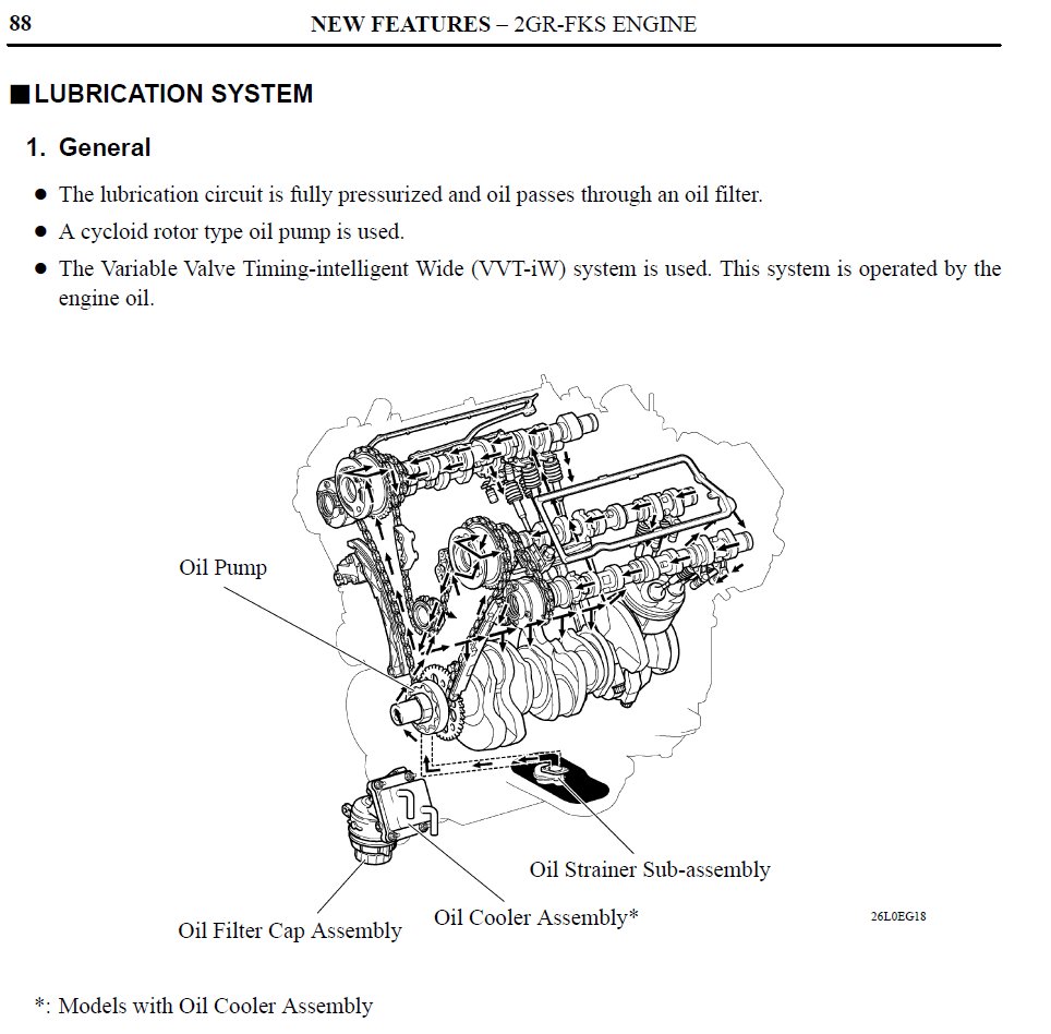

    Main Repair manual doesnt have a good one that I have seen.
    The 'new features' pdf for the engine has some data....

    So if it was the VVT widgets that threw the code, then judging by that chart, the shavings probably would have originated in the head and then washed into the oil pan. Clearly some of them got sucked up by the oil pump and made it to the filter. So, long term, could be head damage, but I'd expect the bottom end to be fine, except maybe for the oil pump and possibly a clogged screen.
    I'd be asking for an extended warranty though, there's a lot of guesswork there. I'd also want them to drop the pan and check the screen.
