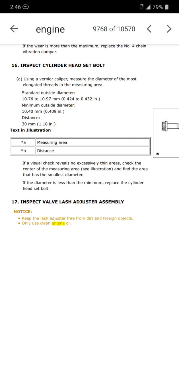

    From the service manual on head bolt set

    Doesn't sound like torque-to-yield to me.

    Replace head bolt only if smaller than minimum outside diameter.

    Good ! So they were probably within spec and you should have nothing to worry about.
