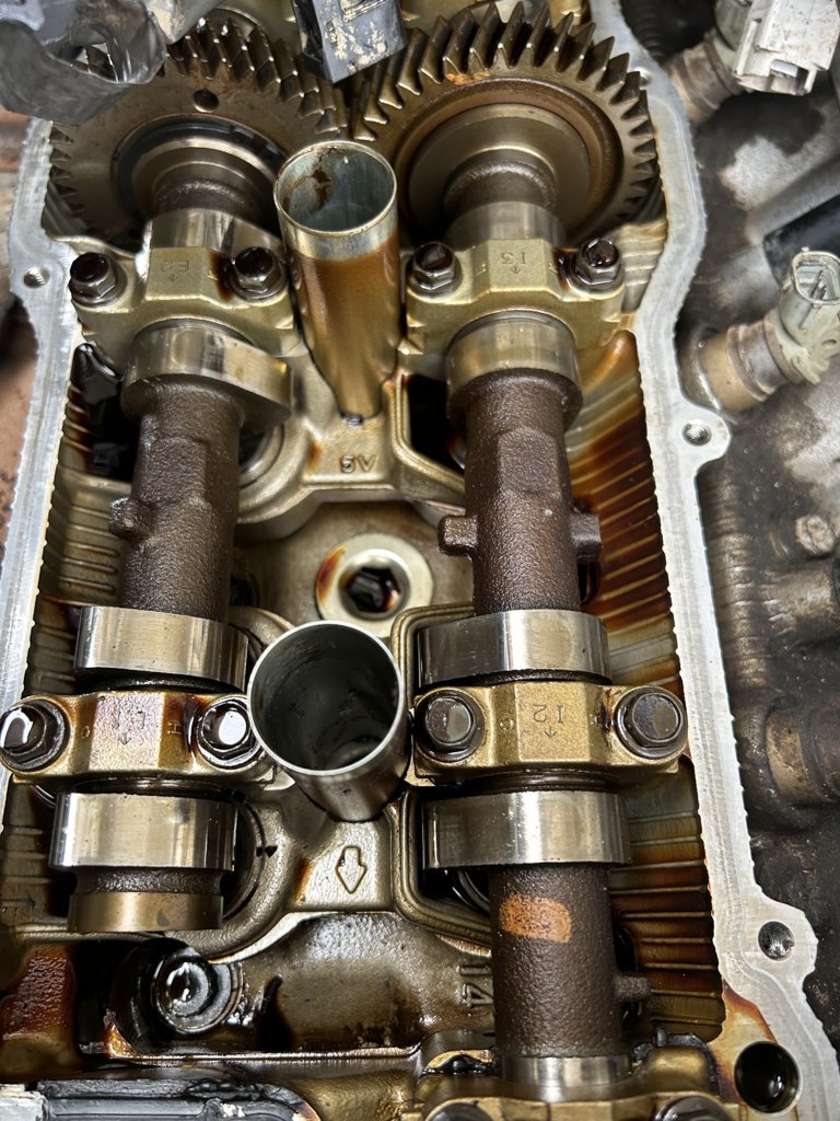

    here’s some photos of the valve drive on my 4Runner with about 315k miles from last year.
    If the covers leak again soon or if I feel like it in about 10k miles of running the valvoline stuff I’ll pull them off again and take a look to compare.
    According to Valvoline and many different tests, their main purpose of the oil is to reduce carbon deposits around piston rings.
    this is exactly the issue. I’m having with my mini Cooper, causing it to burn about a quart of oil every 1600 miles.
    I will also report back after a few oil changes with the Valvoline and not if oil consumption goes down on that car.
