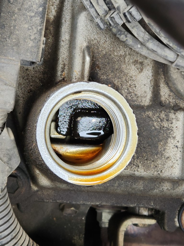

    @shankyjones I took a picture of mine for you 2002 3.4l 120k miles well maintained on oil changes. 20250607_104022.jpg

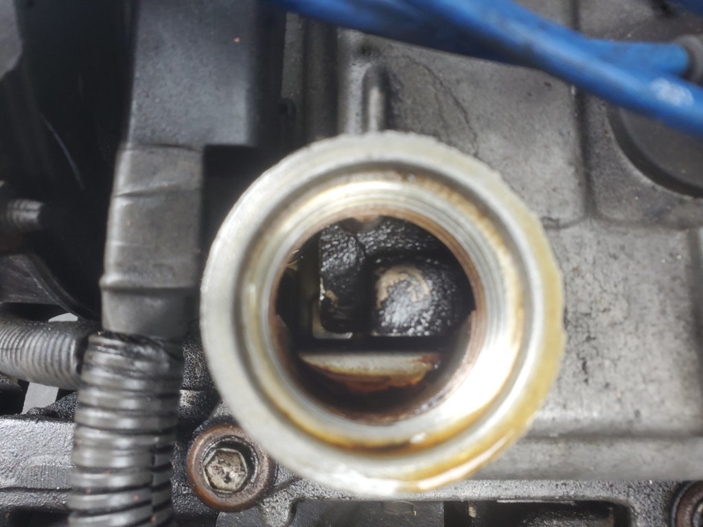

    Thanks for the pic. Here is min3 for comparison
    03 234k miles

  3. Jun 8, 2025 at 6:19 PM
    #23
    Parkvisitor
    Parkvisitor Do you know midnight?
    May 27, 2019
    #294502
    2,355
    Juan
    So Cal
    It’s a truck
    stuff
    Isn’t that the shield under the valve cover?
    It’s thin, it gets hot so that discoloration is nothing to worry about
