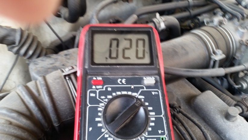

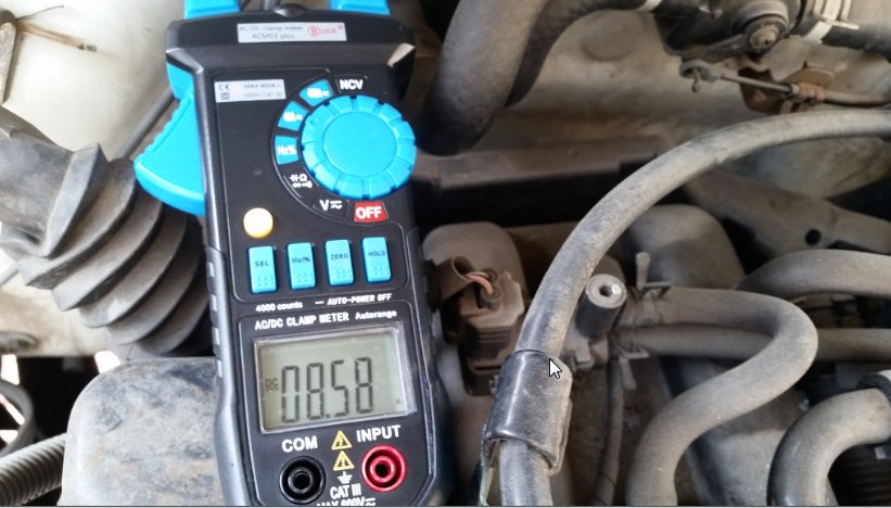

    In my 2.7 engine it is on the back fat black wire between the engine and firewall. If the issue is not intermittent you can measure the voltage between the engine block and truck's body. This is the first thing I checked when diagnosing the issue with my temperature reading.
    At first I was shocked to see any reading at all, but then I did the math. DC clamp meter showed 8.58A going between the engine and the body.
    So the resistance is 0.02A / 8.58V = 0.0023 ohm. That is perfectly right.
    greengaint97[OP] likes this.
