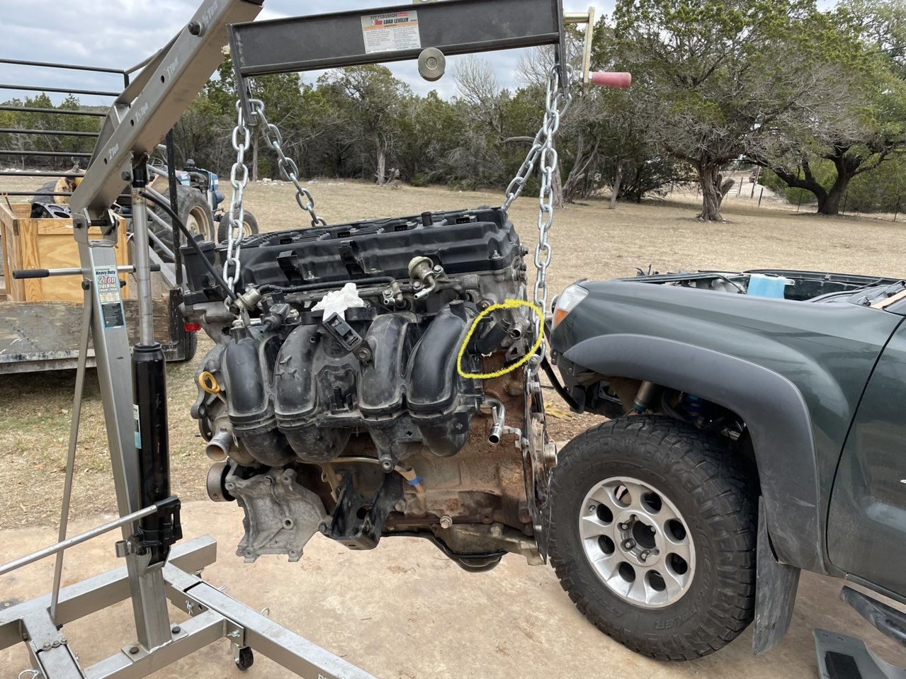

    Soo.. I recently went through the process of changing out the ect (coolant temperature sensor) on my 2006 2.7l 2tr-fe tacoma.. I also ended up changing out the coolant by-pass pipe.. ive gotten everything back together.. two things though...
    1. The hose leading to the backside of the manifold was pretty rotten... there are long splits on the end of the hosing. I'm planning to replace the hosing asap, but I tried starting anyways...
    2. When I got it started it was idling hard.. not wanting to start at first and eventually stalling out..
    What id like to know is if the hose is broken that comes off the backside of the manifold (by the firewall) if this could cause this issue or if anyone knows if i should look somewhere else for a missed connection.. im doing all this work outside in Chicago so I've kind of been at the whim of the weather.. but tomorrow is supposed to be 64F! Hope to get my truck back to road worthy by sundown.
    Also wondering what the item number of this vacuum hose im talking about is or if it's a generic hose I can pick up anywhere.
    Any help is very appreciated!

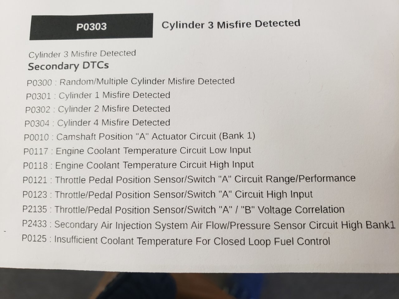

    I replaced that tube and am still having the same issues... I just pulled codes and it came back with these codes.. previously when I pulled codes it just came back with coolant sensor.. is this cause for concern?

    I'm betting the key got turned on with a bunch of stuff unplugged.

    You are correct... sooo reset and repull codes?

    Reset, swap the #3 coil and plug to different cylinders and see if the miss follows either.
