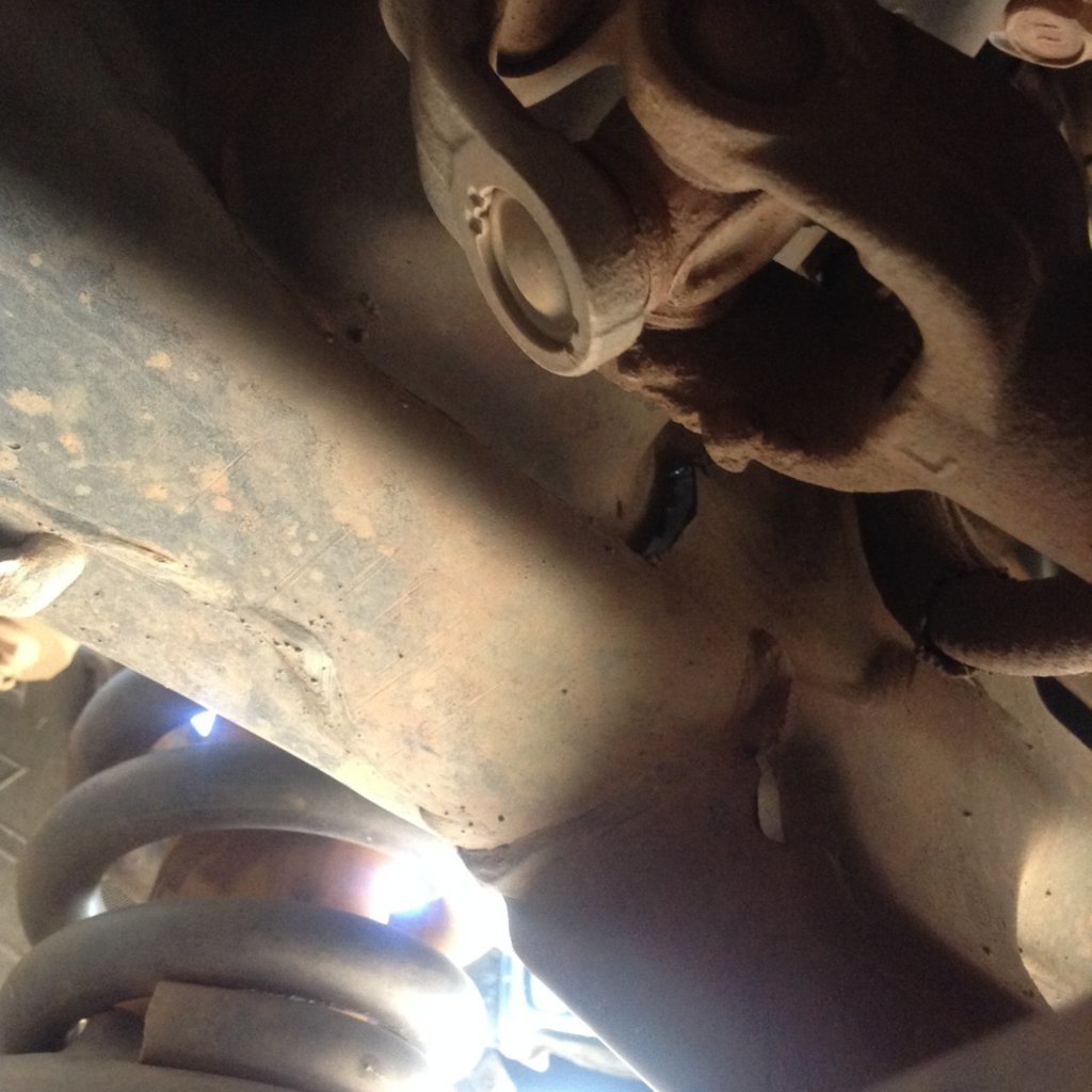

    I've got an 06 Tacoma 4.0 4x4 that the engine front has fallen and is pressing against the rack and pinion causing leaks. Anyone else have this issue?

    Known issue for the first couple of years.

    The frame caves in on the driver side where the motor mount is

    this happened to my truck 5 years ago. Paid a frame shop $500 to have it pulled out and welded
