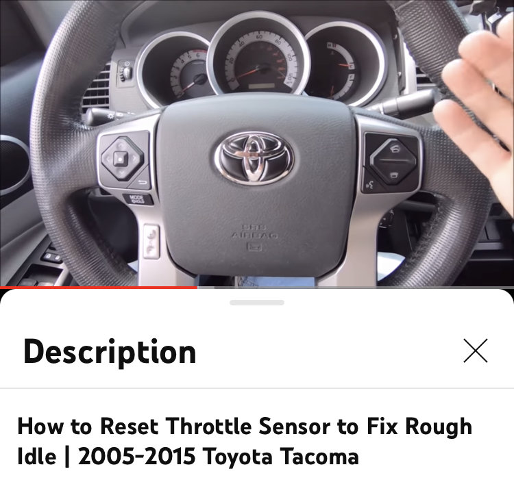

    I know an old post. But it fixed my acceleration hesitation I’ve had for years. upload_2023-9-28_9-2-11.jpgLook him up on YouTube
