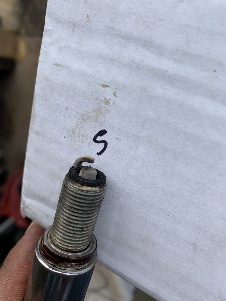

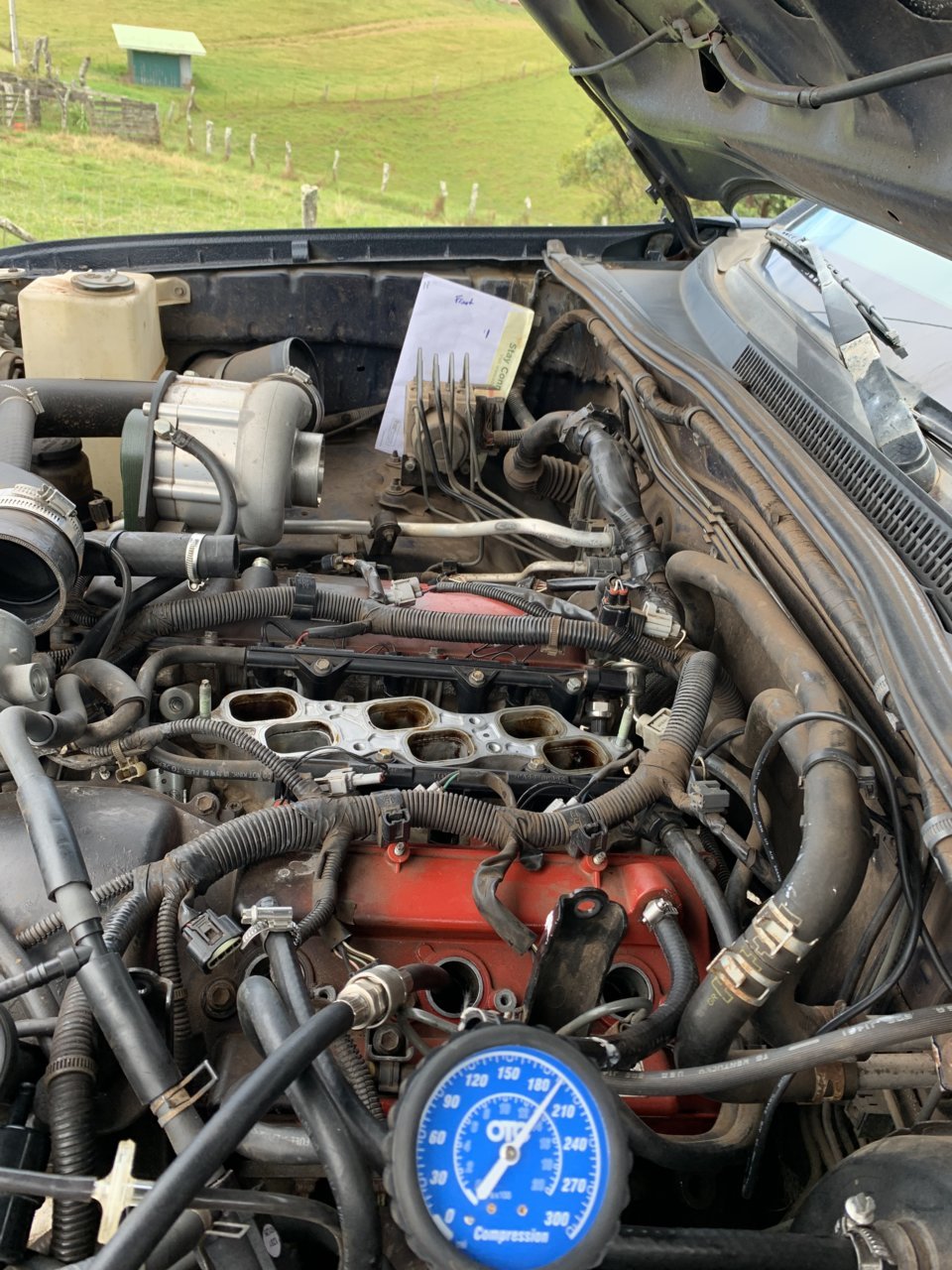

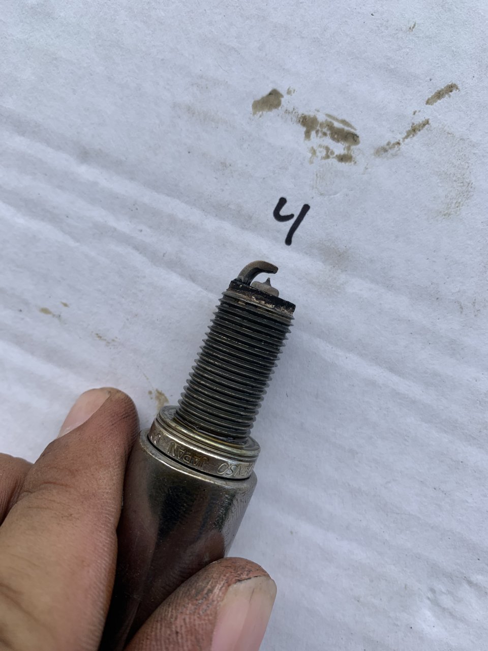

    Replaced all vacuum lines, ensured no vacuum leaks. (Even the EVAP likes)
    did the electronic cleaner spray test while idling around everything vacuum related (no surging)

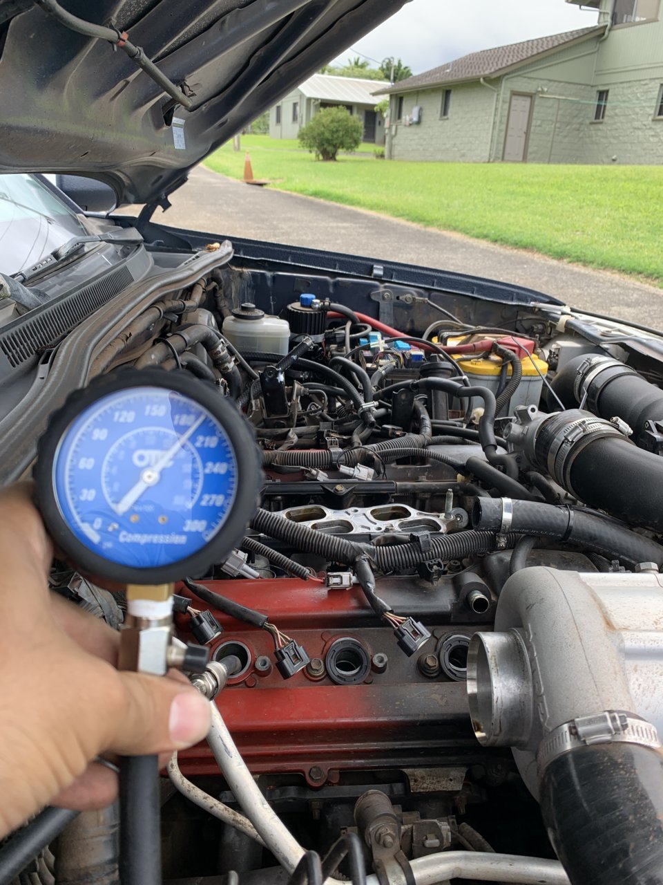

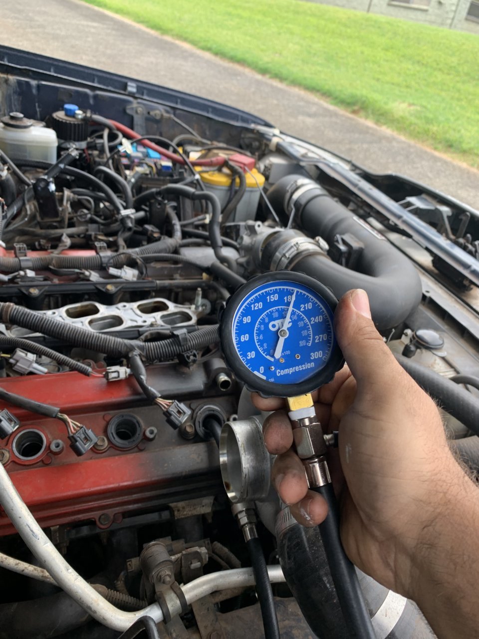

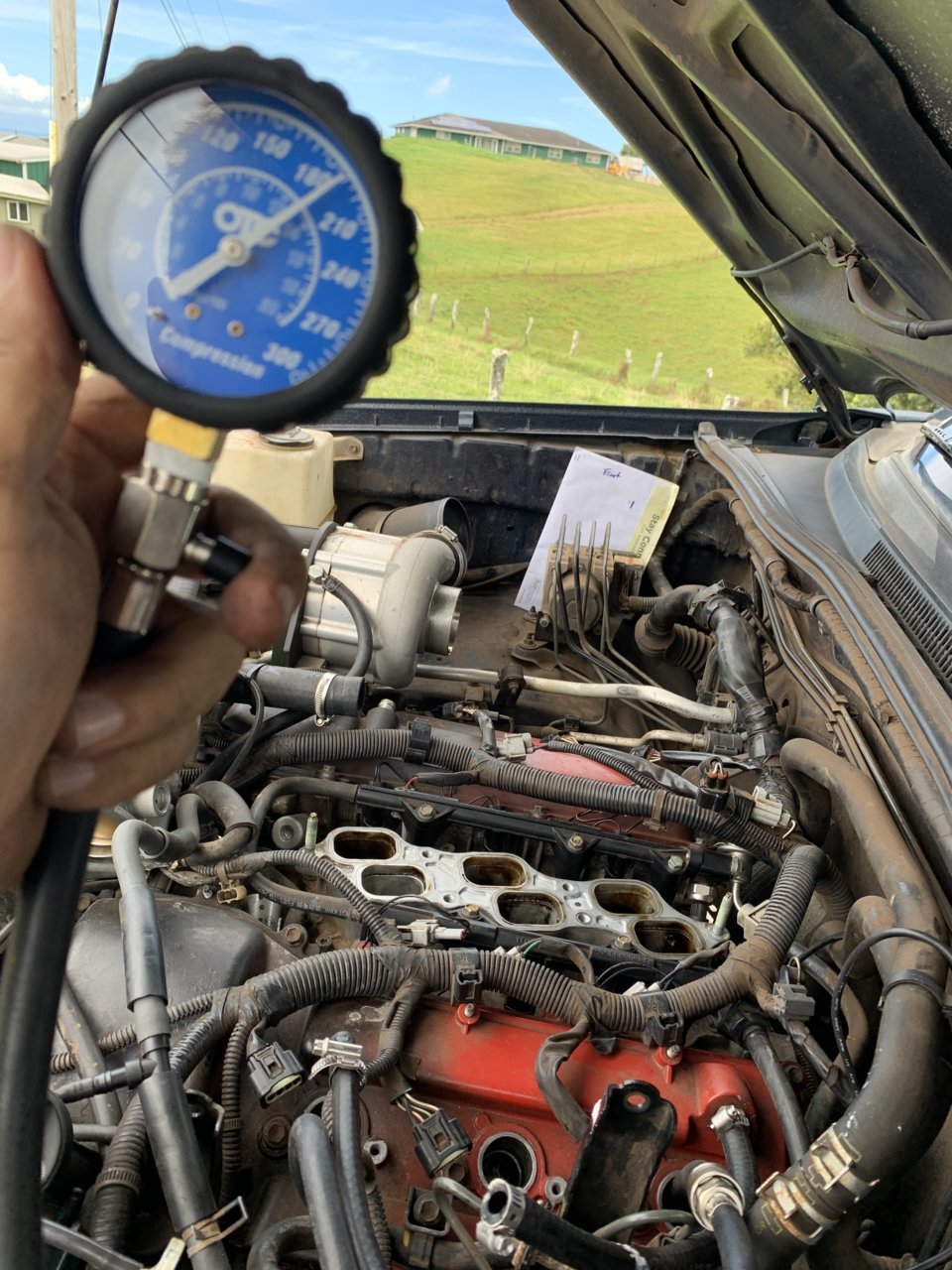

    compression test yields 182 to 187 PSI on all cylinders.
    no CEL codes.

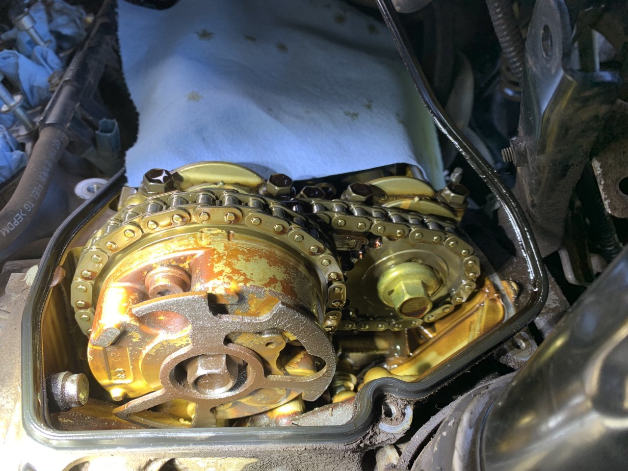

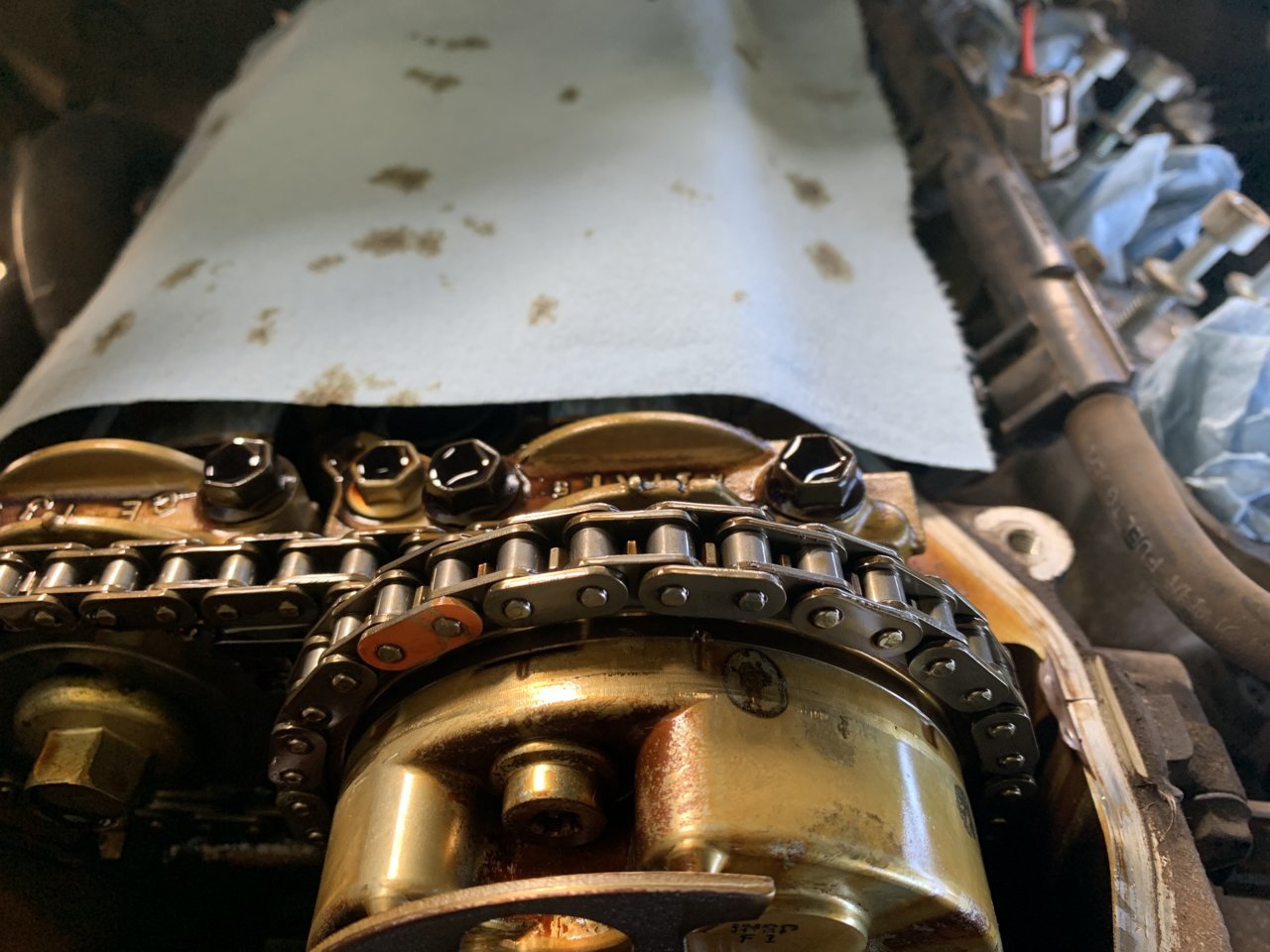

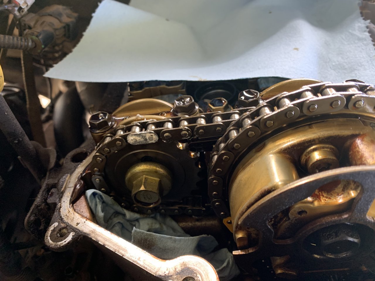

    working with gadget on a timing position verification now (still have one question unanswered).
    fuel pressure is rock solid and never less then 43 PSI at the end of the fuel rail. Vacuum appears to be rock solid as well.

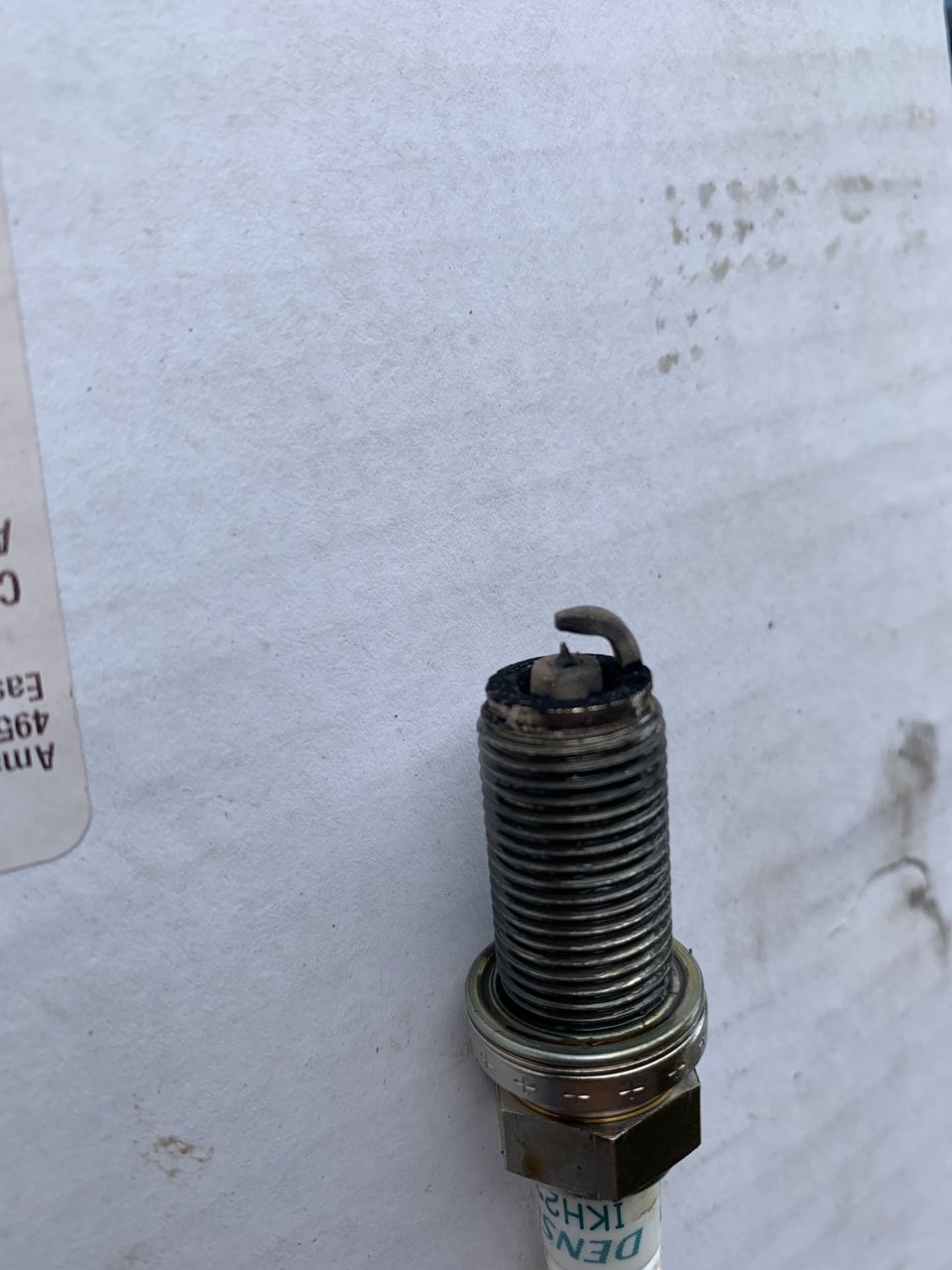

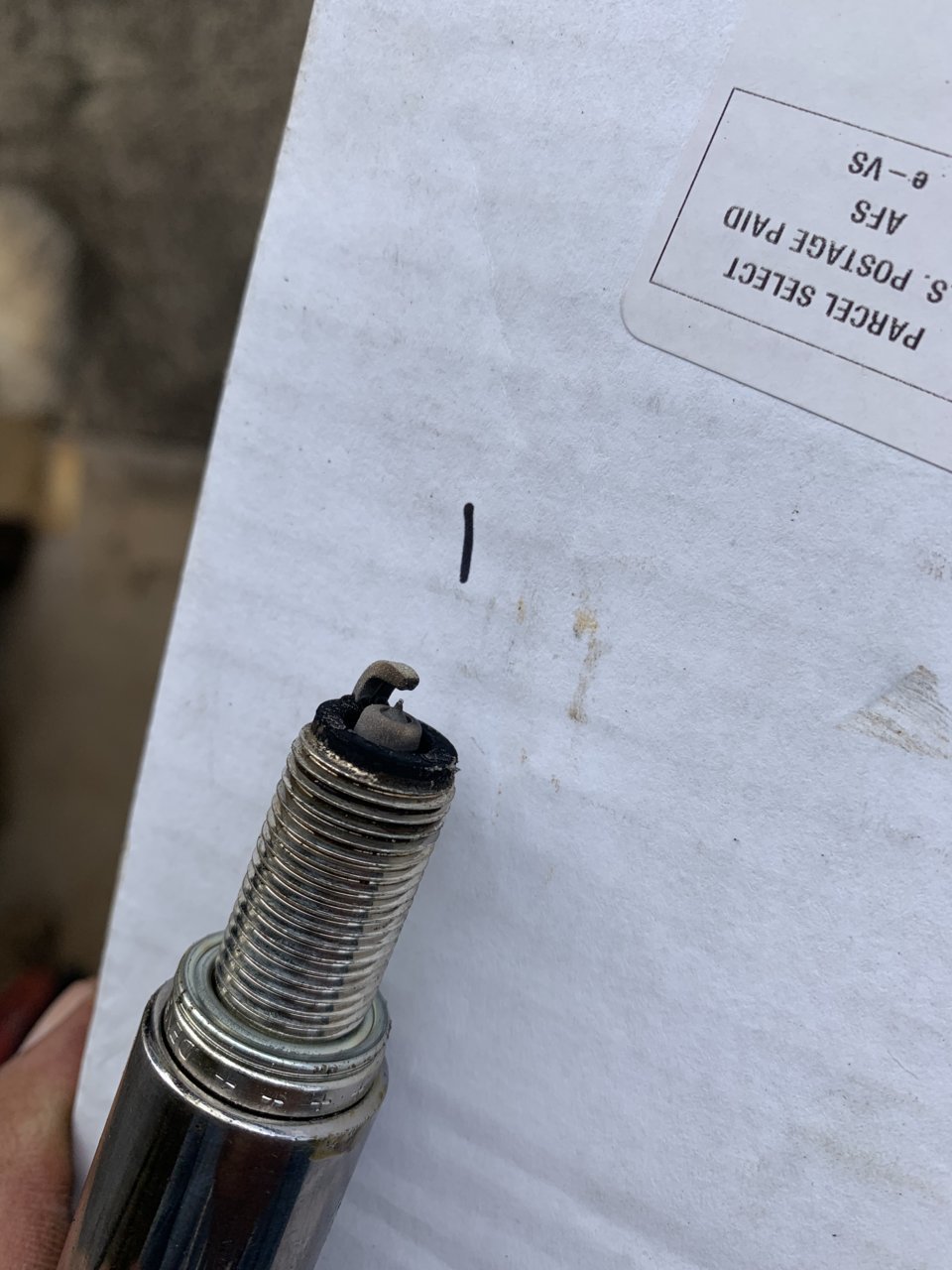

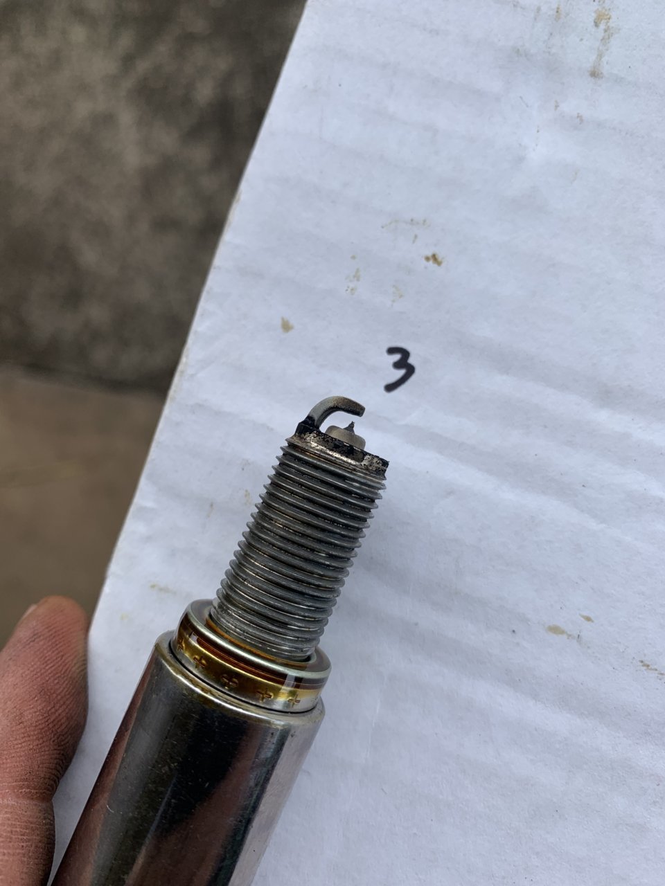

    spark plugs all look identical.
    Verified all fuel injectors are the proper part numbers for URD’s mkIII kit. (Still way to do @torpsd recommendation with stock fuel injectors and bypass the UCON, but don’t have stock injectors, don’t want to use crappy Amazon ones, and don’t want to dish out $700 for new OEM/NAPA ones unless I realllly need to..)
    with the exception of rare cold engine moments, if I drive and only use the first 50% of the gas pedal range, there aren’t really any issues.

    Pretty sure I have mine fixed. Was following this thread because I was having issues that sound similar. Got around to spark plugs and searched the forum to get the factory part number and ran across several posts where people were saying they were having similar problems with Irridium plugs, notice the plugs shown in a previous post are Irridium. Anyway, pulled my 24,000 mile Denso Irridiums and put Denso copper in and haven't had an issue in two months.

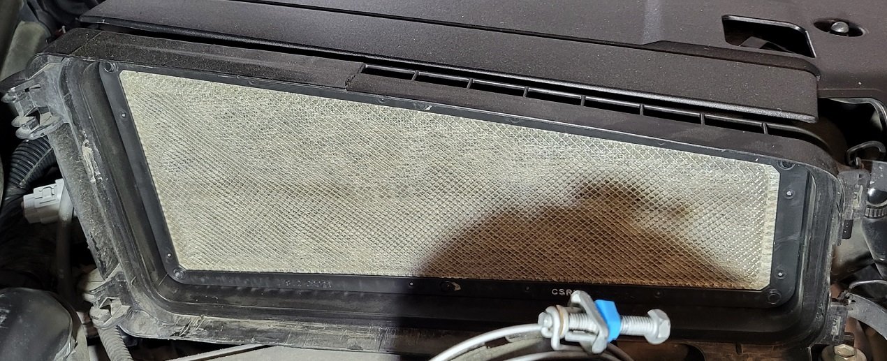

    filter downstream of the air filter. Whatever this thing is called and whatever it is supposed to do.....
    RocketTaco808 likes this.

    @Dergibog, looks like fine desert sand is all up in your taco. It sounds silly, but I’d leave that in place from seeing how silty it looks and maybe try vacuuming it clean with a good shop vac.
