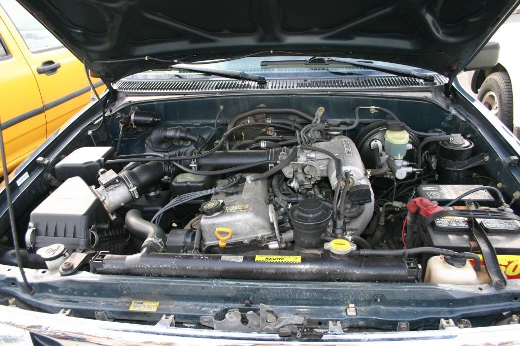

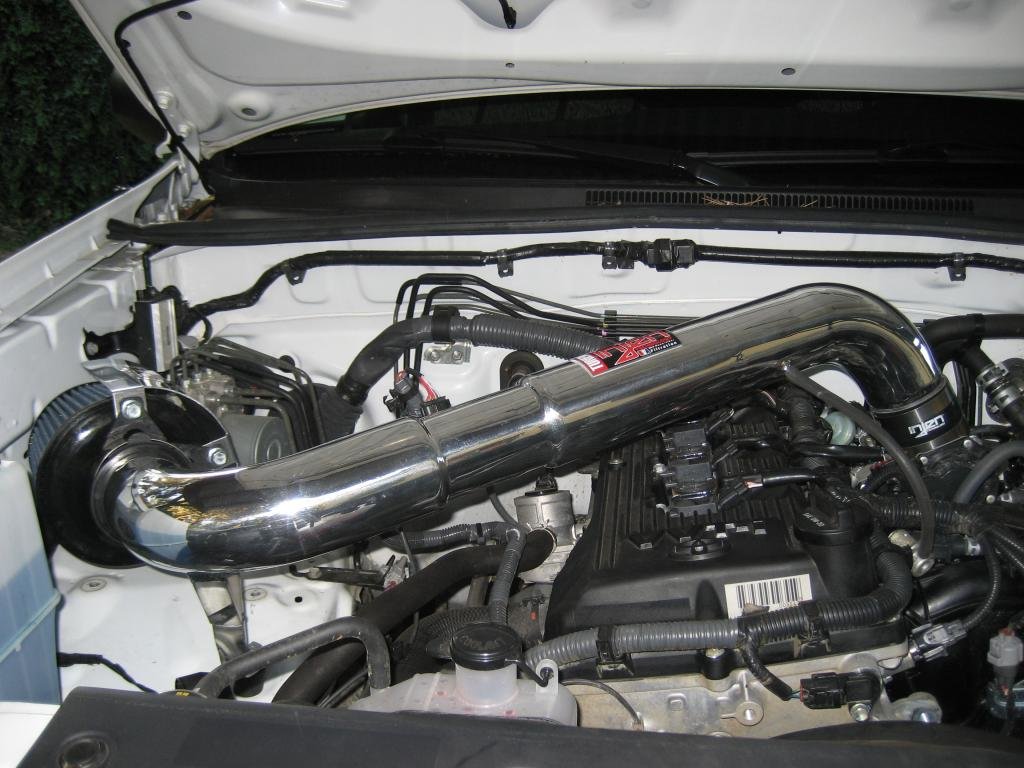

    Yup both the old and new four cyls lean toward the passenger side. The whole truck should lean a bit to the drivers side (gas tank, battery, and driver all make it lean) if it isn't brand new.
    Here is a picture of my 3RZ-FE doing the 4cyl lean...
    Here is a 2TR-FE doing the lean...
    Credit to @tooter for a pic of his engine

    Whew! Thanks Speedytech7 for taking the time to find those images and post them!
    It's odd, I know, but I really didn't remember that amount of lean in there....
    Wow, thanks again! :)
