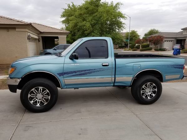

    Me too, I just bought this pickup, it's my 65th vehicle and I love it. It has the 2.7 with a automatic and it's so much fun to drive.

    That is a sharp color and accents ... the 2.7 is bullet-proof and should go forever !

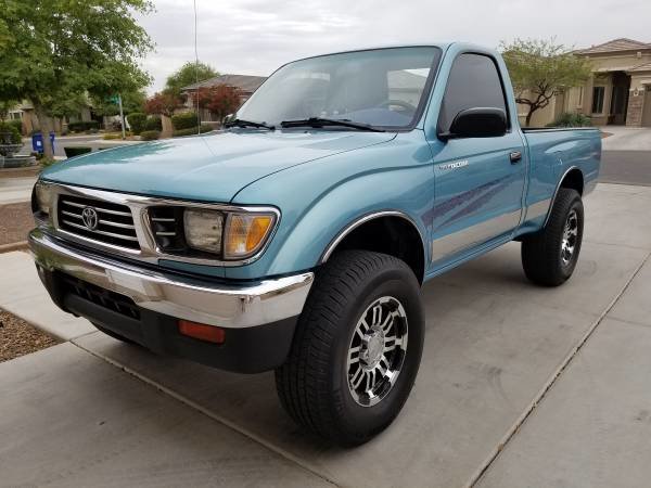

    Thanks, I have new decals (same as factory) from James Dean Creations because the originals are faded.
    I was really surprised that the valves have to be checked on the 2.7. This pickup would outlast me.

    +1 on the sweet color and stance. stylin!
