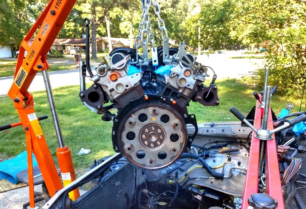

    Everything but the driveshaft. B03A - 410
    ^^^ All great suggestions from our members. I just swapped in a better motor for my 99 model. Keep your truck.
