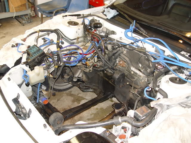

    sorry i had to...

    lol i literally thought your engine was missing cause from the home page there was a picture with a empty engine bay haha.
