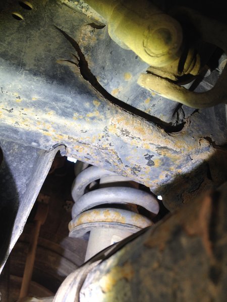

    Was it the rubber mount, which attaches the engine to the frame, or the frame's perches? Any pictures?

    Damn, in that link the whole mount was ready to rip off! Looks like a fun fix, lol. Not a ton of space to work with!

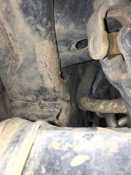

    Here's a pic of where it failed.

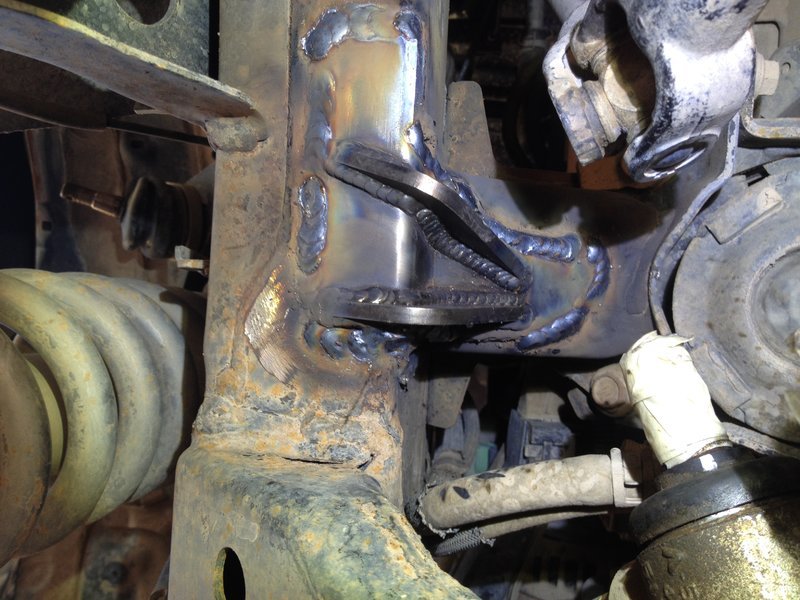

    All fixed up by a local Fab guy I know, gusset kit ordered from DMZ. Kit cost $130, fabrication fix cost $680. Definitely less than what I was expecting.

    Don't forget to clean and paint the new steel to help slow future rust.

    Glad you got it fixed up! Good looking work there.

    My fabrication guy already took care of that, let's just say I have no regrets about going to him.

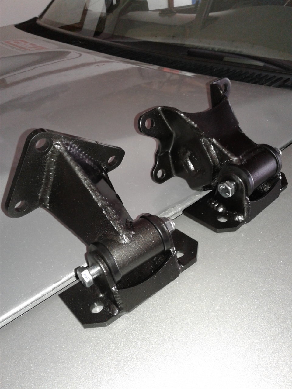

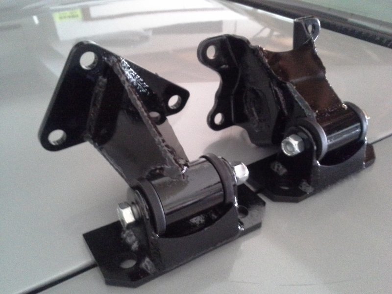

    You need a set of these too...the reason it ripped the frame is from the flex and the "spring back and forth" effect of the weak stock mount. if everything is tight you wont have issues. No flex = no damage.

    PM me and I could give you the number of my guy. Originally got it from Satin Pelfrey at Pelfreybilt. Total cost was $130 for the kit from DMZ and $680 in labor... kit has gussets for both sides and that was the total for both.

    The DMZ gusset kit is a great upgrade if you can weld or have the $$ to pay for it to be done. But you still need to upgrade the weak stock motor mounts to prevent them from stressing your frame all over again. Or the mount breaking in general.

    Have these available for sale right now! Same day shipping.
