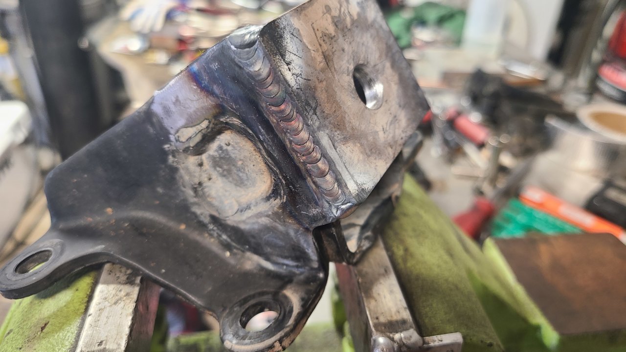

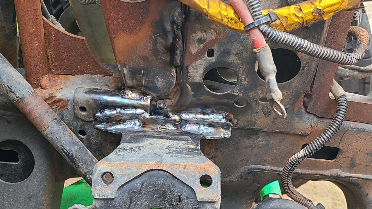

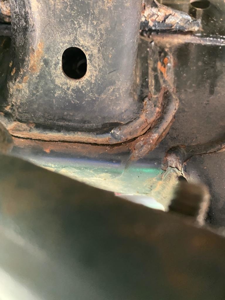

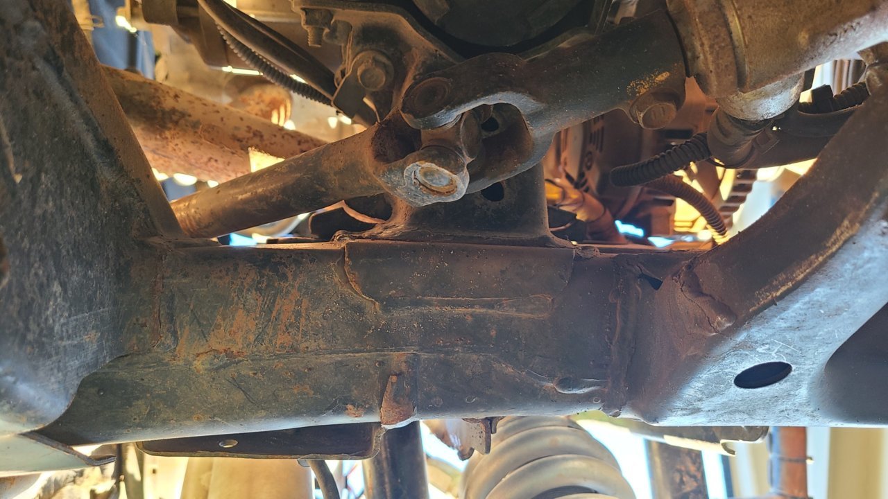

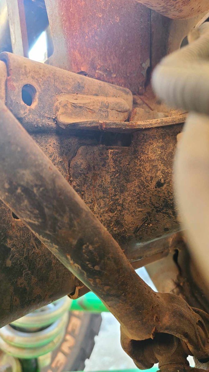

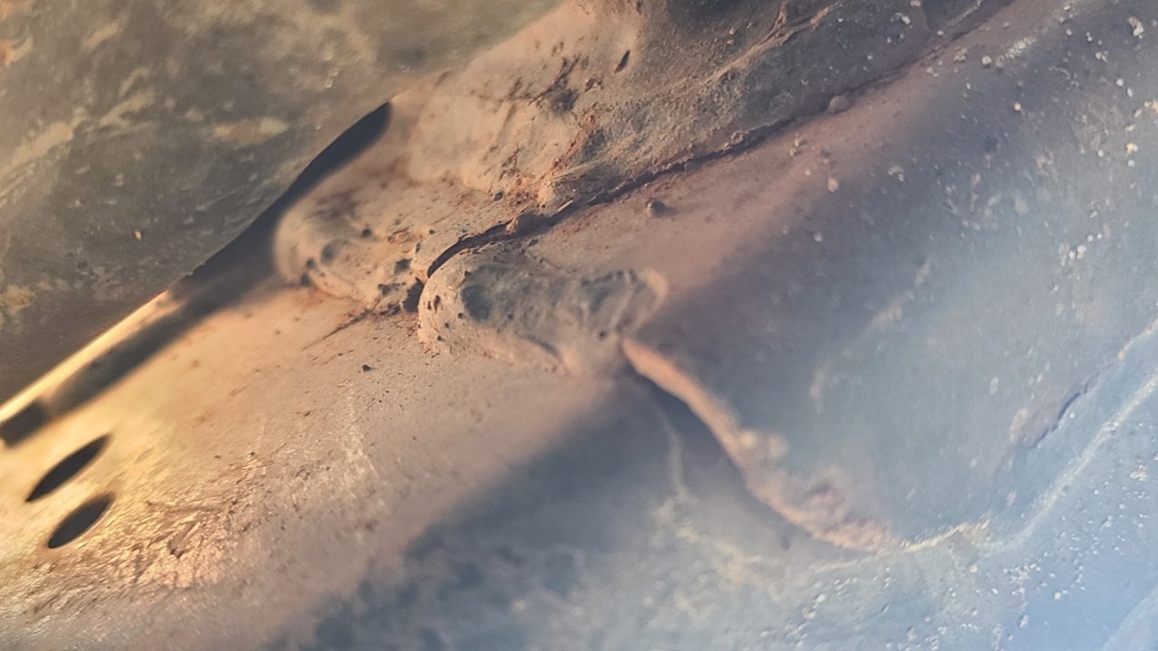

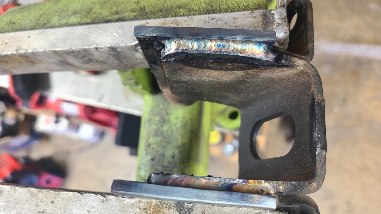

    Here is a frame that really took a beating. 2008 model. So I was told...
    Driver side frame mount. Was even tearing off from the top side.
    Resized_20210421_184553.jpg Resized_20210421_184656.jpg Resized_20210421_184619.jpg IMG_0020.jpg 20210702_170634.jpg

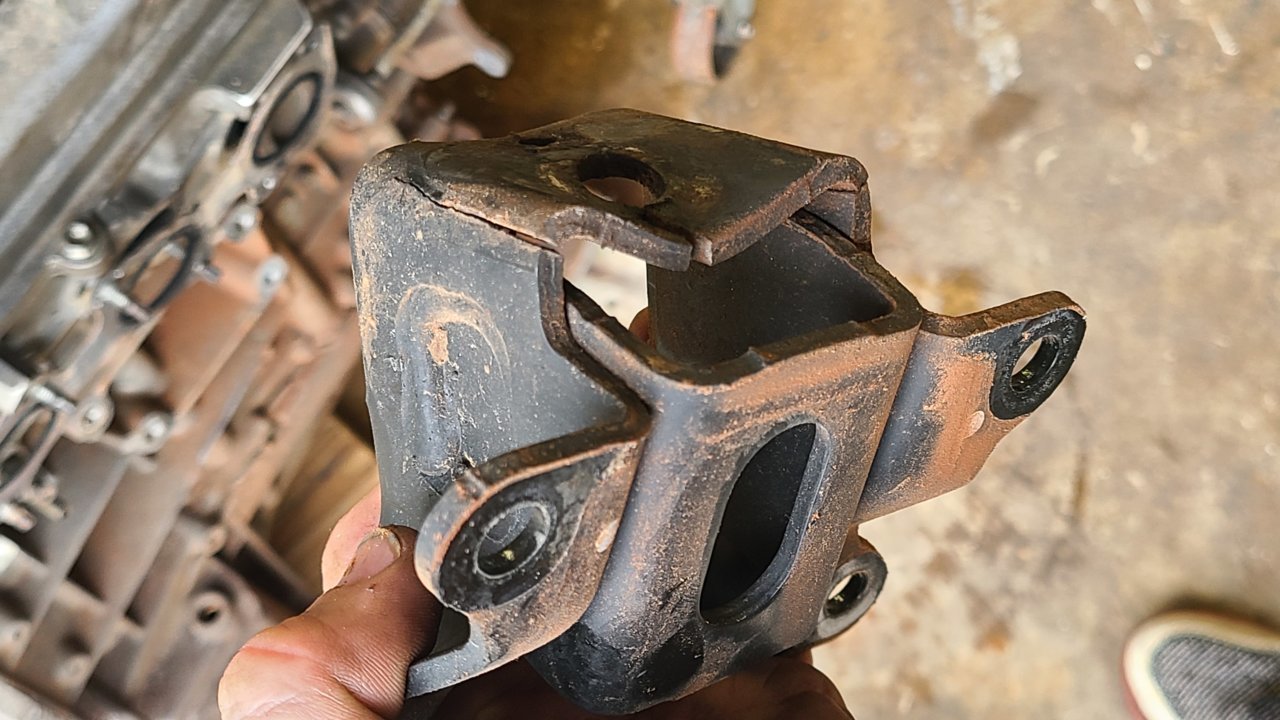

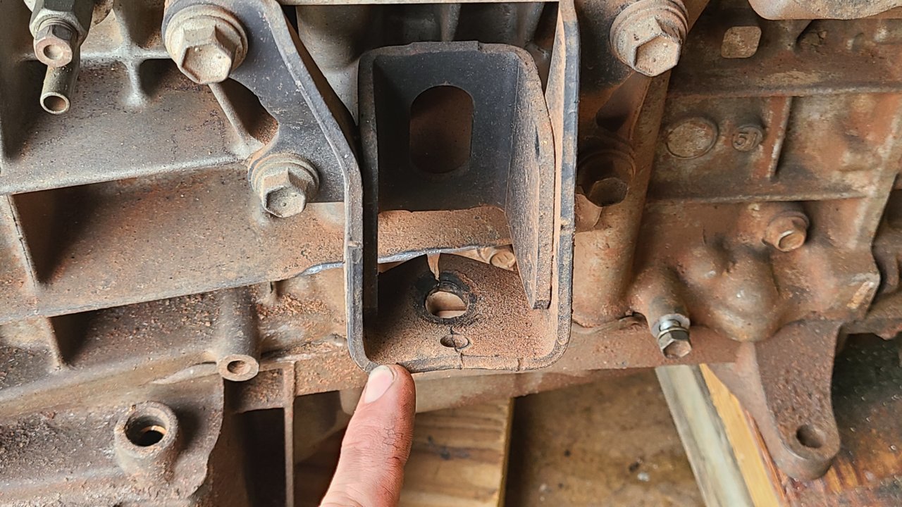

    Passenger side engine mount. Which I repaired with a thicker plate than the mount was made with.
    20210702_172231.jpg 20210702_172530.jpg 20210703_091819.jpg 20210703_095645.jpg

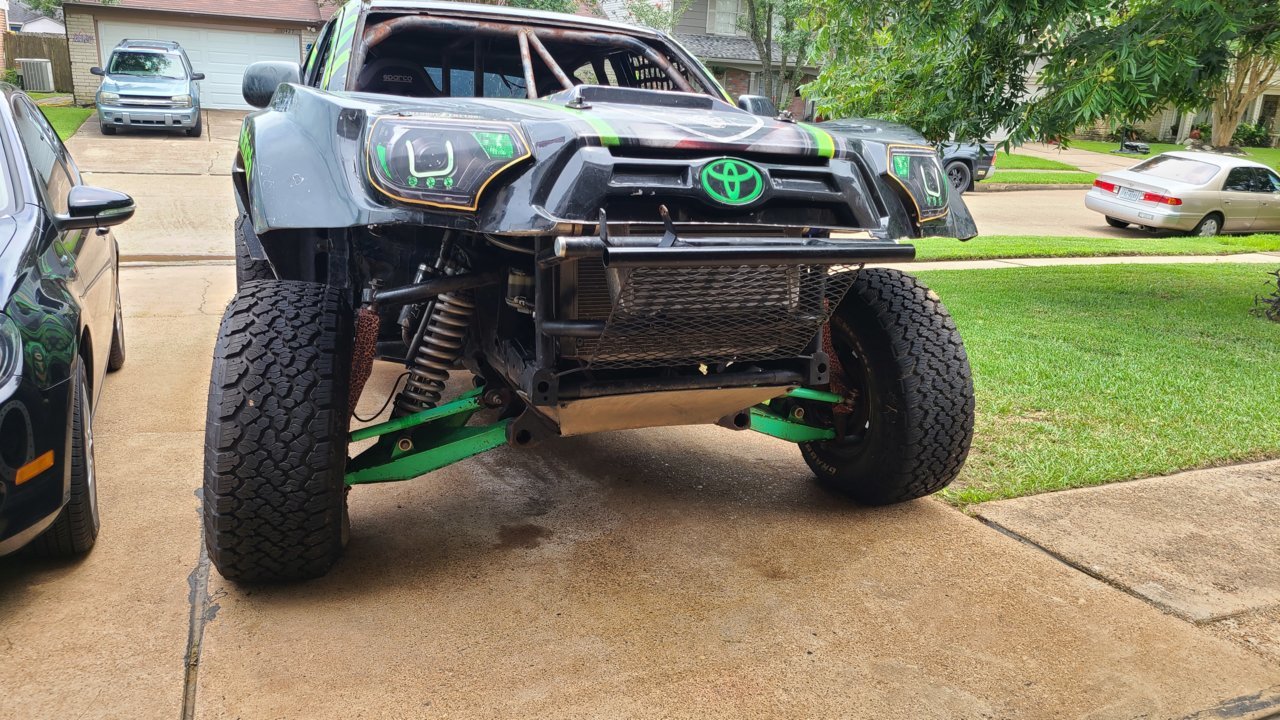

    I would bold the whole thing, but quoting works two. That is all accurate.
    The owner of the truck that has those mounts, I think contacted you. I urged him to get yours. He even came back later and asked if I knew of you. I said yes. Sadly, that was the end of the extent of that. No Bonzen mounts were purchased unfortunately.
    My recommendation was strong. Who knows, maybe in the upcoming future, they will be added to the truck. I certainly hope so, for its sake.

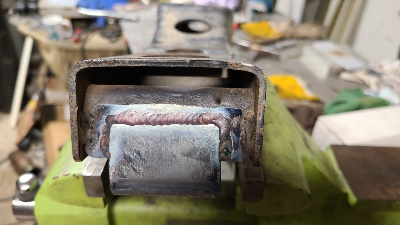

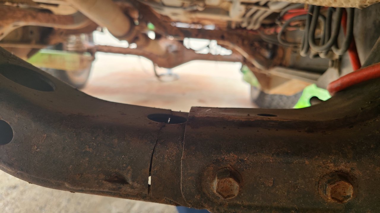

    To complement what you were saying about the abusive nature of Baja/Desert racing. The OEM transmission cross-member was barely held together by small strips. I corrected that, and added gussets to it as well. That genre of off-roading, really taxes the OEM componentry.
    I cannot recommend them enough. Turbo kits, S/C, or even rock crawling.
    You may or may not recognize this truck, @Bonzen . Don't quote this, but I believe it is a Class 7(?) truck now.
    I wish I would have taken more pictures of the before and after of the cross-memeber.
