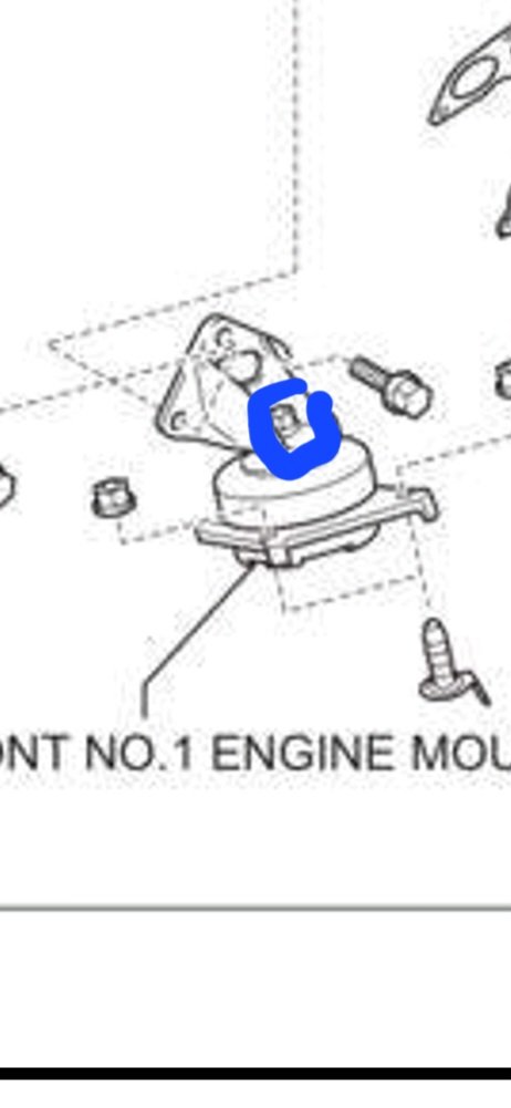

    Anybody know the torque spec for the nut circled in the pic?

    There isn't one listed. German torque

    One of mine came loose. Use blue or orange loctite. Solid Offroad recommends this.
    you can’t fit a torque wrench in there anyway. Using adapters throws off torque value.
    if they torqued it at the factory it was before marrying the body to the frame when it’s accessible.

    I think one of mine may have came loose too, the loctite makes sense, I'll do that and not worry about it
