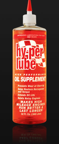

    Does anyone like adding this kind of stuff to your oil changes? Is it really smart to add this on a high mileage taco like mine at 237,000 or is just fresh oil fine? I don’t know much about oil additives. I added a little bit of this hyper lube stuff on my last oil change and it ran absolutely terrible (surging while driving around 50-65mph) on my hour drive back home that same day. Though ran fine very next day and runs fine now.. What oils/ oil additives do you use?
    Thanks

    I Seafoam my engines a few hundred miles before oil changes to clean things out and I use LiquiMoly MOS2 in the BMWs to help lubricate the bearings. For the cooling system, Water Wetter works impressively well. A lot of these things are snake oil, if it claims to do anything incredible or magic it's probably BS.

    Most of that old school snake oil shit just thickens the viscosity of the oil. Probably won't harm anything putting it in an old small block Chevy or slant 6, but there's no way I'd add it to an overhead cam. Modern oils have all the additives you need.

    Yep, snake oil, IMO.
    If this stuff was necessary, the manufacturer would recommend using it, but I'm not aware of a single car manufacturer that does.
    If your truck has lost power/torque, you need new rings, seals, or a rebuild, not an oil additive.
    Save your money: buy beer instead.

    Oil additive doesn't make your truck run bad so if it did indeed it wasn't due to the additive. A good quality oil and filter changed on a regular basis is all that is needed. I always run Mobil 1 and Toyota filter. My 1st gen had 200k when I traded it in and ran like a top.
