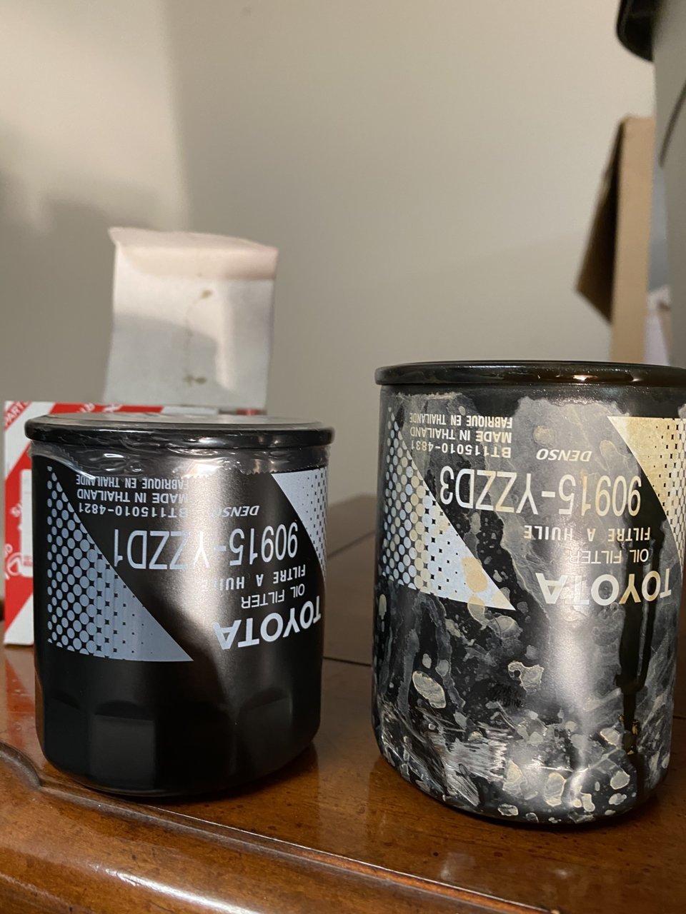

    Okay so I’m doing my oil change right now. Removed the the drain plug. I’ve let it sit for about 30 plus minutes so it can drain every drop that comes out. Removed the filter I used the bottle method to catch the engine oil. Works great by the way! Upon grabbing the new filter that I got from Toyota it’s way shorter than the one on my Tacoma. The sales man gave me a 90915-YZZD1 instead of a 90915-YZZD3 which was what I took off. My dumb fault for not paying attention. So annoyed! My question to the gurus will I be fine if I use the YZZD1?

    They are the same filter, D3 is just bigger capacity. Run it and change it when you have time.
    Won't harm anything until its resolved.

    The slight height difference

    Back in the day we used to use D3's on the 3.0 and 3.4. They called for D1s.
    They are 100% interchangeable. But the V8's and the 4.0 V6 call for D3 simply for capacity.

    When I did my first oil change, I ended up with a shortie version too. Not a big deal, it just slightly reduces the amount of oil you put in by maybe a half quart.

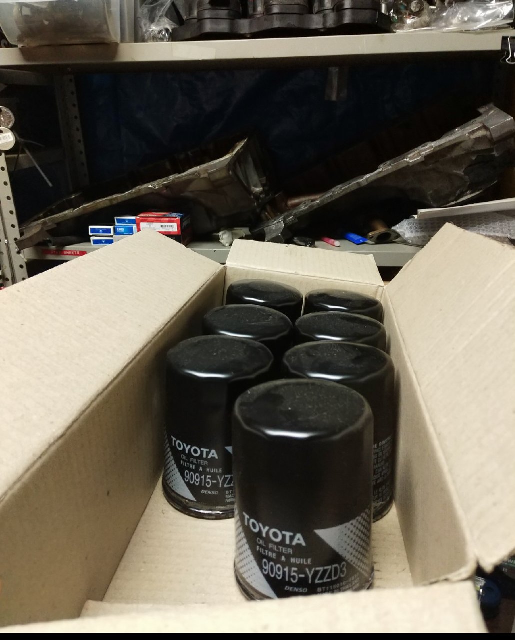

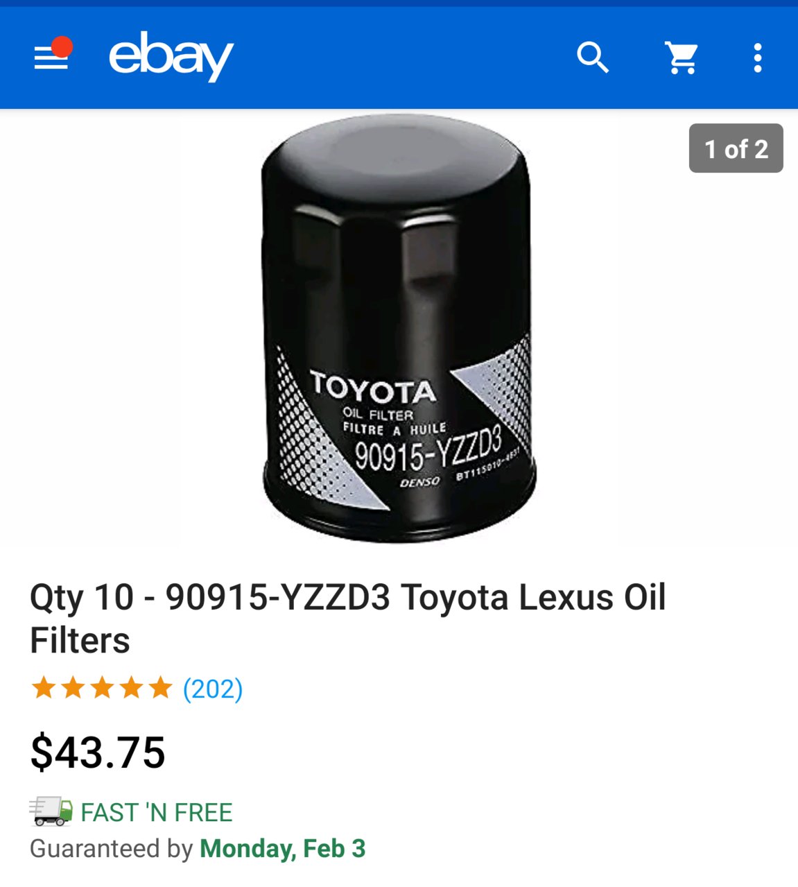

    You didn't mention that you distroyed the old one, DONT PUT THAT ON YOUR TRUCK! If you have to drive it to get a new filter, use the new one as a temp.
    A tip for the future... I walked out to the shop and took a pic just for you, lol. Buy filters by the case of 10. Cheaper and you have backups :)
    J/J with you bro, Ive been there, plan to do some work on your truck after work and something go wrong so you can't get to work in the morning, it totally sucks!

    Joseph
    Hub City
    2023 TRD Sport
    To save $5? I have a shelf of D3's I've opened to check for particles. The tube and filter run the full length of the filter. With the 1GR-FE running a pretty low oil pressure already by design, not sure I'd feel safe running a filter with less surface area for any period of time. Especially over $5. To put $5 into perspective, Just think about how much money you spend a month just on wheel and tire cleaner. Now, Your engine ... Vs.... shiny tires.... Lol! That's just my personal opinion of course.
