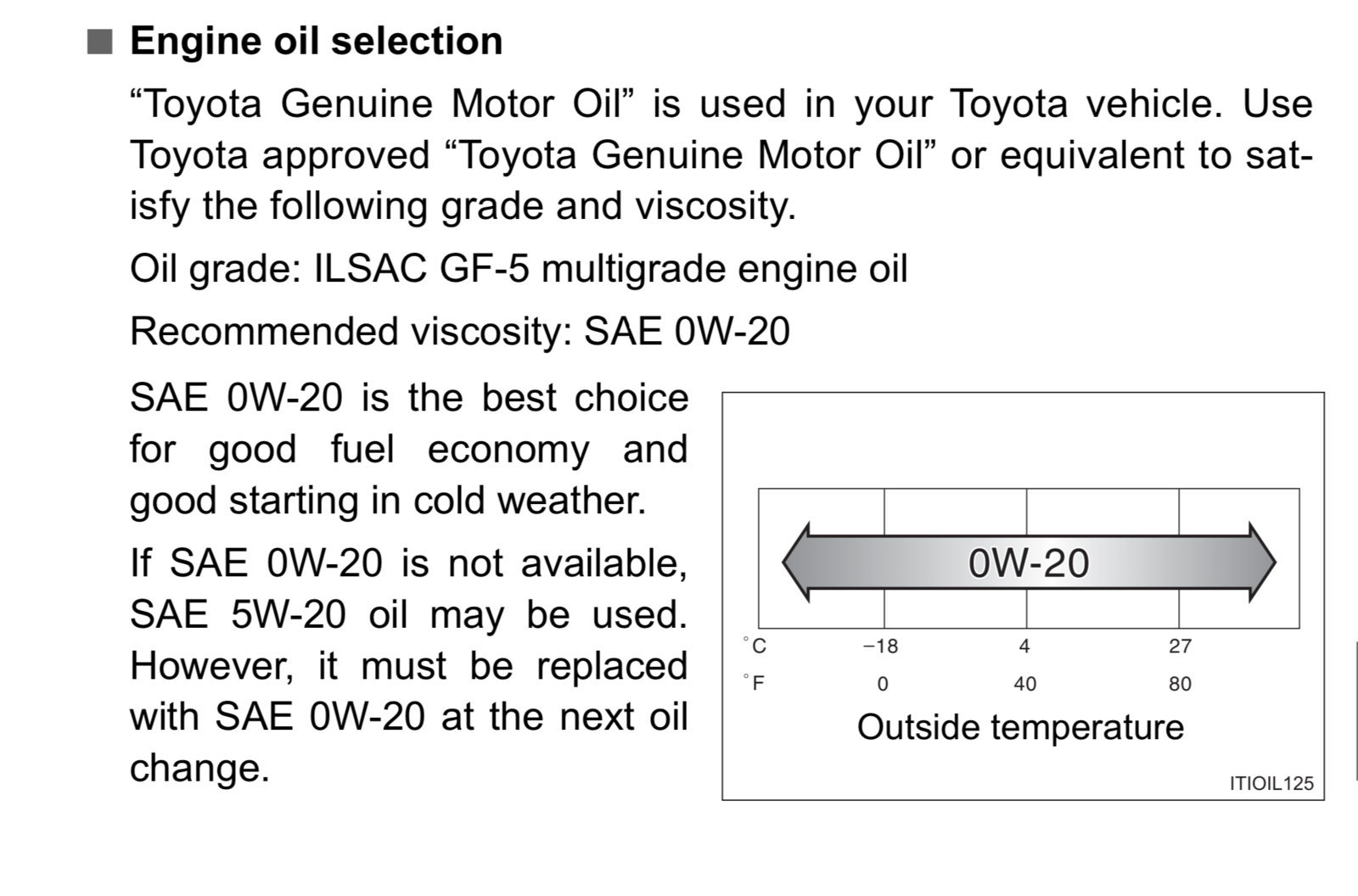

    Manual also states that your driving conditions may dictate using a heavier viscosity. A lot of owners manual thumpers leave that part out.
    • The 20 in 0W-20 indicates the viscosity characteristic of the oil when the oil is at high temperature. An oil with a higher viscosity (one with a higher value) may be better suited if the vehicle is operated at high speeds, or under extreme load conditions.
