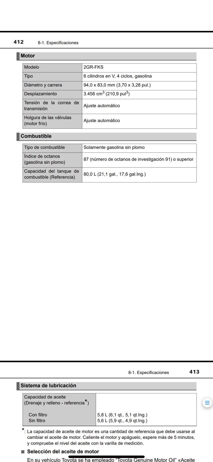

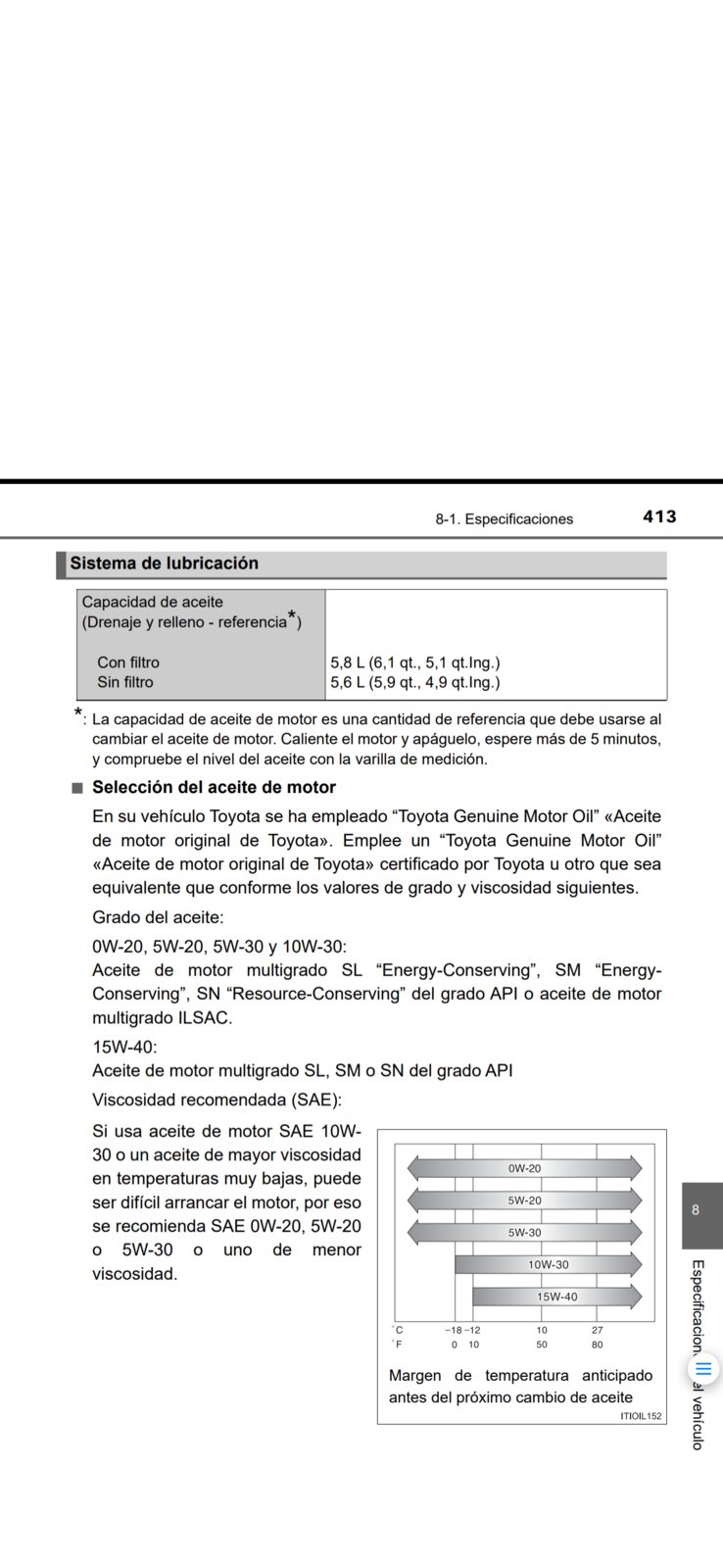

    The North America owner’s manual is not really representative of what Toyota’s highly educated, trained, and experienced engineers think.

    There is really nothing to disagree on. The fine engineers tell you what you can run in Mexico vs here. Only reason they can’t tell you to run here what they do in Mexico is eco politics. If you don’t want to believe that, that’s fine, but that is the truth. The owner’s manuals are different while the engines are exactly the same. The engine doesn’t know what side of the border it’s on.
    Aside from piston ring gap, “tolerances” (I think you mean clearances) have not changed. The bearings still have as much clearance as they did on other engines when Toyota recommended 10W-30 30 years ago. As I’ve said a million times before, there is not that much difference between 15W-40 and 0W-20. Neither will blow the engine, though you may get more service life doing things like towing or hard acceleration with something 30 or 40 weight as opposed to 20. And, god forbid you have a cooling issue at some point and overheat before you realize it, the thicker oil will protect further/longer into that overheating situation before it thins out too far. So that could be advantageous.
    Note - I have never ever told anyone to run anything specific. All I share is the information from Toyota and why they might say what they do.

    Not trying to stir the pot. Just wanted to add that what is in the manual could be forced to be there based on how they tested the mpg. Not because they think that specific viscosity is best.
    I am still not suggesting anything. However, I don’t blindly follow the US manual just because I live in the US. I follow the chart from the Mexico manual as it’s the most logical option. I don’t and won’t ever tell others what they should run, it’s their choice. I will try to inform when they argue that there is only one choice, however.
