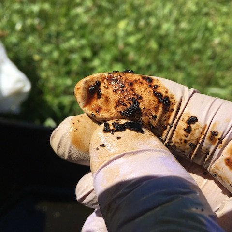

    So after installing the Fumoto valve w/oil change, I noticed these coffee grounds-like grit in the bottom of the collection pan. Want to know if this is serious or just engine sludge.
    Brief history before the images;
    I am the 4th owner. 1st owner-Hawaii- sat for two years under tarp before being sold to small business. They are the chuckle-heads that put the 1st Gen wheels on it and the wrong blower motor for vac. 3rd. owner, my son while stationed in HI. Performed routine maint. on it.
    Shipped to PA.- spent three weeks in a container.
    While driving it from MD to PA, he had oil light coming on & off. Pulled over, no leaking, continued home. No further light warning.
    Jump a head a about 5 months. Truck is getting painted-sat for three weeks. When I pick it up, it already has an engine valve tap, very loud, oil light comes on. I put two quarts oil in it, noise reduces. Drive to work, on return home, oil light and severe engine knocking. Mechanic cleans out the oil pump sump, very clogged, that was the issue. I plan on getting the oil analyzed after the next change. The particles feel like coffee grounds, but can be crushed. Thanks in advance!!Picks;

    Any chance of vandalism? I’m not sure OP, hope someone else might chime in. Bump to the top of the list.

    During the shipment or parked while unlocked. Wondering if someone filled your oil reservoir with saw dust, coffee grounds, etc. I’m just thinking outside the box here. Never heard or seen this before. But I’m by no means an expert. I’d get the oil tested at Blackstone labs.

    Take the oil cap off and look at head. Chunky black stuff more than likely sludge.

    In my many years as a Mechanic I have seen this before. not knowing the full history of your truck to me this looks like what happens when an engine idles to long, the oil will sludge up on the screen and in the pickup tube. then when at hwy speeds the engine is starved for oil and engine damage can occur. If possible get someone to look at the computer readings and see if the average idle time is excessive if so this is probably the problem. (example private investigator drives around and then stops and idles the engine for long periods of time to keep the A/C going) I also seen this a lot in police vehicles that idle a lot. Fords solution was to put a pickup screen in with larger holes in it to help prevent the buildup. Just my .02

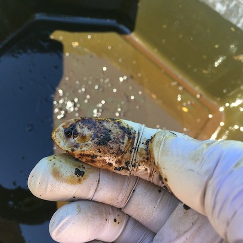

    No synthetic and no water in the oil. The lighting makes it look like there is oil in there.

    That's not good at all. I don't even know where to guess what that might be from. I'd use a quality HDEO like Rotella T6 synthetic for a few short changes. Diesel oils are chocked full of detergents and will clean out a lot of that gunk hopefully. I'd recommend using a higher capacity filter like a Fram Ultra synthetic filter, they hold more grit than regular filters can and filter finer particles. You might want to run the longer XG3600 over the standard shorter version XG3614 though as it will have a slightly larger holding capacity. If you must stick with Pennzoil, upgrade to the Platinum synthetic, it's supposed to be one of the best on the market for cleaning engines up.
