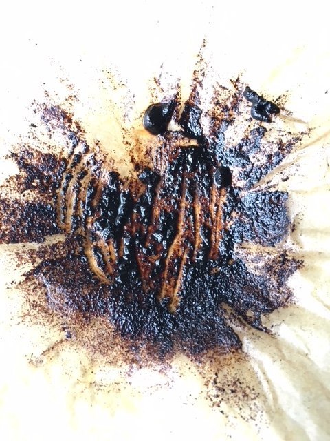

    Yeah, me too. No oil getting up top so there was probably some minor damage. There has not been any residual noises or issues.

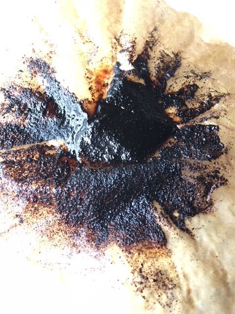

    It looks like sludge, see the video below from an FJ Cruiser with same 1GR-FE engine where he used Sea Foam and trans fluid to break up engine sludge and it ended up in his oil pan blocking the oil pump pickup:

    sludge cause is running cheap motor oil and never changing it

    And let the oil pump chew it up and spit it out into the oil filter where it can be removed. Not perfect, but better than starvation due to screen blockage.
