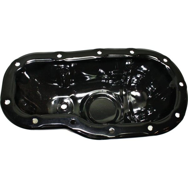

    I am also interested. Seems to be a common mod. Here are some photos from the net.
    Be aware that in addition to the Fumoto threads extending above the inside surface of the pan, the pan itself has reinforcement around the drain plug that will prevent full drains. Does not look like any meaningful amount of oil would remain in the pan. Here are some more photos from the net.

    I just replaced my lower oil pan this past weekend. The oil pan retains a good amount of oil anyway. So when I filled it back up with 5.5 qt, it was low a half a qt. It looks like our trucks hold 6 qts of oil total, but the engine plus the dip in the oil pan will hold about a half a quart.
    The amount that is blocked by the fumoto valve isn't even worth worrying about.
