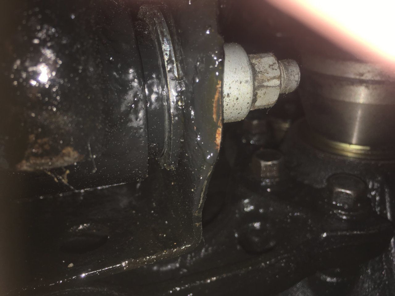

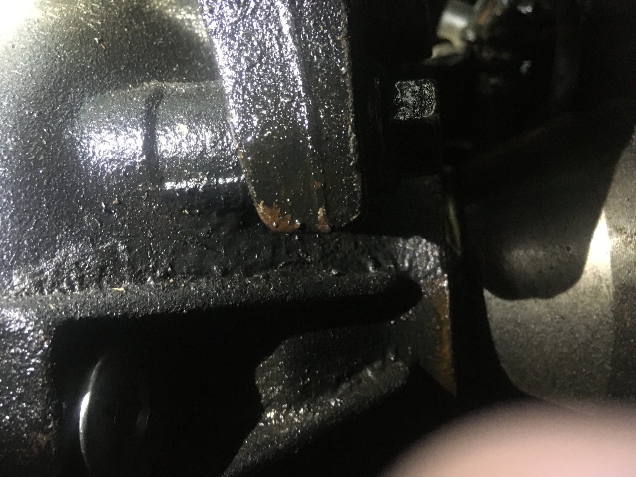

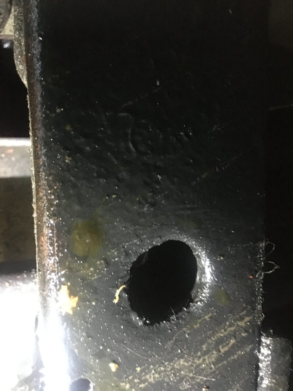

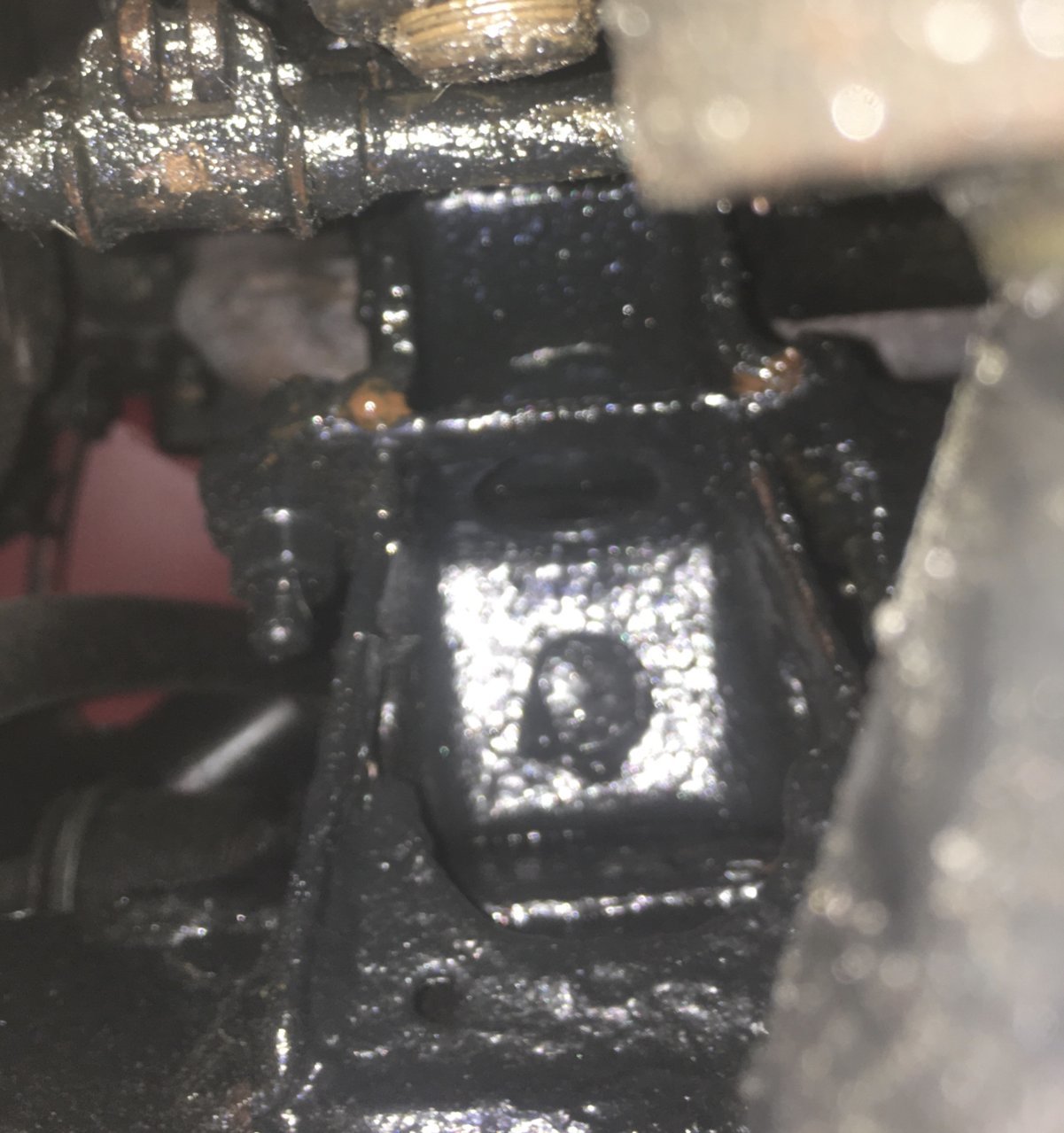

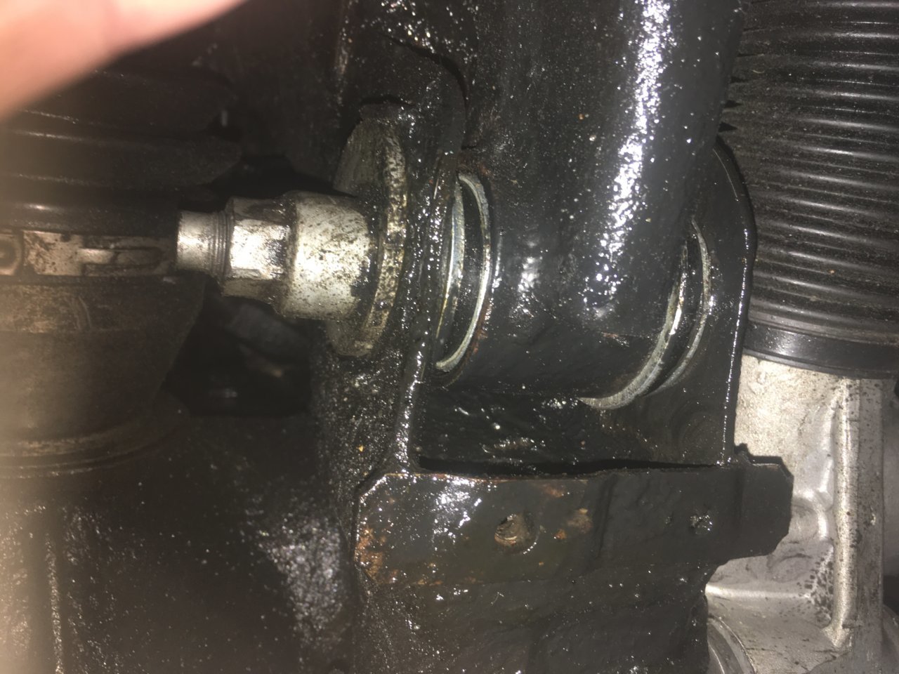

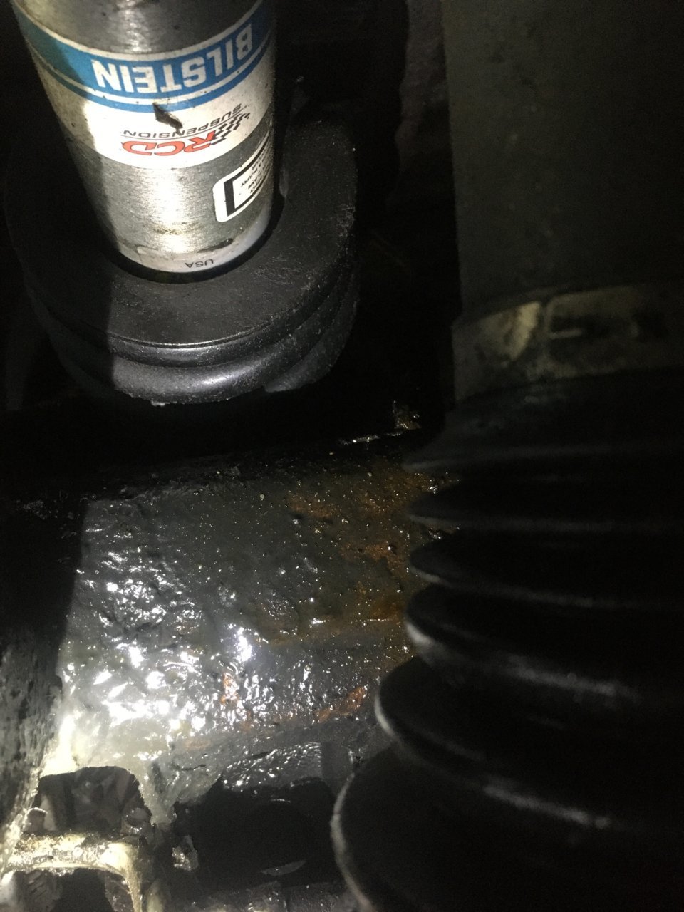

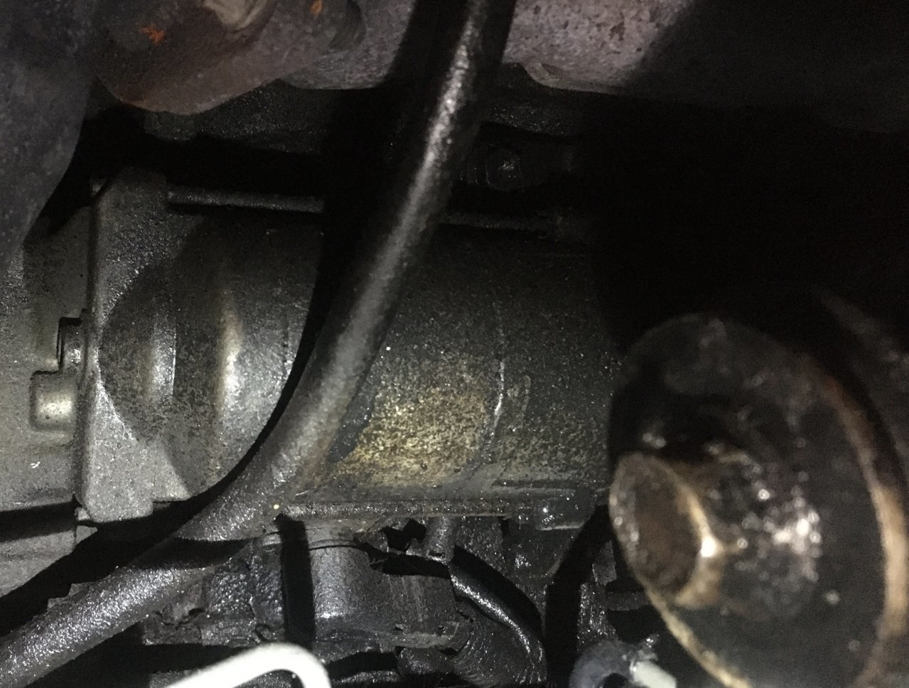

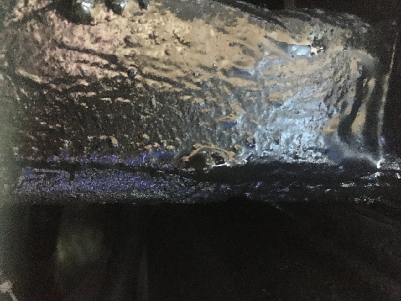

    I took some pics of the various places I am finding drips. They are on both left & right sides of the truck, so any pic works for either side. I can’t find anything around the vcg’s & my manifold vacuum test was a steady 21. The oil pan has some caked fresh-ish oil on the right side & rear. No drip type. Also, not much oil loss at all. I do think this has been going on a while. Just got backshelved & other stuff had been leaking on the floor, so I didn’t do a thorough investigation.
    I was going to clean everything up, but thought I’d take pics 1st & post.
    Oh, & when I park, it seems as if the three points where it ends up on the floor is the front & rear of the lca’s & the axles.
    This 1st one is a part I am not yet familiar with. It it probably the highest point with oil under it.
    Very front, right before bumper
    Motor mounts
    crossmember behind steering rack
    front dif brackets. It’s also on the underside of the front dif & axles.
    lca’s front & back
    Under the frame next to coilover housing

    Have you checked the valve cover bolts? I couldn't find an obvious leak spot either but i after i replaced the missing bolt AND cleaned ALL the oil off i haven't noticed any new residue.

    If the valve cover gaskets have never been done, it’s likely best to replace the gaskets, check valve clearance, clean it all up, and monitor. 90% of the “large” leaks on the 3.4 is from the valve cover gasket or the rear plug at the back of the head (which requires valve cover removal to replace)
    If you check them, the bolts will likely be loose and can slow down the leak. The rubber washers on the bolts compress over time leaving the bolts loose

    I wouldn't totally rule out a bad cv seal. It can throw fluid all over the place especially at highway speeds. I had that stuff everywhere too. unless your sure its motor oil

    could indeed be compounding leaks. but being the top of the starter is wet as well as the head under the exhaust manifold its likely more so valve cover gasket
    best course of action is degrease and watch it all

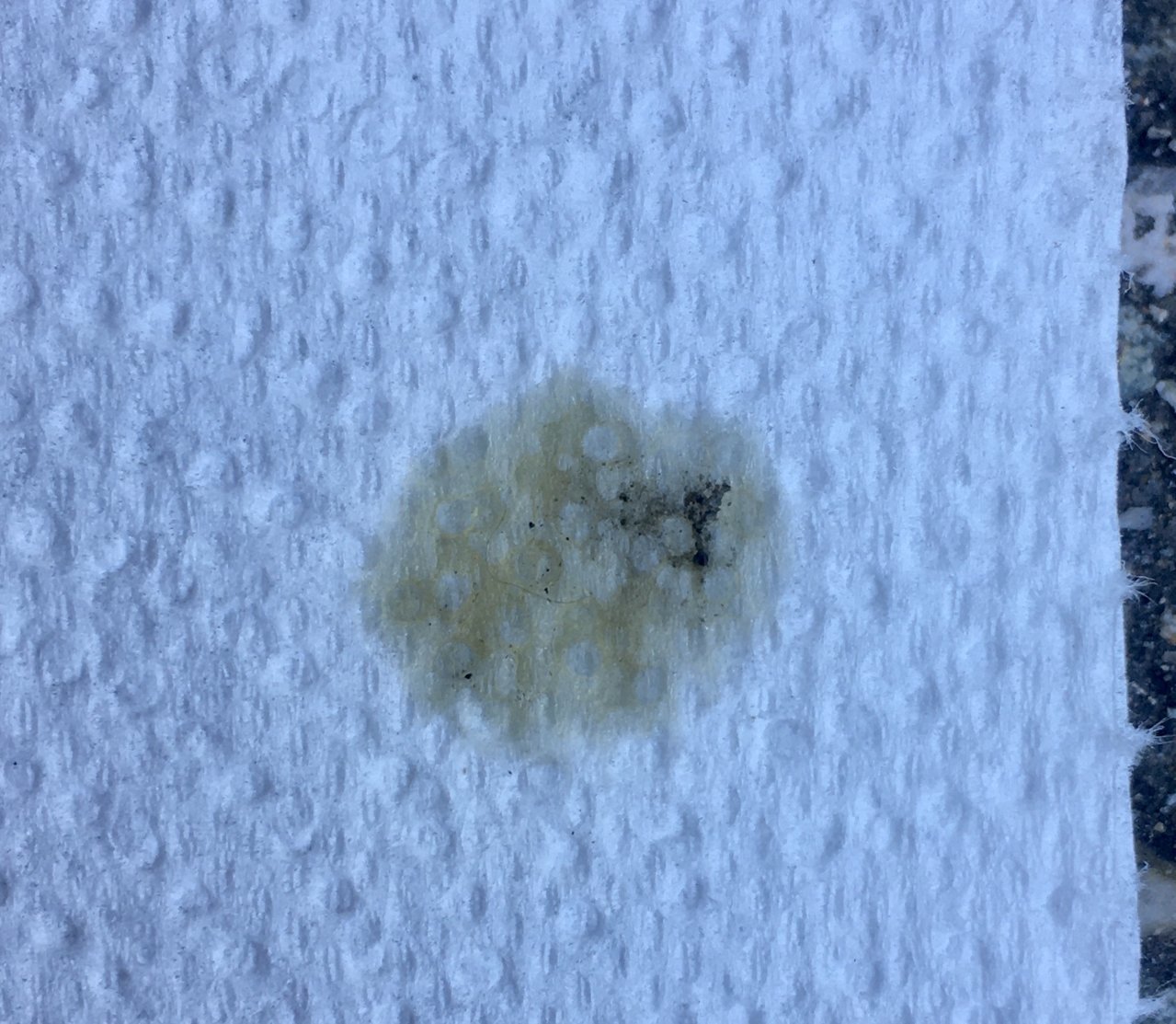

    That said, what I am noticing most is definitely motor oil. More of a bronze color as opposed to the yellow, I guess is how I'll describe it. & it's not dirty. Or rather, it matches the present state/color/texture of the oil on the dipstick.

    Might have multiple leaks, the front by bumper might be coolant if yours is greenish vs red. Looks quite substantial, is powersteering fluid low?

    nope. No red or green-ish. Definitely bronze-ish.

    Definitely been going on at least a month or two. With multiple spots it could be one leak higher up and the oil flows down different paths. If you can see a cleaner oil spot with fresh oil in the sludge, obviously that is the leak. Otherwise every idea is right, clean and observe

    Clean it up good, put some dye in your engine oil and get the black light and you'll see where all it's coming from,, it'll be a brilliant green.
    Also, is the PVC free and clear,, I was thinking something plugged and it's pressurizing the crankcase a little and pushing the oil out, just an idea to check.
