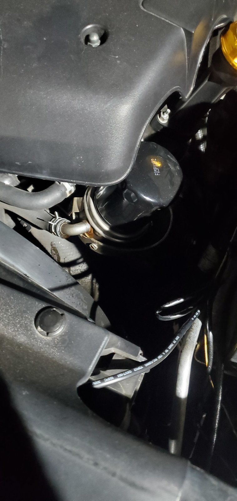

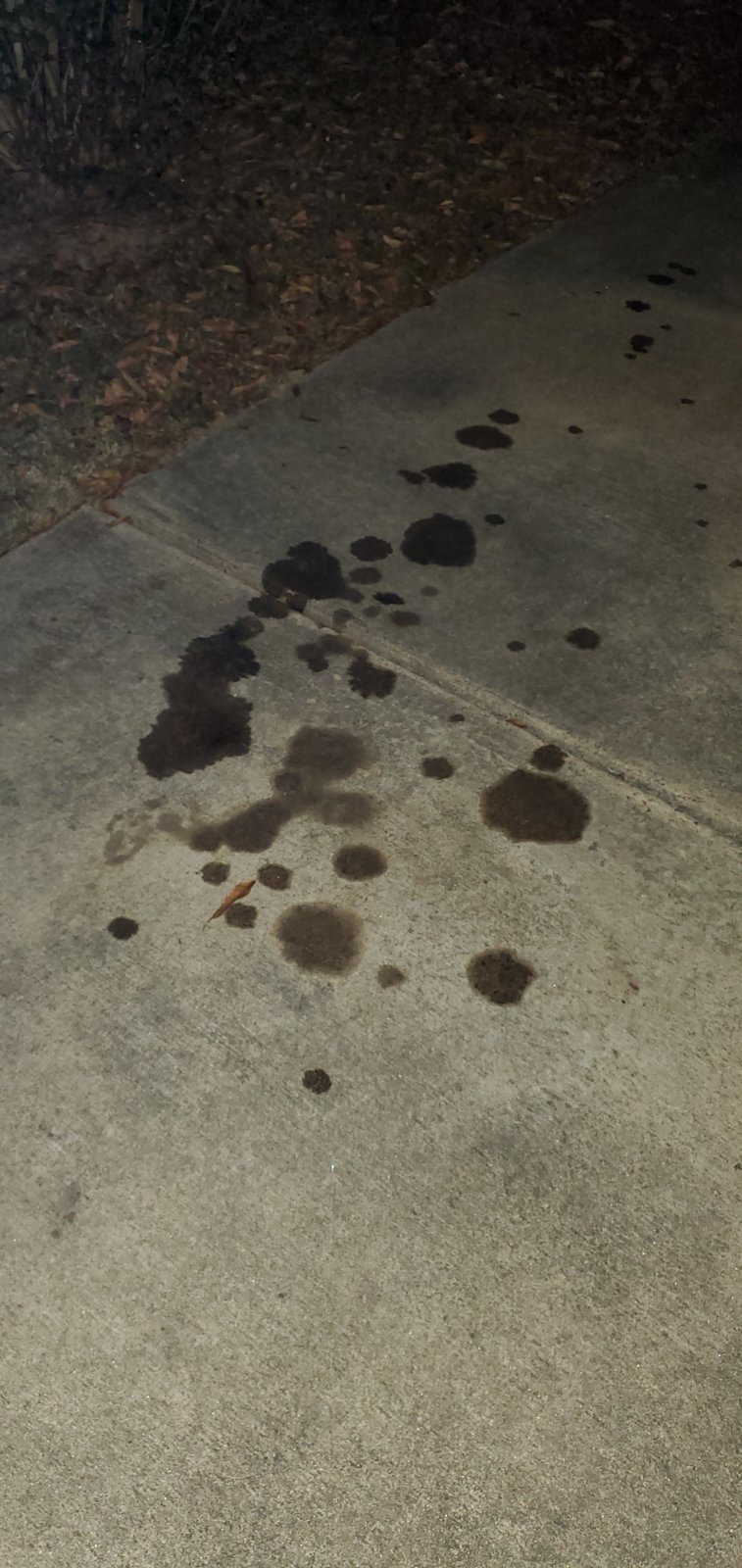

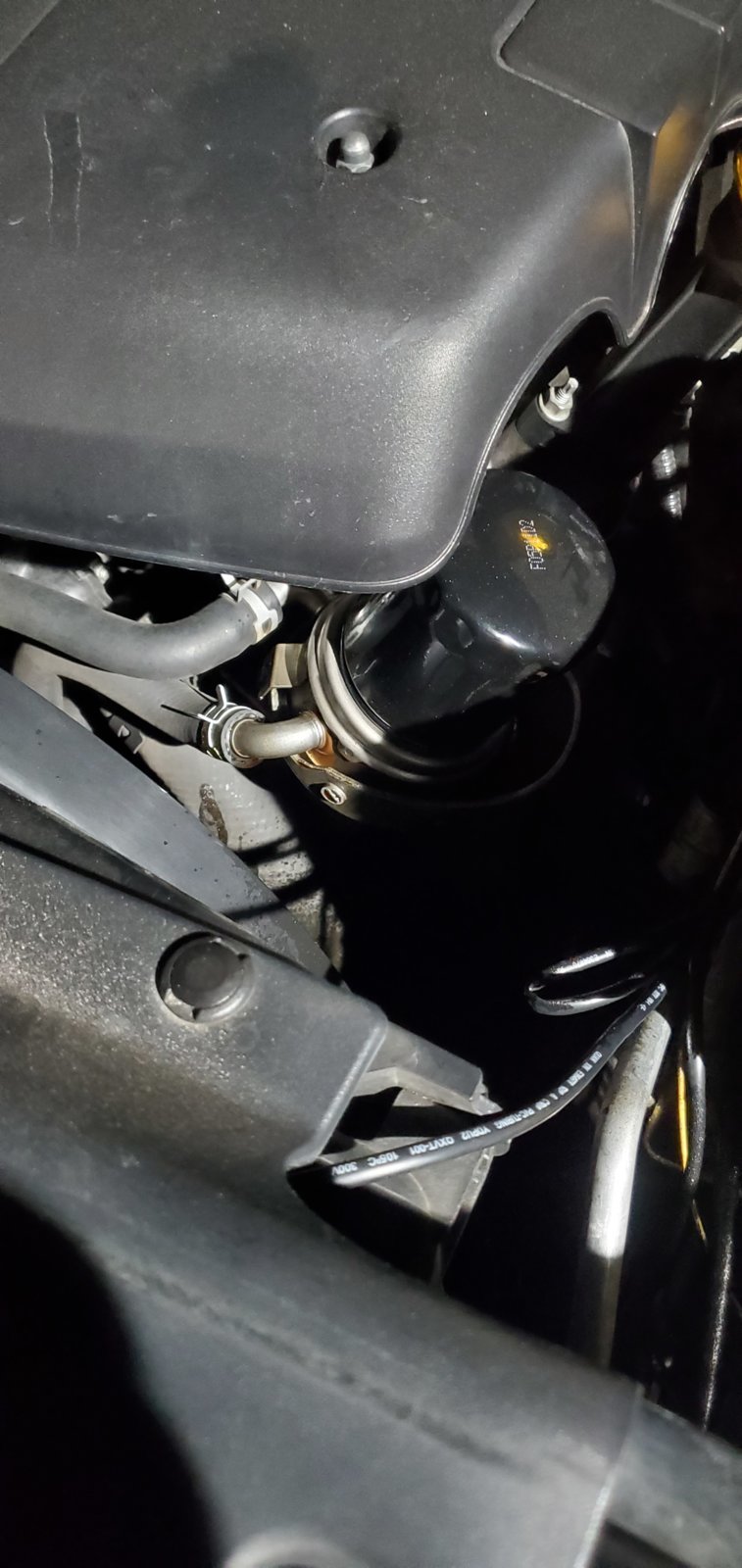

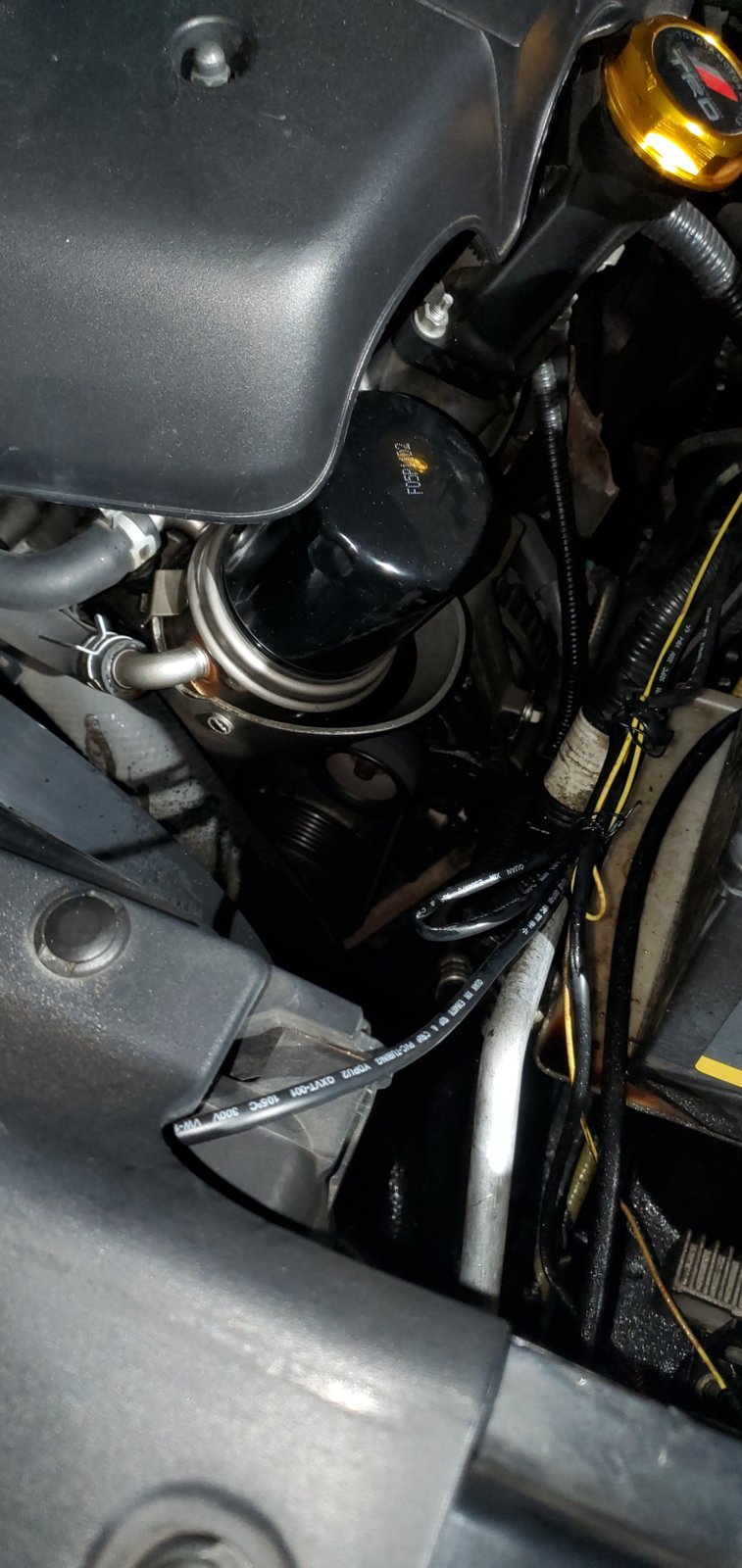

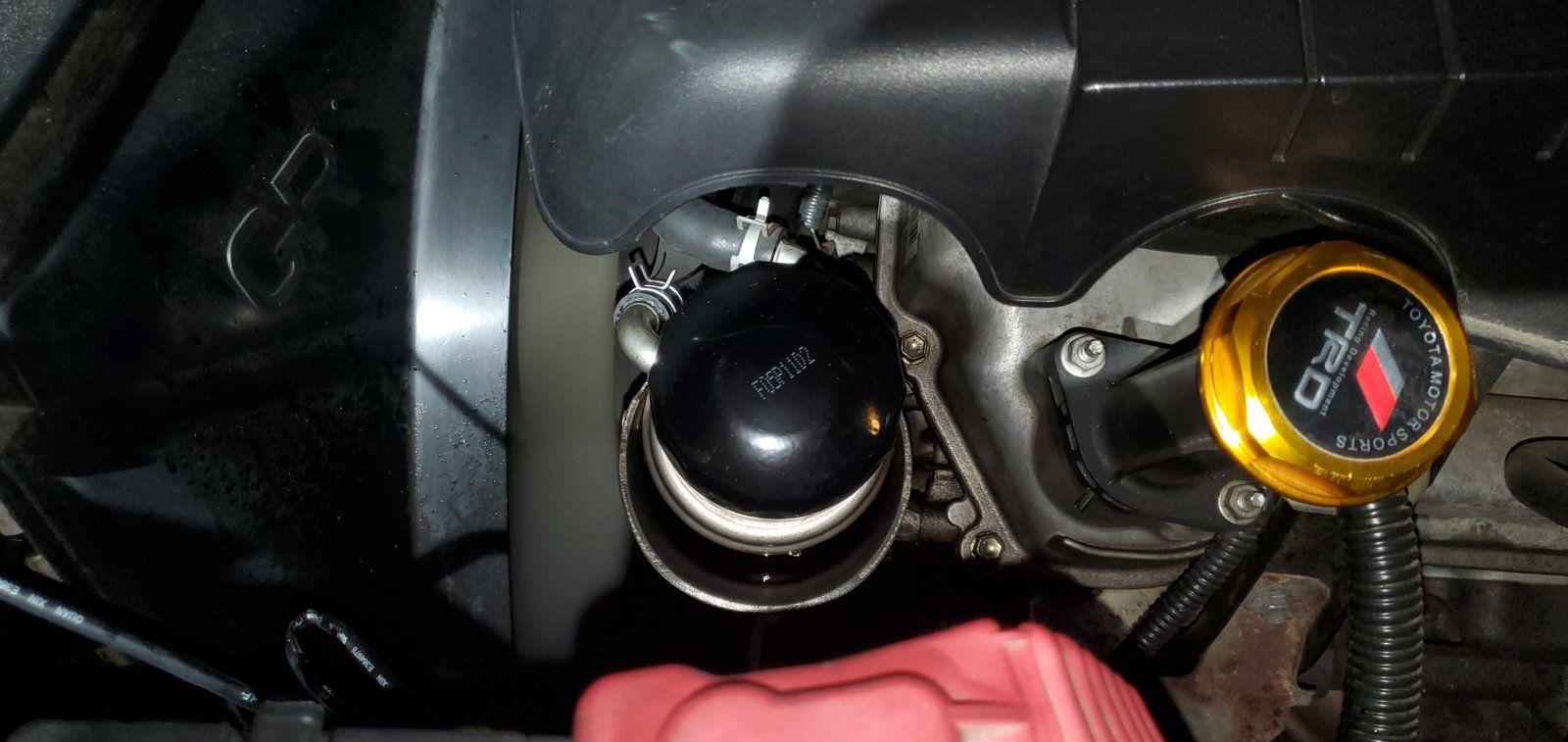

    Guys I need your help. About two weeks ago I was driving and noticed a burning rubber smell but I figured it was the car in front of me, so I dismissed it. Fast forward a week and I noticed some oil on my driveway so I popped the hood and lo and behold I have oil everywhere in the engine bay,needless to say I was pissed and frustrated because it's a damn taco, it shouldn't be leaking anywhere! I inspected a few things to make sure no hoses had holes anywhere and noticed oil in the filter cap holder thingy, is it possible that my oil filter croaked on me and need a new one, I have a manual and sometimes I take her out for a little "spirited driving" is it possible I may have blown a gasket maybe, I'm at a loss, need yalls expertise. Thanks in advance.

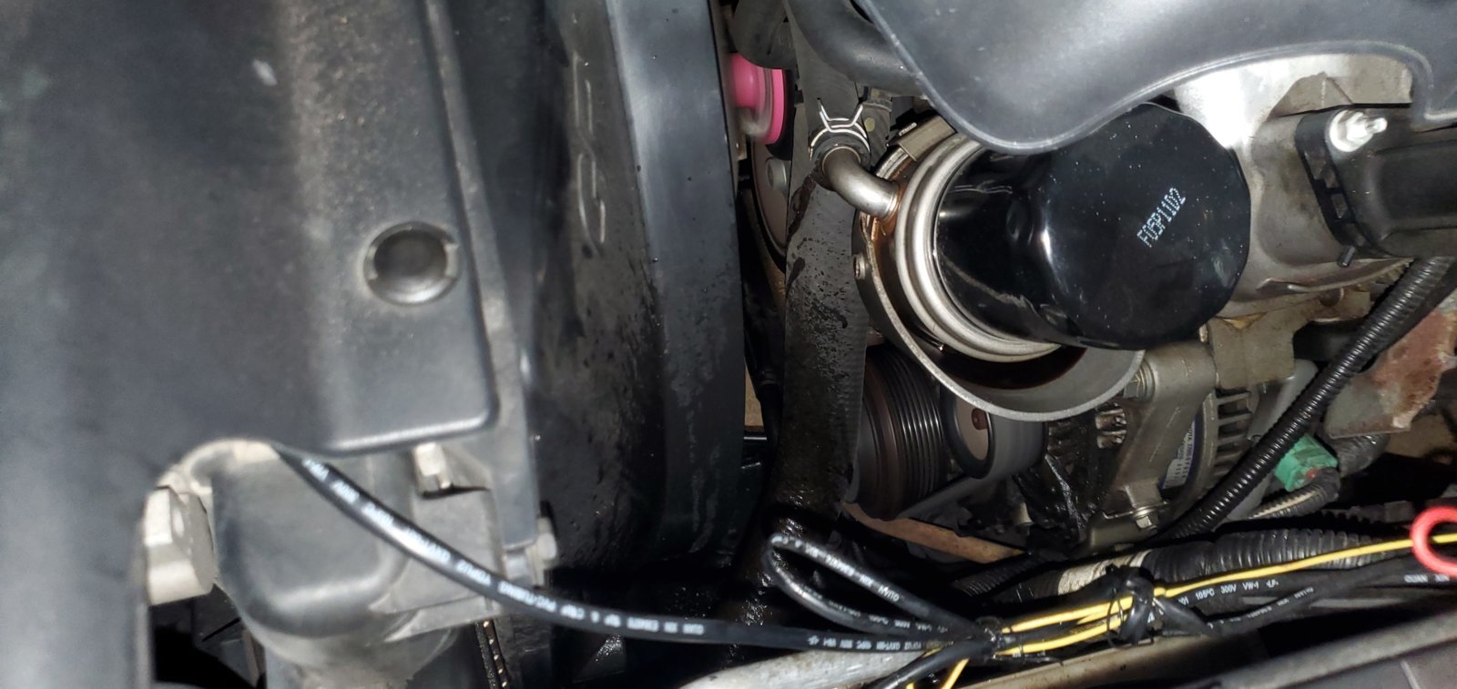

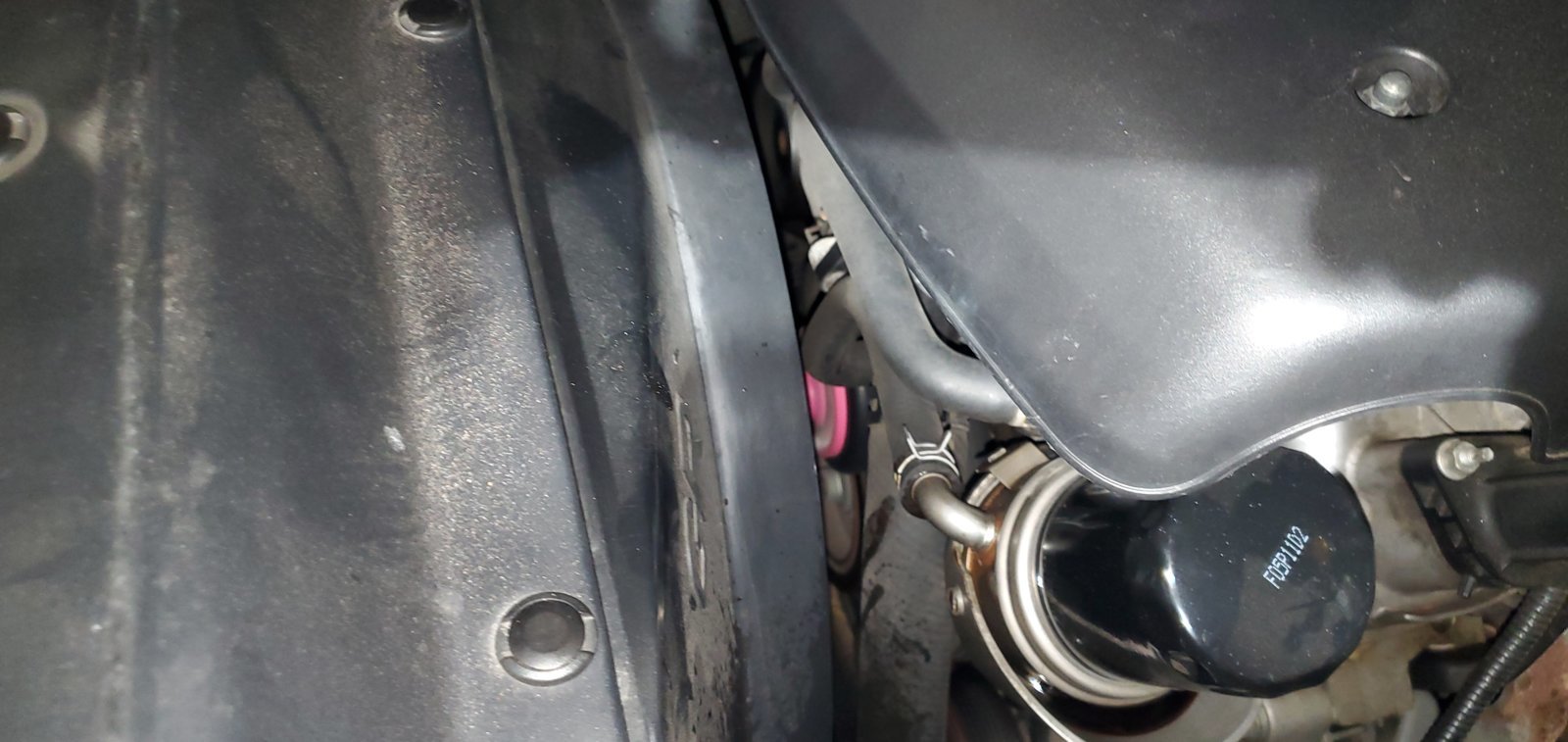

    from the pictures, I see oil in the filter catch thing, but to me it seems where the filter meets the housing is clean. Did you clean around the filter before taking these pics?

    No I didn't unfortunately

    who did your last oil change? Is it possible they didn't clean out the oil filter catch thing, and just recently maybe while you were driving some of that drainage sloshed around?

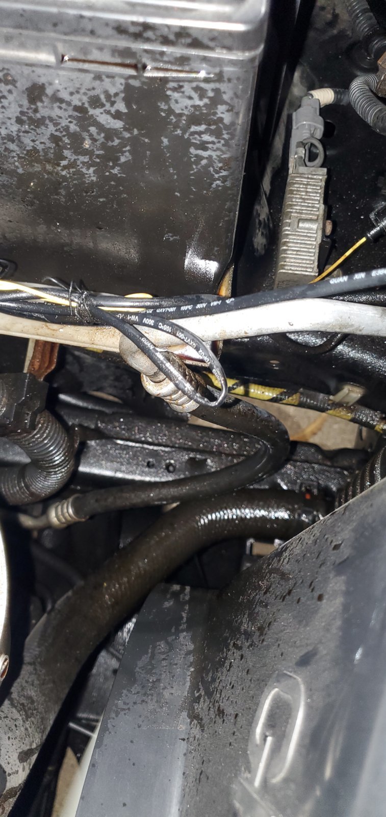

    How about P/S fluid level? Transmission fluid level?
    One of those pics looks like the leak is close to the radiator? There is oil cooler lines for both power steering and Transmission that go up to that area

    The second to last picture looks like the leak source is there somewhere but it’s hard to say.
    Put on some clothes you don’t care about, this is gonna get messy.
    Like kidthatsirish suggested, start it, look for the leak. If the fan looks oily, then it’s gonna fling all over as the leak gets on it.
    Brake cleaner or carb cleaner will clean the oil off.
