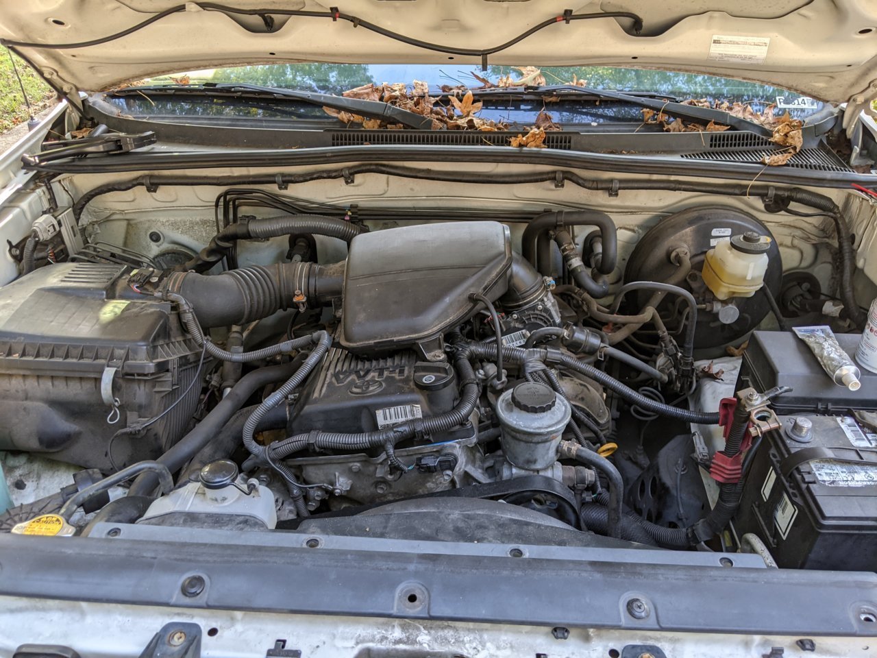

  16. Dec 7, 2023 at 12:47 PM
    #36
    Pyts
    Pyts Well-Known Member
    Aug 26, 2020
    #338854
    138
    09 2.7 RWD
    Stock
    A reasonably priced product you can use to safely degrease/oil your engine bay is simple green pro xd, which you can get at a big box store (home depot, ect.) I believe I got referred it via BITOG, though I'd been using regular simple green already for quite a few years when cleaning small motor carburetors. I only just got to try the pro xd version while doing the timing chain on our taco (in my thread "used tacoma, sludged engine").
    Dude, it worked. I mixed it with tap water in a pump spray bottle which conveniently had ratio marks on it for mixing cleaners. I think I went with 3:1 water to cleaner, and I just sprayed the whole bay and let it sit 10 or so minutes, hosed it off. Off with it came all the oil residue from old leaks. I felt like I was in a commercial.
    It wasn't like I went over everything with my trusty toothbrush, but it was as clean as I'd ever care to make an engine bay, and with no work besides a hot forearm from squeezing the bottle trigger for 15-20mins trying to get it EVERYWHERE.
    I'd recommend against using carb/brake cleaner. You can, and it works quick and even more easily, but I understand the solvents therein to be bad for plastic/rubber, so I really only do that if I'm pissed off at a lawn mower.

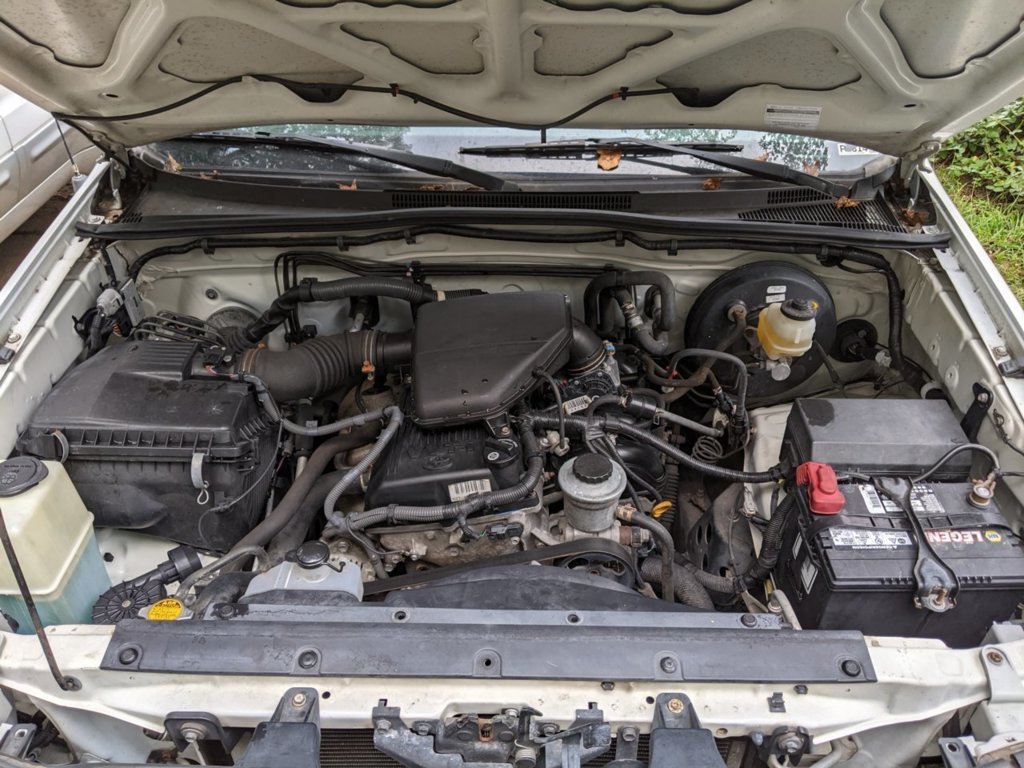

  19. Dec 7, 2023 at 3:02 PM
    #39
    Pyts
    Aug 26, 2020
    #338854
    138
    09 2.7 RWD
    Stock
    @Williston Your engine bay looks amazing! I'll have to see about rotating in some of your tricks for sure.
    Here's my before and after shots from my above post, spray and rinse. I can't stress enough how stoked I am on the results for the clear fluid reservoirs.
