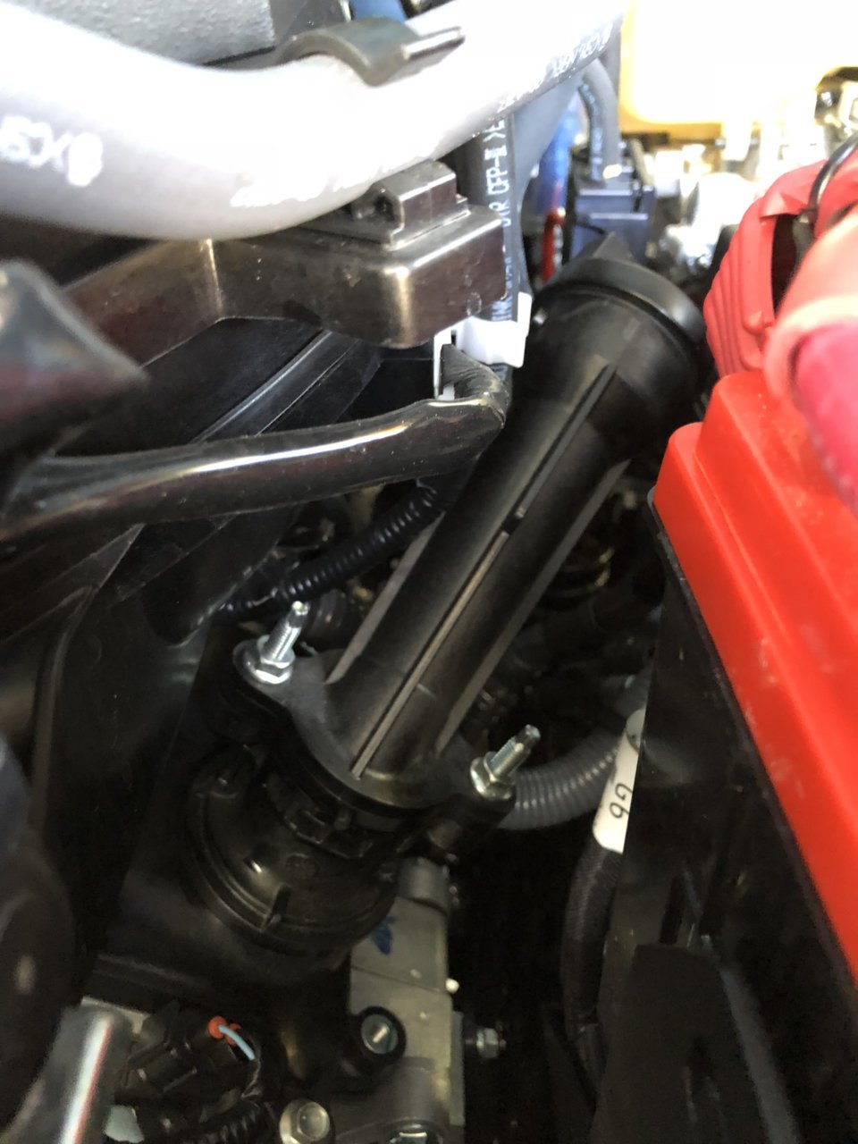

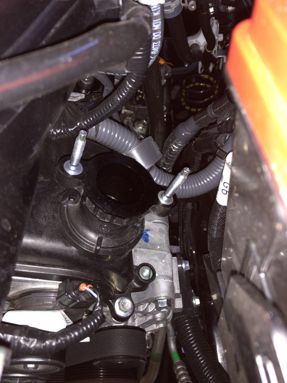

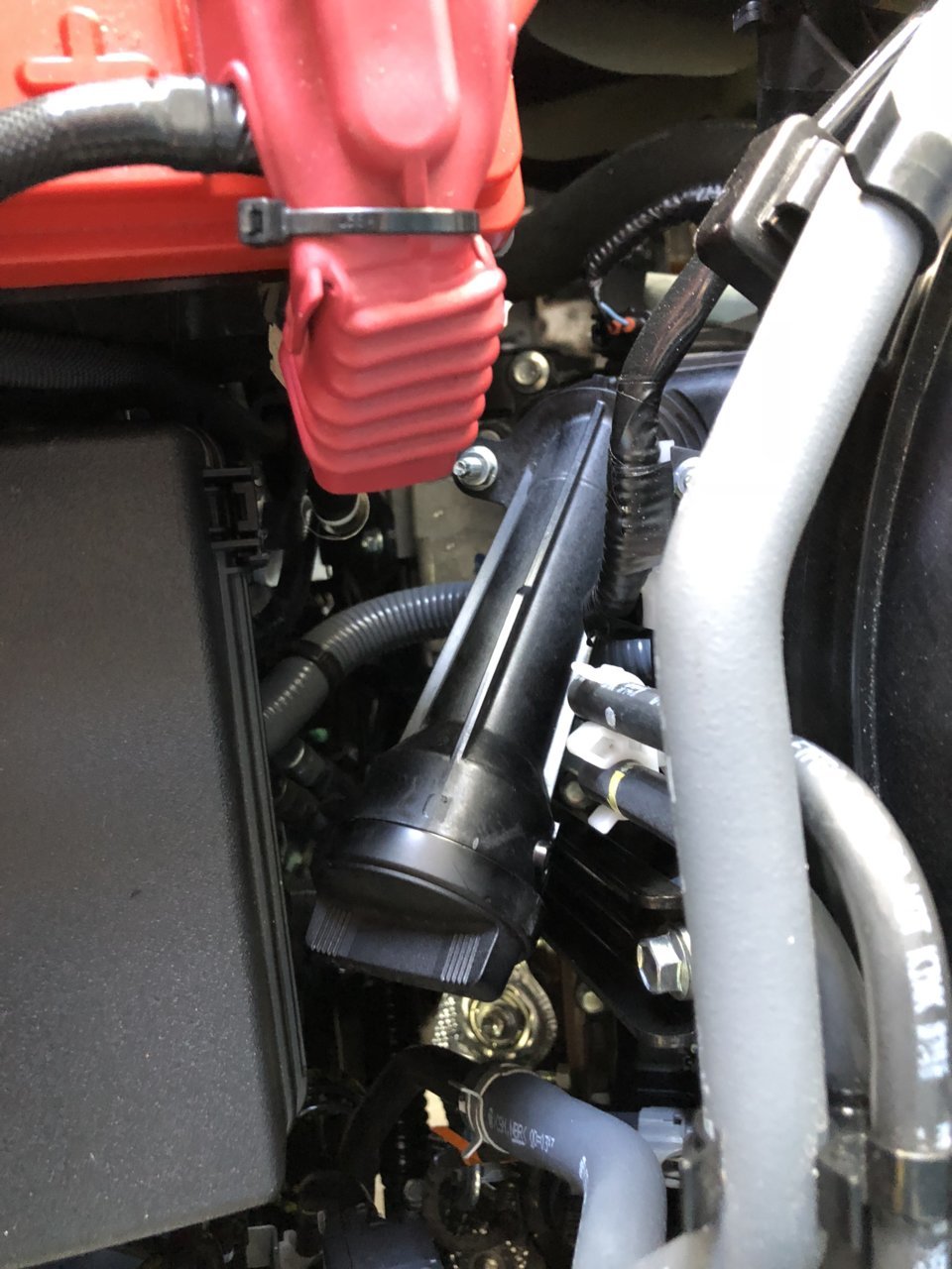

    So this is what I did and have had zero issues. I have a video of starting the engine to show how little it moves but cannot get it to upload.

    Nope. I just took the stock neck and turned 180°.
