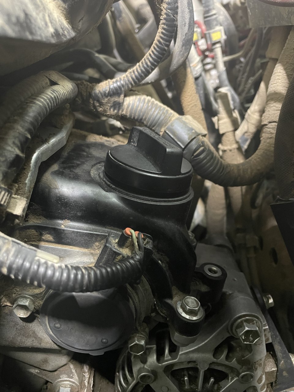

    Another angle.
  2. Nov 23, 2021 at 5:02 AM
    #102
    Jowett
    Jowett Well-Known Member
    May 5, 2016
    #186182
    1,635
    Brian
    North Adams, MA
    There should be no difference with bolts in place of the studs. Bolt it up, don't forget to trim the baffle at the bottom of the shorty (shown in post #60).

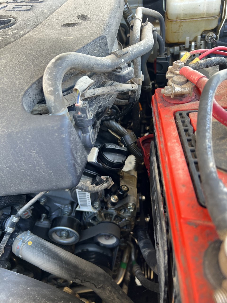

    How long have you gone with just using the oil cap directly in the valve cover?? My oil tube/neck recently snapped off after my trip through the Mojave Desert. (Suspecting my Dual Battery Tray smacked it a few times)
    Anyone have any video tutorials to walk me through properly removing whatever thread(s) is inserted in the valve cover hole and epoxying back a stubby neck?
    I had it towed home, immediately did an oil change, and it’s running fine, no leaks. I’m just concerned simply using the oil cap directly in the valve cover isn’t a permanent solution. (But I’d love it if it is!)

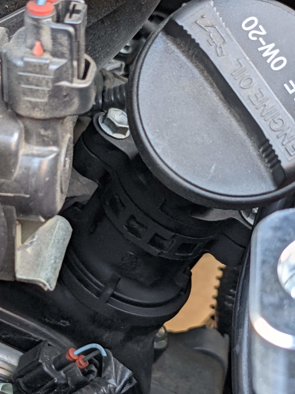

    I was chasing an oil leak that ended up being the filler neck from where it attaches to the valve cover . I twisted it off, surprisingly easy and went oil filler cap straight to valve cover . If your curious , yes it screws in. This is my captains log, day one . Cap straight to valve cover . I will further keep notes of my journey for fellow travelers.

    No issue, it my Dailey driver and I occasionally go wheeling . Hold tight and no leaks.

    I know this is an old thread, but, is the cap still holding up? I had mine break off on Sunday so I did a drain and refill and have gone with your solution. Hopefully I don't have to do anything else.

    still going strong, I’ve leavened to accept it . Never once have I decided to try and re glue the filler neck.
